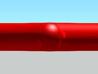

Hi(gh)!
With my current house project ("Port Whatmough Residential Area") I
encountered some strange artifacts when I tried to join two segments of
a roof railing (a straight and a curved one) with a sphere.
The curved segment follows a rounded 90° cutout of the ground floor
having a radius of 3.5 units; as the railing generally is spaced 0.1
units inwards from the roof's eged, the curved segment's (technically a
section of a torus) radius is 3.6 units, therefore it's angular size is
slightly less than 90° (see second attached image).
Although I've taken the resulting difference in the x direction (which
calculates as cos(atan(0.1/3.6))*3.6) relative to the eastern end of the
straight section into account, the spherical cornerpiece still does not
fit seamlessly.
Also, along both railing sections, strange dots like those resulting
from coincident surfaces are visible - but there is no concurrent
surface at all!
See you in Khyberspace!
Yadgar
Download '2011-09-30 port whatmough residential building #1, take 46 - extreme close-up of southern end of ground floor cutout rai' (16 KB) Download 'artifact_problem.jpg' (20 KB)
Preview of image '2011-09-30 port whatmough residential building #1, take 46 - extreme close-up of southern end of ground floor cutout rai'
Preview of image 'artifact_problem.jpg'
> surface at all!
What are you using for the railing sections ? spheresweep ?
hand made macro of sphere & cylinder ?

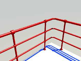

Attached is a view of another portion of the railing, showing how a
standard 90° corner is supposed to look like... the scene uses a basic
radiosity (just radiosity { } within the global_settings statement -
could it be that the artifacts are caused by that crude radiosity?)
which might improve with future versions.
Yadgar

From: Le Forgeron
Subject: Re: Strange Artifacts
Date: 30 Sep 2011 11:07:00
Message: <4e85db14@news.povray.org>
The old mechanic in me is asking: how the hell do you assemble that ?
There is no visible crew on the holding vertical poles.
The horizontal rail seems to be made of one piece.
And the vertical poles seems to be fixed directly in the cement.
For your cylinder/sphere/torus seams... the intersection of a torus is a
circle (which connect to a sphere of same radius) only for 3 well-known
cutting planes. All other intersections of a torus with a plane is a 3D
curve which does not match a circle.
For a point P on a torus:
there is the plane parallel to the plane of symmetry of the torus.
there is the plane perpendicular to the previous plane and passing at
the centre of the torus.
and there is the plane for the Villarceaux circles. (also going via the
centre of the torus, with a slant)
From: clipka
Date: 30 Sep 2011 14:21:50
Message: <4e8608be$1@news.povray.org>
Am 30.09.2011 11:47, schrieb Jörg 'Yadgar' Bleimann:
> Hi(gh)!
> fit seamlessly.
I think that should be:
     cos(asin(0.1/3.6))*3.6
   = sqrt(sqr(3.6)-sqr(0.1))
In addition, are you sure you cut the cylinder and torus properly?

If, as I now think, he used a translation of the clipping plane, the
answer is no. (a rotation should have been used)

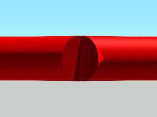

From: Jörg 'Yadgar' Bleimann
Date: 30 Sep 2011 17:38:36
Message: <4e8636dc@news.povray.org>
Hi(gh)!
With
<4.9+(3.6-sqrt(sqrt(3.6)-sqrt(0.1))), sh+rfh/(mr+1), 4.1>
as the sphere's coordinates rather than
<4.9+(3.6-cos(atan(0.1/3.6))*3.6), sh+rfh/(mr+1), 4.1>
the result is even worse - see attached image!
Yadgar
Download 'railing_corner.png' (19 KB)
Preview of image 'railing_corner.png'
From: clipka
Date: 30 Sep 2011 21:20:03
Message: <4e866ac3$1@news.povray.org>
Am 30.09.2011 23:38, schrieb Jörg 'Yadgar' Bleimann:
> Hi(gh)!
> With
Of course: You mixed up sqrt and sqr :-P
My bad though, because sqr doesn't exist as a predefined formula in
POV-Ray; so it should be:
   sqrt(3.6*3.6 - 0.1*0.1)

O.k.... with and without the spherical cornerpiece!
Yadgar
Download 'orthoview1.png' (66 KB) Download 'orthoview2.png' (65 KB)
Preview of image 'orthoview1.png'
Preview of image 'orthoview2.png'
From: clipka
Date: 2 Oct 2011 07:14:15
Message: <4e884787$1@news.povray.org>
Am 02.10.2011 12:45, schrieb Jörg 'Yadgar' Bleimann:
> cylinder
> <2.1+cp, sh+2*rfh/(mr+1), 4.1>, <4.9, sh+2*rfh/(mr+1), 4.1>, or
Note that this does /not/ coincide with the sphere's center. You need to
apply the small correction here as well to fix this...
> sphere
> // sqrt(sqr(3.6)-sqr(0.1))
> // <4.9+(3.6-cos(atan(0.1/3.6))*3.6), sh+rfh/(mr+1), 4.1>, or
> <4.9+(3.6-sqrt(pow(3.6, 2)-pow(0.1, 2))), sh+rfh/(mr+1), 4.1>, or
> texture { T_Red_Metal }
> difference // ground floor round cutout railing, lower rail
> torus
> 3.6, or
> box
> <0, -(or+df), -(3.6+or+df)>, <3.6+or+df, or+df, 3.6+or+df>
> box
> <-(3.6+or+df), -(or+2*df), -(3.6+or+2*df)>, <3.6+or+2*df, or+2*df, 0>
> rotate <0, degrees(atan(0.1/3.5)), 0>
... and here you're miscalculating the angle, using both the wrong
values (should be 0.1/3.6 rather than 0.1/3.5) and the wrong formula
(should be asin rather than atan).

Download 'railing_corner2.png' (25 KB)
Preview of image 'railing_corner2.png'
From: Solar Mike
Date: 2 Oct 2011 16:55:01
Message: <web.4e88ce8d2d6bb20470368d3d0@news.povray.org>
I think the problem here lies in the assumption the use of 0.1, 3.5 and 3.6 as
the basis for triangle with the center of the torus, the bend in the rail.
Keeping the radius and 0.1, your delta X is more like 3.5986.  I think you will
be fine if you follow clipka's suggestion but the change you are calculating
should be subtracted from 4.9.  Also, I tend to have better success with these
things when I declare local points or values and share that between the objects
like:
#local bendX = 8.5 - sqrt(pow(3.6, 2)-pow(0.1, 2));
or
#local pBend = <8.5 - sqrt(pow(3.6, 2)-pow(0.1, 2)), sh+2*rfh/(mr+1), 4.1>;
Cheers,
Mike

From: clipka
Date: 3 Oct 2011 21:55:54
Message: <4e8a67aa$1@news.povray.org>
Am 02.10.2011 22:43, schrieb Jörg 'Yadgar' Bleimann:
> After your suggested corrections, it looks almost perfect... but there
> are still those parallel rows of dots, just like there were
> coincindental surfaces!
For those I have no explanation so far. I'll probably need more code to
find out anything (camera, lights, global settings... the whole smash).

From: clipka
Date: 4 Oct 2011 07:50:46
Message: <4e8af316$1@news.povray.org>
Am 04.10.2011 12:53, schrieb Jörg 'Yadgar' Bleimann:
> Here it is, the whole smash:
The bad news for us is that this is indeed a bug. Apparently the math
for the torus is very susceptible to rounding errors when the camera is
inside a very thin torus, on (or very close to) the torus' "center
plane". (The cylindrical part of the railing seems to be affected only
because the torus, despite being cut away, still "projects" artifacts.)
The bug might be pretty similar in nature to the artifacts seen in
sphere sweeps.
The good news for you is that for obvious reasons these artifacts are
highly unlikely to show up in your final render.
Date: 4 Oct 2011 08:03:23
Message: <4e8af60b$1@news.povray.org>
Hi(gh)!
No, this is not really bad news - at least it does not show that even
after 15 years of poving, I still get messed up with trivial beginners'
mistakes...
Yes, very probably not... and in animations, these dots would be almost
surely lost in compression!
Yadgar
