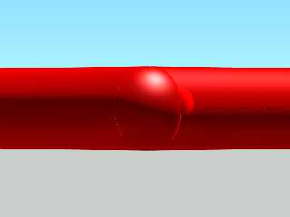

Hi(gh)!
With my current house project ("Port Whatmough Residential Area") I
encountered some strange artifacts when I tried to join two segments of
a roof railing (a straight and a curved one) with a sphere.
having a radius of 3.5 units; as the railing generally is spaced 0.1
units inwards from the roof's eged, the curved segment's (technically a
section of a torus) radius is 3.6 units, therefore it's angular size is
Although I've taken the resulting difference in the x direction (which
calculates as cos(atan(0.1/3.6))*3.6) relative to the eastern end of the
straight section into account, the spherical cornerpiece still does not
fit seamlessly.
Also, along both railing sections, strange dots like those resulting
from coincident surfaces are visible - but there is no concurrent
surface at all!
See you in Khyberspace!
Yadgar
Download '2011-09-30 port whatmough residential building #1, take 46 - extreme close-up of southern end of ground floor cutout rai' (16 KB) Download 'artifact_problem.jpg' (20 KB)
Preview of image '2011-09-30 port whatmough residential building #1, take 46 - extreme close-up of southern end of ground floor cutout rai'
Preview of image 'artifact_problem.jpg'
From: Le Forgeron
Subject: Re: Strange Artifacts
Date: 30 Sep 2011 07:20:50
Message: <4e85a612@news.povray.org>

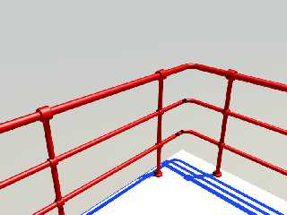

From: Jörg 'Yadgar' Bleimann
Date: 30 Sep 2011 07:57:08
Message: <4e85ae94@news.povray.org>
Hi(gh)!
On 30.09.2011 13:20, Le_Forgeron wrote:
> What are you using for the railing sections ? spheresweep ?
> hand made macro of sphere&  cylinder ?
Just cylinders and (sections of) tori (spheres only where cylinders
directly meet tori sections)... currently simply placed explicitly,
later on I would like to program a macro to make my railing concept
universally reusable (yes, also for the whole PoV-Ray community - I will
place the macro in the povray.org object library)!
Attached is a view of another portion of the railing, showing how a
radiosity (just radiosity { } within the global_settings statement -
could it be that the artifacts are caused by that crude radiosity?)
which might improve with future versions.
Yadgar
Download '2011-09-30 port whatmough residential building #1, take 48 - northwestern corner of ground floor roof.jpg' (52 KB)
Preview of image '2011-09-30 port whatmough residential building #1, take 48 - northwestern corner of ground floor roof.jpg'
From: Le Forgeron
Date: 30 Sep 2011 11:07:00
Message: <4e85db14@news.povray.org>
> standard 90° corner is supposed to look like...
The old mechanic in me is asking: how the hell do you assemble that ?
There is no visible crew on the holding vertical poles.
The horizontal rail seems to be made of one piece.
And the vertical poles seems to be fixed directly in the cement.
For your cylinder/sphere/torus seams... the intersection of a torus is a
circle (which connect to a sphere of same radius) only for 3 well-known
cutting planes. All other intersections of a torus with a plane is a 3D
curve which does not match a circle.
For a point P on a torus:
there is the plane parallel to the plane of symmetry of the torus.
there is the plane perpendicular to the previous plane and passing at
the centre of the torus.
and there is the plane for the Villarceaux circles. (also going via the
centre of the torus, with a slant)

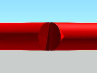

Date: 30 Sep 2011 17:38:36
Message: <4e8636dc@news.povray.org>
Hi(gh)!
> I think that should be:
> cos(asin(0.1/3.6))*3.6
> = sqrt(sqr(3.6)-sqr(0.1))
With
<4.9+(3.6-sqrt(sqrt(3.6)-sqrt(0.1))), sh+rfh/(mr+1), 4.1>
as the sphere's coordinates rather than
<4.9+(3.6-cos(atan(0.1/3.6))*3.6), sh+rfh/(mr+1), 4.1>
the result is even worse - see attached image!
Yadgar
Download 'railing_corner.png' (19 KB)
Preview of image 'railing_corner.png'
From: clipka
Date: 30 Sep 2011 21:20:03
Message: <4e866ac3$1@news.povray.org>
> Hi(gh)!
> With
Of course: You mixed up sqrt and sqr :-P
My bad though, because sqr doesn't exist as a predefined formula in
POV-Ray; so it should be:
   sqrt(3.6*3.6 - 0.1*0.1)

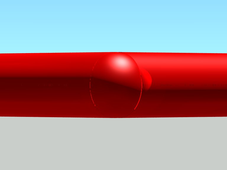

Date: 1 Oct 2011 13:26:28
Message: <4e874d44@news.povray.org>
Hi(gh)!
Am 01.10.2011 03:19, schrieb clipka:
Now the result is the same like with my original version (see attachment)...
Yadgar
Download 'whatmough_residential.png' (29 KB)
Preview of image 'whatmough_residential.png'
