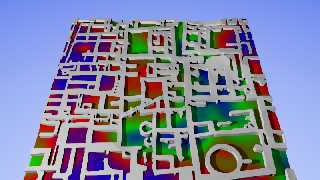

The attached image is the render of a prism object (linear_sweep
bezier_spline) generated by Inkscape from an image.
My question is if it would be possible, and if yes how, to drape this
prism over a (gently) undulating height_field? The vertical component
should remain vertical of course as they represent (foundation) walls.
Download 'inkscape_mohenjodaro_test.png' (219 KB)

From: Bill Pragnell
Subject: Re: Prism over a height_field?
Date: 28 Jul 2011 04:25:00
Message: <web.4e311ca618d248626dd25f0b0@news.povray.org>
Extend the prism in y, and intersect with a copy of the heighfield offset in y?

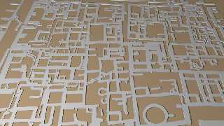

Date: 28 Jul 2011 05:03:16
Message: <4e3125d4@news.povray.org>
Yes indeed! That seems to do the trick. Here a small test image.
Thanks again!
Download 'inkscape_mohenjodaro_test.png' (237 KB)
Preview of image 'inkscape_mohenjodaro_test.png'
From: Bill Pragnell
Date: 28 Jul 2011 05:25:00
Message: <web.4e312a2f18d248626dd25f0b0@news.povray.org>
Are you sure you used the heightfield correctly? In some areas, the walls seem
deeper than in others. Or is that deliberate? :)
Date: 28 Jul 2011 07:16:41
Message: <4e314519@news.povray.org>
Not deliberate, but indeed a need for better coordination of the
parameters :-) On the other hand, it can be used for some height variations.
This image shows a better construction.
Download 'inkscape_mohenjodaro_test.png' (316 KB)

From: Christian Froeschlin
Date: 30 Jul 2011 21:07:07
Message: <4e34aabb@news.povray.org>
If you exported the drawing as image instead of contour you could
use it as height_field with varying heights coded in color (but maybe
not enough resolution for your large city). You could then add your
terrain height image to make it follow the terrain.
Date: 31 Jul 2011 02:50:39
Message: <4e34fb3f@news.povray.org>
Yes, that is correct. I have used that technique in the past. The reason
I switched to prisms is that - in my experience - the height_fields
generated from the image were not crisp enough to simulate buildings. At
a distance that might not be too problematic, but I am afraid that even
at the middle distance it would be perturbing the view. Still, I think I
should return to the technique and see were it brings me. Thanks for
reminding me of this.
I am now working with prisms on a part of the city now, as a first
approach, and it looks promising. I shall come back with that later
today probably.
A drawback of prisms is that in the end render time will increase. If I
had a way to go from prisms to meshes.... :-)
