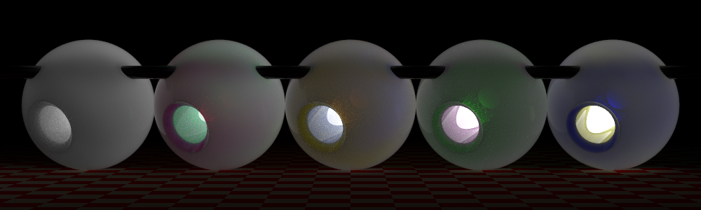

Yet another SSLT test render. This is a radiosity-only-lit scene.
(And again I had to fix a few more SSLT issues to get this scene to
render properly... *sigh*... still a long way to go I guess.)
Download 'translucency_test.png' (217 KB)
Preview of image 'translucency_test.png'

Question regarding the Translucency specificer, does this replace, or
simply augment the current (As of RC3) style? Sometimes its nice to be
able to tweak both the scattering and the absorbing coefficients.

The old (RC3) syntax is gone. But you can still achieve the same results
via tweaking of the pigment and translucency - they're just a more
indirect (yet usually much easier) way of specifying the coefficients.
