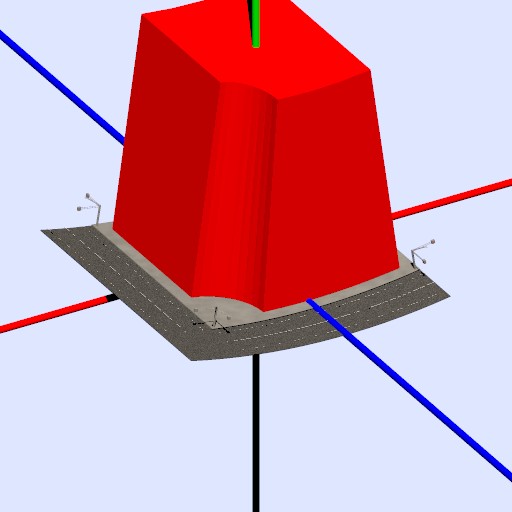

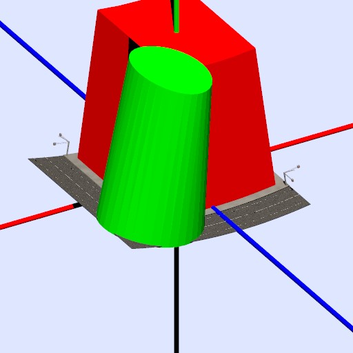

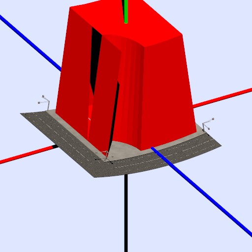

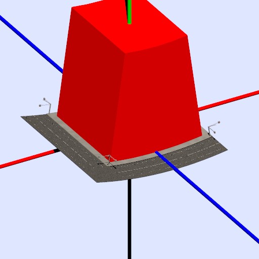

When I intersect two solid meshes I get weird artifacts, as can be seen
in the following images. The red object is the main object, the green
object is the one I'm trying to subtract. The artifacts aren't _always"
there. Sometimes they disappear when the radius of the green object
changes. Any clue why this is happening?

What's your inside_vector? Does it happen to be pointing along the blue
line (whatever axis that may be)? If so, try changing that to something
pretty random.

POV-Ray's implementation of intersection and difference CSG uses two
operations: Computing intersections between a ray and the member
objects, and testing whether such an intersection point is inside the
other member objects.
For most object types, the inside-test is defined via a mathematical
formula (for instance, for a sphere you just test whether the distance
between the point in question and the center is smaller than the
sphere's radius). For meshes, this is not so easy; so instead, POV-Ray
shoots a "random" test ray from the point in question and tests how many
times it intersects the mesh: If the number of intersections is odd, the
point must be inside, otherwise outside.
inside_vector specifies the "random" direction in which to shoot that
test ray. Theoretically the direction should not matter, but in rare
cases this algorithm might lead to artifacts - which then can be made to
disappear by choosing a different test ray direction.
An inside_vector of <0,0,0> is equivalent to specifying no inside_vector
at all, i.e. leaving the mesh non-solid.
From: SharkD

There is no "right" value, and no "wrong" one either except for <0,0,0>
- any non-zero vector will usually do. I often use "y", but you can just
as well use "x", "z", "<1,1,1>", "<42,23,4711>",
"<sqrt(13),log(77),sin(0.2)>" or... well, maybe you get the idea.
The only situation when the actual value of this vector may make a
difference is when you get artifacts - in that case choosing some other
value may help.
Looks like a problem with the orientation of the inside vector.
Try changing it a little.
If it's value is <0,1,0>, change it to something like <0.0001,1,0>.
