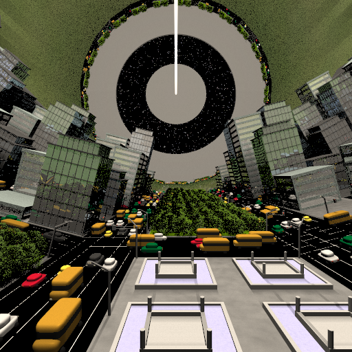

From: SharkD
Subject: Re: "Spinner" space colony (2)
Date: 7 Jun 2010 16:58:15
Message: <4c0d5d67$1@news.povray.org>
On 6/7/2010 2:22 PM, Alain wrote:
> If they want a "night", they should do it by turning off the central
> glowing beam, or dim it down.
Good idea.
I uploaded a new render (same URL). I'm still having problems with the
scene looking "artificial", or like a miniature model. I can't quite put
my finger on it.
http://isometricland.com
Date: 9 Jun 2010 14:39:13
Message: <4c0fdfd1$1@news.povray.org>
> Good idea.
> my finger on it.
All those cars and the streets don't help. I'd expect a comunal
transport system, part on grount, part suspended, to accomodate the
cityzens transportation.
I still have a dificulty with your clouds and "blue sky". If there are
some clouds, they would tend to gather into a cylinder around the center
beam, but never touching it.
Any blueish area due to the athmospheric scattering would be in the
direction of the central beam relative to the observer. Now, it's about
120° from where it should be.
The location IS artificial by definition. You may add some light fog, it
may help to give a sense of scale.
You may try puting the camera on the roof of a building or at street level.

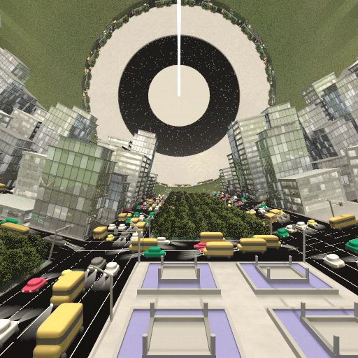

From: SharkD
Date: 9 Jun 2010 19:56:38
Message: <4c102a36@news.povray.org>
I adjusted all the pigments to compensate for assumed_gamma. The scene
is no longer as washed-out and bright.
Another problem I haven't fixed yet are the streets. For some reason
they show up as black when they instead should be gray. I don't know
why. I thought I fixed all coincident/overlapping surfaces.
Download 'gh_scene_spinner_cubemap_i.png' (406 KB)
Preview of image 'gh_scene_spinner_cubemap_i.png'
Date: 10 Jun 2010 03:28:29
Message: <4c10941d$1@news.povray.org>
Better indeed.
From looking at the buildings, I feel that the cylinder should have a much
larger radius. People will get claustrophobic here, with the impression that
the buildings are falling on their heads. :-)
I think that the sense of scale would be improved with a better balance
between cylinder dimensions and building dimensions. I suggest a larger
cylinder and (much more) scaled-down buildings/living space. Add some
atmospheric media or a subtle fog for suggesting distance and you will get a
much more believable scene.
This one is ok, if a little dark. The previous one was not washed out,
at least on my screen. In fact, it was much more contrasted.
I see a major problem: the ground should curves along the cylinder, now,
it's faceted.
Again, I maintain that planet's ground city like streets and the
presence of cars is just plain wrong in that kind of environment.
You use boxes for the buildings, it may be beter to use prisms; at least
for the taler ones, over 5 stories high, and have those buildings taper
as they go up. Low buildings, 1 to 4 stories, can probably do with
simple boxes.

From: SharkD
Date: 10 Jun 2010 20:20:35
Message: <4c118153@news.povray.org>
Made the buildings larger, the roads narrower.
Download 'gh_scene_spinner_cubemap_k.png' (439 KB)
Preview of image 'gh_scene_spinner_cubemap_k.png'
Date: 11 Jun 2010 03:40:58
Message: <4c11e88a$1@news.povray.org>
"SharkD" <pos### [at] gmailcom> schreef in bericht
news:4c118153@news.povray.org...
Hmmm.... yes and no. The sense of scale is starting to come nicely but the
ground should be curved around the cylinder and not faceted, with the
buildings abruptly at an angle above the pedwalks, and the park as a
completely flat area in front of us. I think cars would have difficulty in
maneuvering across the obvious angles in the roads while driving
cross-cylinder. :-)
It would do as a cartoonesk scene I guess but not as the more realistic one
here.
Date: 11 Jun 2010 13:23:13
Message: <4c127101@news.povray.org>
I realy like your new end cap. I also like that you now have more
vegetation space.
But:
Why is the ground faceted and not smoothly curving?
Still to many road vehicles. The ONLY vehicles should be utility and
public transportation, and positively NO personal ones.
On a space station, any space station, even an imensly huge one,
resources are inherently scarce. Living space, parks space, working
space, cargo space, air, water, raw and rafined materials, energy,
everything is counted and counts. Personal cars are a waste of

From: SharkD
Date: 12 Jun 2010 03:15:15
Message: <4c133403@news.povray.org>
Two new renders. One from last night showing the atmosphere and rounded
portal to outside. And one from just a few minutes ago showing the
curved (as well as some new) buildings.
Download 'gh_scene_spinner_cubemap_l.png' (831 KB) Download 'gh_scene_buildingstrip_curve_c.png' (186 KB)
Preview of image 'gh_scene_spinner_cubemap_l.png'
Preview of image 'gh_scene_buildingstrip_curve_c.png'
From: Stephen
Date: 12 Jun 2010 03:30:44
Message: <4c1337a4$1@news.povray.org>
Looking better :-D
From: SharkD
Date: 14 Jun 2010 02:18:28
Message: <4c15c9b4@news.povray.org>
Another render showing another new building type and a variety of other
objects.
Download 'gh_scene_buildingstrip_curve_d.png' (322 KB)
Preview of image 'gh_scene_buildingstrip_curve_d.png'
Date: 14 Jun 2010 03:20:51
Message: <4c15d853$1@news.povray.org>
news:4c15c9b4@news.povray.org...
> objects.
This is looking really good!

Yeah, clipka's advice on compensating for gamma really helped a bunch!
