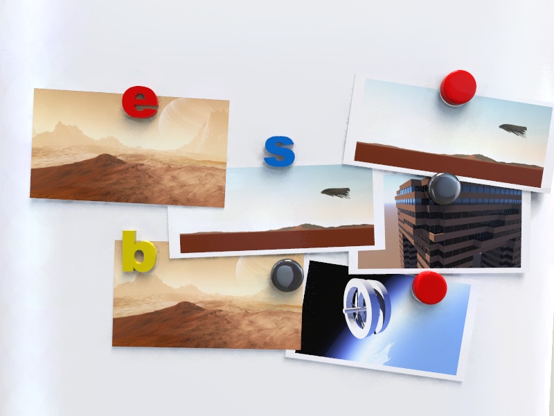

Some postcards from across the universe!
Obviously I don't have enough images yet, so I've duplicated some, but I
thought people might be interested in what I'm working on :)
BTW, I know this sounds like a newbie question but: has anyone got a nice
way to round or bevel the edges on those letters?
For my purposes it would suffice to have a mesh of a nicely rounded font,
but ideally i'd like an all-pov solution which could handle strings of text.
The only option I can think of is to intersect sheared version of the text
object to get a bevel... in fact that would work quite well! I'll do that if
nobody has a better solution!
Comments/criticism appreciated :)
Tek

Oh just typical, not only did I forget to attach the picture but Outlook Express
has somehow lost all trace of the message. So I'm posting this via the web
interface. Grr...
Download 'stella.jpg' (98 KB)
Preview of image 'stella.jpg'

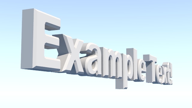

Typically, I answered my own question! Here's a simple macro I just bashed
together:
#macro BevelledText( Font, Text, Thickness, AlignH, AlignV, Bevel )
 #local Obj = text { ttf Font Text Thickness, 0 #if ( AlignH )
h_align_center #end #if ( AlignV ) v_align_center #end }
 union {
  object { Obj clipped_by { plane { -z, -Bevel } } }
  intersection {
   #local a=0; #while ( a < 360 )
    object { Obj translate -Bevel*z Shear_Trans(x,y,vrotate(z+x,z*a))
translate z*Bevel }
   #local a=a+45;#end
   //plane { -z, 0 }
   clipped_by { plane { z, Bevel } }
  bounded_by { object { Obj } }
#end
It's not perfect (you can see some glitches in the concave corners) so if
anyone has a better solution I'd like to know :)
Tek
http://evilsuperbrain.com
Download 'bevelled.jpg' (32 KB)
Preview of image 'bevelled.jpg'

Sounds silly but have you googled “rounded fonts”?
http://www.urbanfonts.com/fonts/rounded-fonts.htm
Nice idea :-D

Have you tried a height_field of a blurred image of the letter(s)?

I mean rounded in the third dimension, not in the 2 dimensions of the font
itself.
And googling for rounded 3d font found lots of 2D fonts with drop shadows...
ho-hum.

Considering that I'm trying to make them look like cheap plastic fridge
magnets, a heightfield of a blurred image would probably be a pretty good
simulation of the injection moulding process! I might give that a go :)
Tek

It's way beter than the beveled fonts you find as a demo scene that
ships wit POV-Ray... The sample use averaged object patterns.
It should also render faster.

Were you aware of the macro Bevelled_Text from shapes.inc?
http://www.povray.org/documentation/view/3.6.1/468/
Hah! I was not. There I go reinventing the wheel... :)

Here's a tweaked version with better radiosity and the aforementioned
bevelling. It looks much better but the radiosity has a strange artefact
around the brightly coloured things.
Tek
Would you mind posting your scene code (or throwing together a minimal
sample scene showing the effect)? I'd like to have a closer look at that
issue.

Sure, I've just had a bit of a play with a test scene, here's a really good
example of the artefact:
#include "rad_def.inc"
global_settings {
 assumed_gamma 1
 radiosity { Rad_Settings(Radiosity_IndoorHQ,on,on) }
background { rgb .5 }
plane { -z, -1 pigment { rgb 1 } finish { diffuse .9 ambient 0 } }
sphere { vrotate(y*.3+z,0*z), .1 pigment { rgb x } finish { diffuse 0
ambient 4 } }
sphere { vrotate(y*.3+z,120*z), .1 pigment { rgb y } finish { diffuse 0
ambient 4 } }
sphere { vrotate(y*.3+z,240*z), .1 pigment { rgb z } finish { diffuse 0
ambient 4 } }
Tek

Le 2010-04-10 22:56, Tek a écrit :
> "Cousin Ricky"<ric### [at] yahoocom>  wrote in message
> news:web.4bc124edfef3d34785de7b680@news.povray.org...
You'r version is much beter. Your imperfections are very light compared
to the result from that macro.
> global_settings {
>   assumed_gamma 1
> ambient 4 } }
> ambient 4 } }
> ambient 4 } }
With 3.7, I don't see that.
What is strange, is the fact that the artefacts are of the complementary
colour.
From: Tek
Subject: Re: IRTC WIP
Date: 11 Apr 2010 10:34:37
Message: <4bc1ddfd$1@news.povray.org>
"Alain" <aze### [at] qwertyorg> wrote in message
news:4bc1d849$1@news.povray.org...
I get it in both Megapov 1.21 & Povray 3.6. I might try moving over to 3.7
but my scene's probably using a couple of megapov features.
> colour.
It's as if it's using negative lighting values.
Tek
From: clipka
Date: 11 Apr 2010 19:22:53
Message: <4bc259cd$1@news.povray.org>
Am 11.04.2010 16:34, schrieb Tek:
> I get it in both Megapov 1.21&  Povray 3.6. I might try moving over to 3.7
Um, sorry... I'm so focused on POV-Ray 3.7 that it didn't even cross my
mind that you may still be using 3.6. >_<
>> colour.
It is indeed! Thanks for pointing me in the right direction, that did
ring a bell:
At each radiosity sample location, POV-Ray 3.6 does not only compute the
total incoming diffuse illumination, but also tries to guesstimate the
illumination /gradient/ at that point.
I had always been suspicious of that mechanism's implementation, though
I never managed to demonstrate its bogosity with a sample scene. On the
other hand I couldn't make out any noticeable benefits either, so I
decided to disable it in POV-Ray 3.7, if only to save memory and
processing time.
To verify this theory, I just threw together a patched 3.7.0.beta.36
with the "gradient code" re-enabled, and it did indeed show the very
same complementary-color halos (current official 3.7 betas don't, as
already mentioned in this thread).
Patching POV-Ray 3.6 (or MegaPOV, for that matter) to fix this issue
should be pretty easy: In radiosity.cpp, just delete (or comment out)
the line reading:
     #define RAD_GRADIENT 1
That should be all that's needed.

I've been following the discussions on how to bevel te edges of text.
Since I've been playing in my head with this kind of stuff for other
purposes (but never got to actualy make the macro for real), this seemed
to be a good moment to sit down and try the concept.
As a reult, i now have a macro that makes a beveled shape, following a
path defined by a spline. This way one could make letters (anyone has a
libray of splines that are shaped like letters?).
Thing to do: make the width of the shape variable using another spline.
This is needed to make thicker sections of letters.
Don't know if it's usefull, just wanted to share it.
Attached is an image of an A (2 splines) and a Beta (1 ugly spline).
Comments and questions are welcome as usual!
JWV

From: clipka
Date: 14 Apr 2010 05:30:20

From: clipka
Date: 14 Apr 2010 05:33:58
Message: <4bc58c06$1@news.povray.org>
Am 14.04.2010 11:18, schrieb JWV:
How did you do this?
From: JWV
Date: 14 Apr 2010 05:43:21
Message: <4bc58e39$1@news.povray.org>
I make a mesh that follows the spline, capping the ends with a cylinder
and a cone. The code is still a bit messy, but here it is:
#macro bevel_spline(S1,dd,eps,w,w2,H1, H2)
         #union{
         #mesh{
         #declare ctr = 0;
         #while (ctr < 1-(dd))
           #local dy = S1(ctr+eps).z-S1(ctr).z;
           #local dx = S1(ctr+eps).x-S1(ctr).x;
           #local ds = sqrt(dy*dy+dx*dx);
           #local vt1 = < -dy/ds,0, dx/ds>*sqrt(pow(dx/ds,2)+pow(dy/ds,2));
           #local dy = S1(ctr+dd+eps).z-S1(ctr+dd).z;
           #local dx = S1(ctr+dd+eps).x-S1(ctr+dd).x;
           #local vt2 = < -dy/ds,0, dx/ds>*sqrt(pow(dx/ds,2)+pow(dy/ds,2));
           #local P1 = S1(ctr)+w*vt1;
           #local P2 = S1(ctr)-w*vt1;
           #local P3 = S1(ctr)+(w+w2)*vt1-H1*y;
           #local P4 = S1(ctr)-(w+w2)*vt1-H1*y;
           #local P5 = P3-H2*y;
           #local P6 = P4-H2*y;
           #local P1_ = S1(ctr+dd)+w*vt2;
           #local P2_ = S1(ctr+dd)-w*vt2;
           #local P3_ = S1(ctr+dd)+(w+w2)*vt2-H1*y;
           #local P4_ = S1(ctr+dd)-(w+w2)*vt2-H1*y;
           #local P5_ = P3_-H2*y;
           #local P6_ = P4_-H2*y;
           triangle{P1,P2,P2_  }
           triangle{P1,P1_,P2_ }
           triangle{P1,P1_,P3  }
           triangle{P3_,P1_,P3  }
           triangle{P2,P4,P4_  }
           triangle{P2,P2_,P4_  }
           triangle{P5,P3,P3_  }
           triangle{P5,P5_,P3_  }
           triangle{P6,P4,P4_  }
           triangle{P6,P6_,P4_ }
           triangle{P5,P6,P6_ }
           triangle{P5,P5_,P6_ }
           #declare ctr = ctr + dd;
         #end
         cone{ S1(0)-H1*y,(w+w2),S1(0),(w)}
         cone{ S1(0)-H1*y,(w+w2),S1(0)-(H1+H2)*y,(w+w2)}
         cone{ S1(1)-H1*y,(w+w2),S1(1),(w)}
         cone{ S1(1)-H1*y,(w+w2),S1(1)-(H1+H2)*y,(w+w2)}
         translate H1+H2*y
  #end
object{bevel_spline(S1, 0.001, 0.00002, 0.075, 0.025, 0.05, 0.15)
pigment{Red} finish { diffuse 1 ambient 0 } }
Date: 14 Apr 2010 11:52:58
Message: <4bc5e4da$1@news.povray.org>
Le 2010-04-14 05:18, JWV a écrit :
> Hi!
> JWV
>> I thought people might be interested in what I'm working on :)
>> nice way to round or bevel the edges on those letters?
>> font, but ideally i'd like an all-pov solution which could handle
>> strings of text. The only option I can think of is to intersect
>> sheared version of the text object to get a bevel... in fact that
>> would work quite well! I'll do that if nobody has a better solution!
For the thickness, you can have a 4D vector for your spline. Use the
first 3 components as usual to define the path, and use the 4th one to
define the thickness.
For the path, you have nothing special to do, the last component will be
ignored.
Use Spline[x].t to extract the last component when you set the thickness.

Well the main problem with that is the surface normal is never going to
describe a slope, every ray hits either a vertical or horizontal surface. I
specifically want a very small amount of rounding to add a little highlight
to the edges of my letters. Basically to make them look like plastic fridge
magnets.
I think the best way to improve it would be to shear the object so you get
actual slopes, like my bevels, but then you could combine multiple shear
angles to get a good curve approximation. Though even there you only have a
finite number of angles not a smooth continuous surface.
Anyway, it doesn't really matter, I just want some nice fridge magnets.
Letters are proving too complicated so I'll go with other shapes :)
Tek
"Dave Blandston" <nomail@nomail> wrote in message
news:web.4bc3b90cfef3d347cba3fb0f0@news.povray.org...
> I don't think this is quite what you're looking for, but it does round the
> edges
> of text. It would make a smoothly rounded edge if an infinite number of
> objects
> were used. It can be adapted to make concave or other curved edges. It
> distorts
> the outline of the letters, it's incredibly inefficient and can't
> realistically
> make smoothly rounded edges. But I'm sharing it because maybe someone will
> have
> an idea of how to improve it. I think that to do this right would require
> adding
> support for rounding the edges of fonts to the POV-Ray code itself which
> is far
> beyond my ability.
> This "X" consists of 361 copies of the "X" object and took almost two
> hours to
> render using version 3.7 with four microprocessors and radiosity
> recursion_limit
> 1. Each "layer" of the object is colored differently for demonstration
> purposes.
> The source is posted in the text scene files group.
> Regards,
> Dave Blandston
