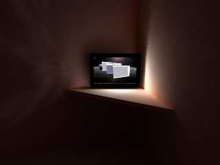

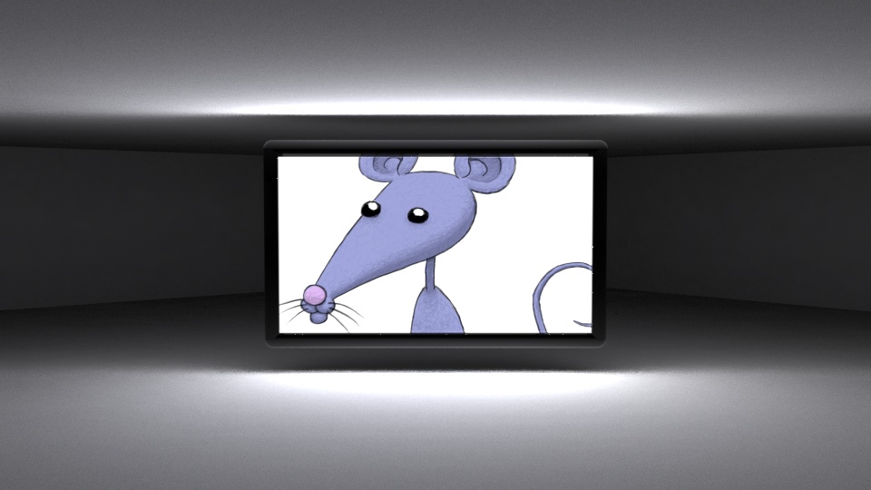

render time 1:18:08.  three noncoincident boxes containing df3s (red,
green, blue) for screen with emitting 10*each colour, 10 brightness
factor for radiosity, 1600 samples, 0.1 error bound, 4 recursion limit,
6 nearest count, 0.01 minimum reuse, 0 grey threshold.
Tim Cook
http://empyrean.freesitespace.net
Download 'df3 test.png' (116 KB)
Preview of image 'df3 test.png'
Tim, it's a crazy thing you tried. It did work out, though! The render time
isn't as bad as I would expect with such high settings. The emitting media is
meant to simulate a plasma screen, yes?
I'm not sure if you are aware of this, but there is a way to reduce radiosity
artifacts even when you've reached your 1600 samples limit. You can do this by
adding a tiny surface normal to your objects. I usually use normal{bumps /*.25*/
scale .001} and antialiasing with a low threshold (+a0.01). You should still
keep a low error_bound, but you can get away with lowering the nearest_count
down to 1 and maybe even use a lower samples count.
The biggest problem is reducing the appearance of noise, but with adequate AA
settings you can make things look pretty smooth. IMO, it's preferable to the
standard radiosity artifacts. I think even Thomas would agree :)
Sam

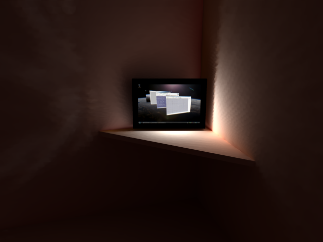

LCD.  One of the newfangled insanely-bright ones.
Huh.  I should try that.  Due to egging on from someone on 4chan's /3/
board, I bit the bullet and finally downloaded the latest beta and am
rendering a version with an image that has a better range of colours.
Holy crap 3.7 is faster than 3.5.  So much so that I decided to really
push the settings...
I dropped the brightness from 10 to 2, kept 1600 samples, dropped error
bound to 0.01, 0.005 minimum reuse, 20 nearest count (to keep the sharp
edge of the shadow from being all grainy), but lowered recursion limit to 2.
I wanted to show as much of the colour-bleed effect as possible, so had
to hunt around for a better image...I actually tried setting gray
threshold to less than 0 (shouldn't that in theory increase saturation?
  haha) but it only allows 0--1.  :(
It's coming along quite nicely.  The walls are a bit sluggish, but it
flies through the media itself like it's not even there.
I long for the day when I can use Moray in conjunction with this.
Tim Cook

Emissive media is fast to compute: no shadow tests.
Media don't receive radiosity lighting.
Your media is very bright relative to the surfaces behind it, making the
radiosity sampling for those areas bailout immediately.
End result: your media renders very fast compared to the rest.
Why are you using such a low error_bound?  You could easily get away with 10
times that, probably more.  Is that the value you came up with through tuning?
Having a higher error_bound would significantly cut the render time and the
required number of samples without a reduction in quality.  You might actually
have fewer visible artifacts, because the number of required samples for
smoother lighting would be below 1600.
Too bad it uses media, because MCPov is always neat for these kinds of things.
-Reactor

From: Tim Cook
Subject: Re: DF3 + emitting media + radiosity
Date: 16 Mar 2010 17:58:55
Message: <4b9fff1f@news.povray.org>
Kind of.  More just seeing how much more I could push it while still
having a reasonable render time.  Here's the image...6:13:43 with the
adjusted settings, POV 3.7b36.
Tim Cook
Download '2010-03-16 df3 test 37b36.png' (273 KB)
Preview of image '2010-03-16 df3 test 37b36.png'

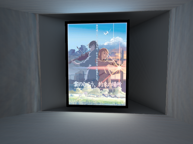

From: Tim Cook
Date: 16 Mar 2010 22:57:40
Message: <4ba04524@news.povray.org>
brightness 4
count 100
error_bound 0.2
minimum_reuse 0.15
nearest_count 10
recursion_limit 2
normal on
normal for walls {granite 0.5 scale 0.01}
render time 0:13:50
Tim Cook
Download '2010-03-16 df3 test2 37b36.png' (585 KB)
Preview of image '2010-03-16 df3 test2 37b36.png'

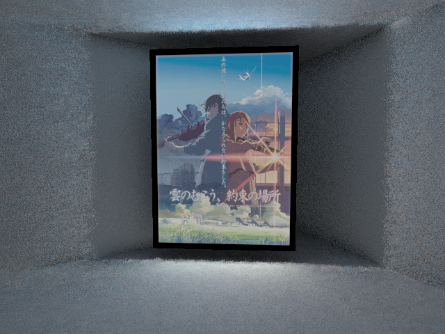

From: Samuel Benge
Date: 20 Mar 2010 15:10:01
Message: <web.4ba51c5d41e17ff2c78aeb90@news.povray.org>
> brightness 4
> count 100
> error_bound 0.2
> minimum_reuse 0.15
> nearest_count 10
> recursion_limit 2
> normal on
> render time 0:13:50
That's terrible! Not the render time, of course, but the quality. Good AA
settings can eliminate most of that static.
I was running some tests yesterday, with OK results, but the render time was way
too high. I'll post the results after this message.
Sam

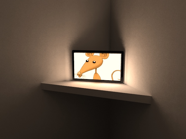

From: stbenge
Date: 20 Mar 2010 15:16:39
Message: <4ba51f17@news.povray.org>
render options:
+a0.003 +am2 +r3
radiosity{
  count 1600 error_bound .2
  pretrace_start .08
  pretrace_end .02
  nearest_count 1
  recursion_limit 2
  normal on
  media on
  brightness 3
  gray_threshold 0
  adc_bailout 1/256
walls:
normal{bumps .5 scale .001}
This 960x540 image rendered in 2h:37m:49s.
Too long, IMO.
Download 'mouse2_37_49.jpg' (98 KB)
Preview of image 'mouse2_37_49.jpg'
From: stbenge
Date: 20 Mar 2010 15:25:33
Message: <4ba5212d@news.povray.org>
Same render settings, except the screen is not made of emitting media;
it is just an ambient plane. A lower error_bound would have fixed a few
ugly spots, but the render was already 2/3 finished before I spotted the
errors :( This one rendered in 2h:30m:07s.
I'm thinking MCPov would be better suited for this type of scene. Or
maybe an area_illuminating lamp residing at the screen position.
Sam
Download 'mouseb2_30_07.jpg' (86 KB)
Preview of image 'mouseb2_30_07.jpg'
Date: 20 Mar 2010 15:29:19
Message: <4ba5220f$1@news.povray.org>
Le 2010-03-20 15:15, stbenge a écrit :
>> time was way
> render options:
> +a0.003 +am2 +r3
> radiosity{
> pretrace_start .08
> pretrace_end .02
> nearest_count 1
> recursion_limit 2
> normal on
> media on
> brightness 3
> gray_threshold 0
> adc_bailout 1/256
> walls:
> Too long, IMO.
Your parameters are very high and you may not need that level.
I'd try:
+a0.03 +am2 +r3
count 500
From: Tim Cook
Date: 21 Mar 2010 20:32:49
Message: <4ba6bab1$1@news.povray.org>
>> render time 0:13:50
Oh, I'm sure there's a sweet spot somewhere.  This was just what I think
are the minimum settings to be fast and not have the blotchiness of what
the settings would give on a flat surface.  (At the expense of grainyness.)
Tim Cook
