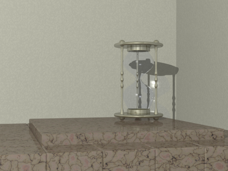

Thanks Alain and Darren of suggestions.
Thought I'd share what I have so far. I'm getting some artifacts with the
glass container, and the upright connectors (lathe objects), perhaps my
Bishop skills need further development. I DO have sturm on  but don't know
where they (artifacts) are coming from ... perhaps viewing angle, or
lighting angle
Jim

I’ve noticed that even with the sturm flag set, I often get artefacts in
line with the horizon. I wonder if changing the orientation of the scene
would help. I can’t remember many problems with Moray which uses Z = up.
That is pretty expensive marble you’re using with the grain running from
one block through to another. You can add a degree of randomness (if you
are using B3D’s Object Array) by adding a small degree of Rot Axis Offset.
Nice modelling BTW. Is the shape of the hourglass from RL?
thanks for the tip ... I'll give that a try!
ha-ha ... yes the texture was just a quick and dirty effort for now,
I have a little random routine that I had not cloned from another scene yet!
yes ... it WAS in the shop last year and didn't sell. I liked it so it's on
my desk now ;-)
I'm having a good time with Bishop and I like it. Modelling in general is
hard and it takes a lot of patience. I've also had to get in the habit of
saving more often especially when I finally get something looking like I
want.
Jim
It didn’t work for me. :(
I’ve been meaning to spec a variant to the object array that adds a
random variation to the objects, for a while. Also a tab to translate
the texture would be useful.
> my desk now ;-)
The glass seams less “teardrop” shaped than I’ve seen before. Very
attractive, though.
I’m glad that you like it. I’ve spent a long time, along with your
countryman StephenS, guiding its development. Wait until you try the
animation features ;)
> want.
Hint: When you save a scene the last save is renamed as MyScene.bak, so
you can revert by renaming the extension to .bsp. Also, I like the Undo
Multiple feature.
Best Regards,
	Stephen
I had camera y and look_at y the same. A couple of degrees of x rotation
made most of the artefacts go away, the rest appear to be ripples in the
lathe shape itself. I imagine a few more strategic points probably wouldn't
hurt!
Jim
Actually Thomas deG once recommended that you should roll the camera a
bit, for artistic effect.
> hurt!
That sometimes helps as well ;-)
Best Regards,
	Stephen
Subject: Re: Hour Glass WIP
Date: 24 Feb 2010 03:17:42
Message: <4b84e0a6@news.povray.org>
"Stephen" <mca### [at] aolDOTcom> schreef in bericht
news:4b84247d@news.povray.org...
hehe! Indeed...  :) just a couple of degrees.
It more or less simulate the fact that nobody is holding a camera perfectly
level. And it adds an extra, unconscious, tension to the image that is
difficul to trace back to its origin if you are unaware of the trick.
