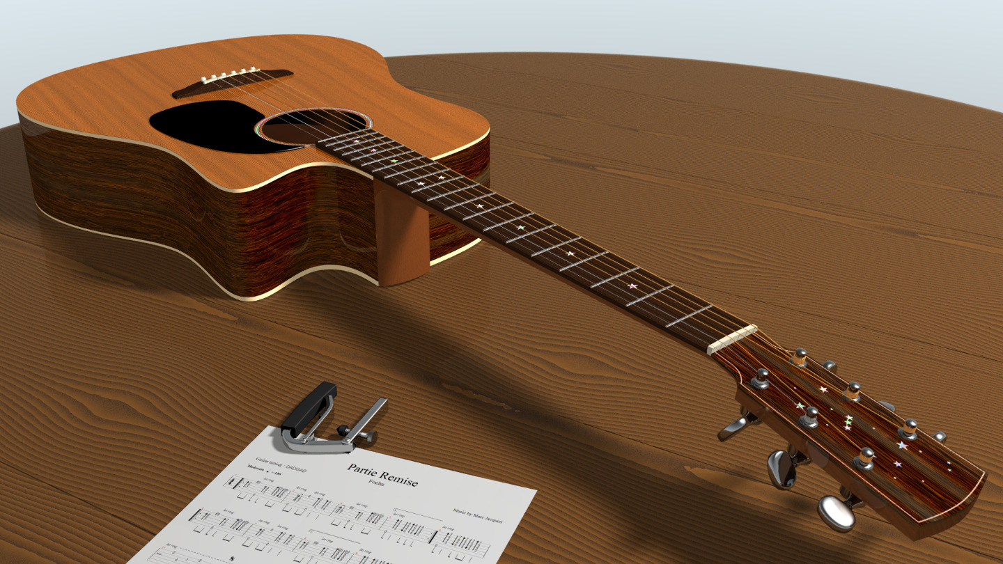

It's a long time since I posted an image.
Here is a revisited guitar I had done for my IRTC soundcard (topic music)
few years ago and I decided to finish.
Now I think I have to work on the table material.
Marc

El 16/01/10 01:45, M_a_r_c escribió:
> It's a long time since I posted an image. Here is a revisited guitar I
> had done for my IRTC soundcard (topic music) few years ago and I decided
> to finish.
   Very good modeling! ...the detail level is amazing.
   I will prefer to see it lay on a chair instead on a table. ...perhaps it's
because I'm Spanish and I'm too used to see flamenco guitarists performing... :)
Jaime Vives Piqueres
http://www.ignorancia.org

Nice work indeed. Excellent texturing of the guitar.
Indeed.  :)

"Jaime Vives Piqueres" <jai### [at] ignoranciaorg> a écrit dans le message
de news: 4b51731b@news.povray.org...
>> to finish.
Thank you !
I modeled it in Moray mostly starting with primitives and CSG.
Then I converted those CSG into meshes for fine tuning
> it's
> performing... :)
For me a guitar laying on a chair is a promise for an accident :-/
BTW how could you be *too* used to see flamenco guitarists :-)
Marc

"Thomas de Groot" <tDOTdegroot@interDOTnlANOTHERDOTnet> a écrit dans le
message de news: 4b5177aa@news.povray.org...
> "M_a_r_c" <jac### [at] wanadoofr> schreef in bericht
> news:4b510c70@news.povray.org...
Thank you :)
I discovered that you can embed layered textures into pigment or
image_pattern textures
> Indeed.  :)
Tell me about ;)
Marc
