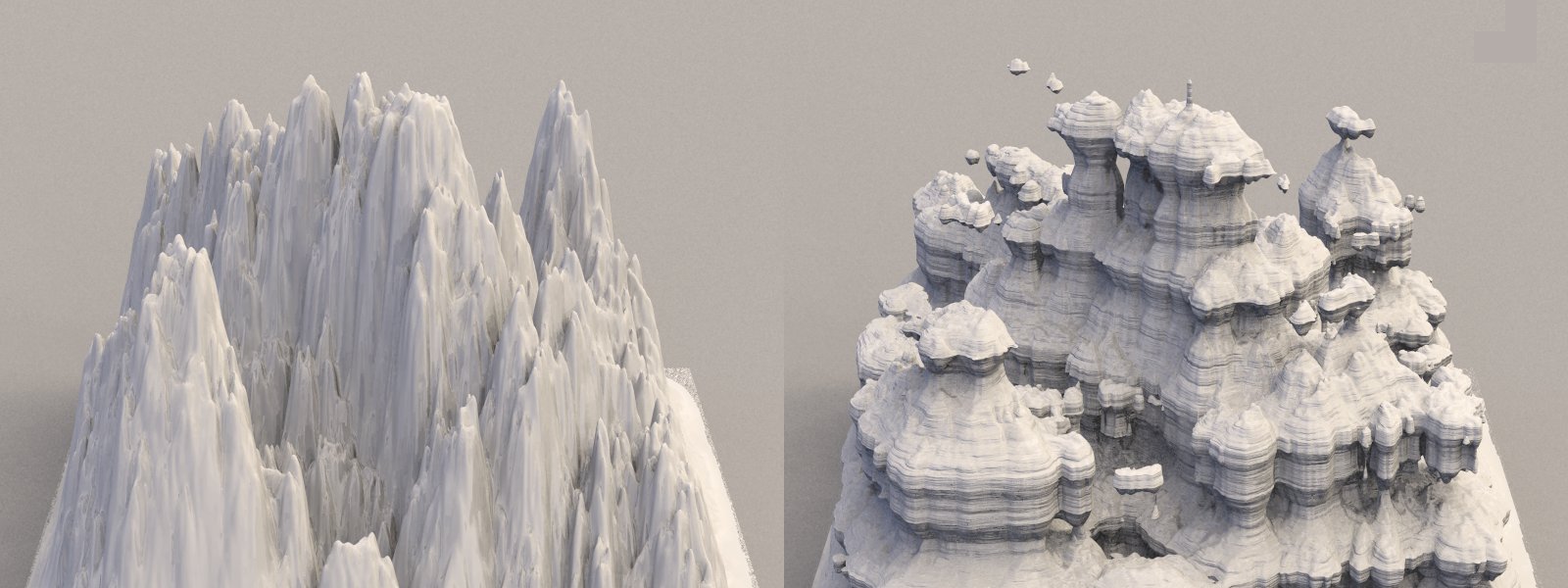

Hello,
Here's a method for slicing a height_field into many pieces and
translating/scaling the parts to create caves and overhangs. It renders
faster than an isosurface, but produces visible seams. It's still pretty
slow :(
The left portion of the attached image shows an unmodified height_field.
The portion to the right is the same height_field sliced 50 times. A
surface normal was added to diminish the appearance of seams. With
enough slices, and with a smoother controlling pigment to create the
overhangs, some of the sharper features can go away.
The coincident surfaces near the base is a consequence of giving the
ground plane a difference pigment than the height_field.
The macro places the object between <0,0,0> & <1,1,1>.

Sam
Download 'hf_slicer.jpg' (148 KB)
Preview of image 'hf_slicer.jpg'

From: nemesis
Subject: Re: rendering height fields with overhangs
Date: 17 Dec 2009 16:55:01
Message: <web.4b2aa7a5ce35323773c9a3e0@news.povray.org>
Going from the Alps to the Gran Canyon.  Nice! :)
From: Edouard
Date: 17 Dec 2009 18:50:01
Message: <web.4b2ac3a1ce35323c0cdd8870@news.povray.org>
stbenge <UN### [at] hotmailcom> wrote:
> Oops, there was some vestigial code in that last macro. Here's a better
> version:
Fantastic idea - although this updated macro doesn't work for me on 3.7. The
original does, so I'm playing with that.
Cheers,
Edouard.

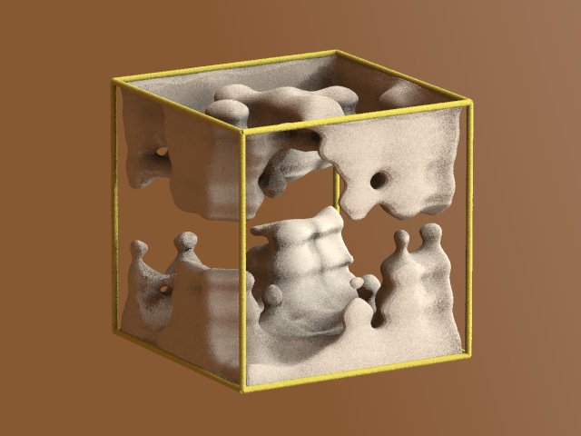

From: stbenge
Subject: a less buggy hf_slicer
Date: 17 Dec 2009 20:40:28
Message: <4b2add8c@news.povray.org>
Those other ones were quite buggy. Odd numbers wouldn't work, the
function for testing the control pigment wasn't accurate, and the thing
was not filling a unit cube correctly.
While testing this, also I realized that the more it stretches a
height_field, the slower it becomes. I wish I could make it more
efficient somehow.
#macro hf_slicer(hfs, hfs_control_pigment, hfs_n_slices)
  #local hfs_n_slices=hfs_n_slices-1;
  #local hfs_incre=1/(hfs_n_slices+1.001);
  #local hfs_function=function{pigment{hfs_control_pigment}}
  #local hfs_p1=0;
  #local hfs_V=0;
  union{
   #local hfs_counter=0;
   #while(hfs_counter<=hfs_n_slices)
    #local hfs_pv=hfs_function(0,(hfs_V+1/hfs_n_slices),0).x;
    #local hfs_p2=hfs_p1;
    #local hfs_p1=hfs_pv;
    object{hfs
     #if(hfs_p1>hfs_p2)
      clipped_by{plane{y,hfs_p1}} clipped_by{plane{y,hfs_p2 inverse}}
     #else
      clipped_by{plane{y,hfs_p1 inverse}} clipped_by{plane{y,hfs_p2}}
     #end
     translate -y*hfs_p2
     scale<1,hfs_incre/(hfs_p1-hfs_p2),1>
     translate y*hfs_V
    #local hfs_V=hfs_V+hfs_incre;
    #local hfs_counter=hfs_counter+1;
   #end
#end
Download 'hf_slicer_5_27.jpg' (35 KB)
Preview of image 'hf_slicer_5_27.jpg'
From: stbenge
Date: 17 Dec 2009 20:43:05
Message: <4b2ade29$1@news.povray.org>
>> version:
Thanks. Were you getting anything at all? How many segments were you
specifying for it?
I just reworked the entire code. Too few slices won't work. Currently,
you can have a minimum of three slices.

> Once again, you've come up with some magical sleight-of-hand! (Your POV code
> creations are coming so fast, I can't keep up with them!) I was hoping someone
> might come up with a method for producing HFs with overhangs. Kudos to you!
> Results so far just astound me; it's one amazing tool. (I haven't yet tried Tor
> Olav's version; just noticed it.) In the short time I've been playing with your
> version #3 code, there seem to be endless shapes it can produce (by varying this
> or that parameter.)  Yeah, I'm experimenting with some of your code, adding
> things here and there, doing everything I can to break it (!) just to see what
> will happen--then putting it back together, of course. :-) I continue to
> 'examine' the code to see how it operates, and what exactly it does. Seems like
> voodoo at present.  :-p
Thanks.
It was a good idea, executed poorly. Tor's version is faster and more
accurate. If I end up making a scene with this, I'll be using his version :)
