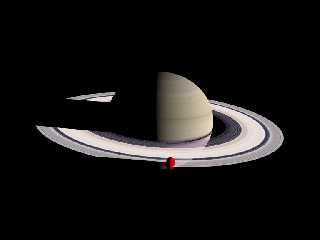

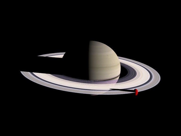

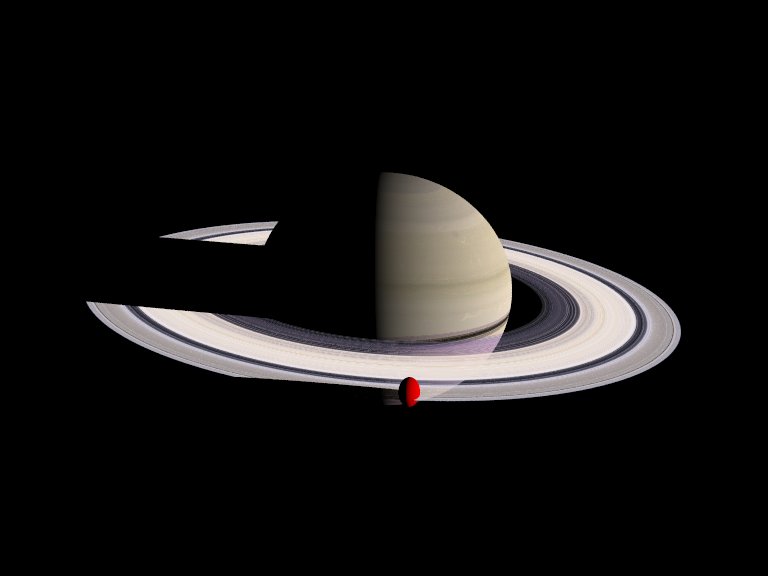

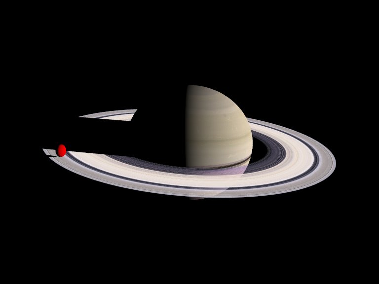

High!
After Reactor led me out of the "media trap" while trying to get
believable Saturnian rings, the next problem occurred: I'm just not able
to make a moon (in this test it's Pan, the innermost one running in the
Encke ring gap at about 135,000 kms from the planet's center) orbiting
exactly in Saturn's equatorial plane!
Saturn is tilted using my "SetAxis" macro according to the equatorial
coordinates of its axis (gleaned from Wikipedia):
#macro SetAxis(dec, ras)
   rotate <23.439281-(90-dec), 0, 0>
   rotate <0, 90-ras, 0>
#end
which is invoked with the parameters 83.537 (declination) and 40.589
(right ascension, in degrees).
After I programmed a small test scene (code attached below) to probe
different inclinations and ascending node angles for orbits, I assumed
the transformation of these two values into my solar system model to be:
#declare Pos_Pan = Pos_Saturn +
bodies[2][0]*<cos(radians(23.439281-(90-bodies[1][10])))*sin(radians(clock)),
sin(radians(23.439281-(90-bodies[1][10])))*sin(radians(clock-(90+bodies[1][11]))),
cos(radians(23.439281-(90-bodies[1][10])))*cos(radians(clock))>;
...but it didn't work - as you can see in the five images attached (Pan
colored red and heavily exaggerated in size for better visibility, at
0°, 30°, 60°, 120° and 315° position), the inclination of the moon's
orbit doesn't match Saturn's equatorial, i. e. ring plane!
Regardless what combinations of signs and angle values I tried, I never
got Pan orbiting in the ring plane...

I really wonder whether I'm in fact intellectually handicapped - most of
you, I assume, throw out such scenes even when half asleep, and they are
flawless! Could it be in fact better for me (and this group) to give up
POV-Ray entirely and turn to something more appropriate for my moronic
little brain, such as munching donuts or collecting die-cast model cars...?

Jörg 'Yadgar' Bleimann a écrit :
> High!
Keep it simple.
First, create Saturn with NO tilting.
Then, place the rings. Still no tilt.
After that, place the various satellites only taling the relative
tilting of ther orbits into acount. Tilt of zero for equatorial orbits,
90 for a polar one.
Finaly, wrap everything on a single union, planet, rings and all moons.
Apply the planetary tilting to the whole union at once.
Subject: Re: Tilted orbit problem
Date: 4 Dec 2009 13:58:06
Message: <4b195bbe$1@news.povray.org>
> Thomas de Groot wrote:
>> I have not looked at your code, but isn't it true that the *whole*
>> saturnian system is tilted? I am almost sure the problem comes from
>> the order in which you do the transformations. What I mean is that
>> when applying the tilt, this should be done to a union of Saturn +
>> rings + satellite. So, you have first to make your satellite orbit
>> around  the planet without the tilt (and at the origin), and only at
>> the end tilt the complete saturnian system (and translate it where it
>> has to go). That way you are sure the satellite remains in its correct
>> orbit.
> Principally, you're right... but then, almost all moons' orbits are also
> more or less tilted against Saturn's equatorial plane, and although
> Wikipedia gives no data about the ascending nodes of these orbits, it's
> highly improbable that they all have their ascending nodes at 90° (which
> would be easiest to calculate). So also with the union method, I would
> sooner or later (when refining my Solar System gradually) face the same
> problem - but then at least one step less to calculate!
> See you in Khyberspace!
> Yadgar
With Saturn sitting at the origin:
Use a 'Y' rotation to move the moon about it's orbit.
Use a 'X' rotation for the tilt plus a 'Y' rotation to shift the nodes.
Then, translate Saturn to it's orbit, and rotate it around to make it
travel along it.
From: Jörg 'Yadgar' Bleimann
Date: 4 Dec 2009 14:47:51
Message: <4b196767@news.povray.org>
High!
The exact formula for the tilt relative to Saturn's equatorial plane
would be vrotate(Pos_Pan, <bodies[73][5], bodies[73][8]-90, 0> - as no Y
rotation would place the ascending node at 90°!
After that, the whole union is rotated relative to the ecliptic to match
the orientation of Saturn's axis...
Yadgar
