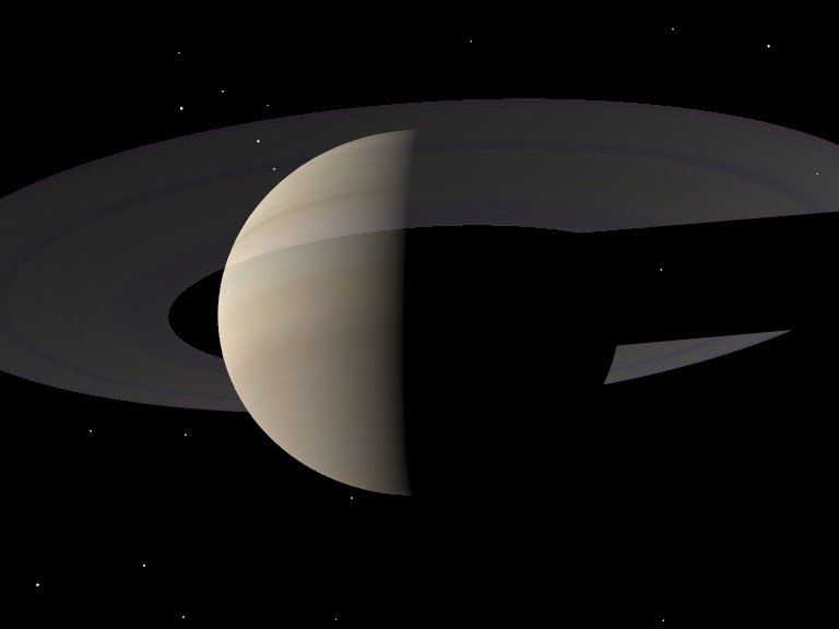

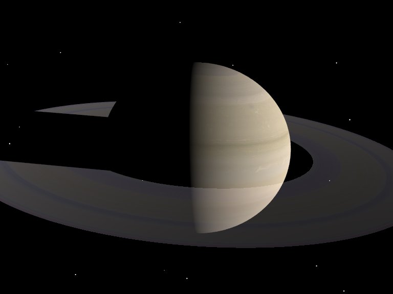

High!
After removing the absorption media, setting the extinction of the
scattering media to 0 and increasing the density_map's values by a
factor of 3000 (!), I at least got visible rings with a stark planet's
shadow on the lit side as well as on the unlit side, but they are both
too faint and too blue - and they cast no shadow on the planet!
The only way make them cast a shadow is to increase extinction and/or
adding an absorption medium - but whenever I try this, I got a shadow
cast by invisible rings!
HELP!!!
See you in Khyberspace!
Yadgar

They cannot cast a shadow, if they do not absorb light (since the extinction is
zero and there is no absorption).  You can either fake a shadow, by placing
another ring with the no_image keyword and allow it to cast a shadow, or you
could adjust the media to make it do both.
I am not sure what you mean by invisible rings that cast a shadow - they don't
show up against the planet or space in lit areas, but the shadow does?  Also,
increasing all of the density_maps values is equivalent to increasing the
scattering color (second parameter).  Can you post some of the code?
-Reactor

Whenever I add even the slightest absorption media and/or extinction,
the rings simply disappear - but strangely, only now cast a shadow on
the planet!
Here is the code:

From: Jörg 'Yadgar' Bleimann
Subject: Re: Finally, the rings are visible, but...
Date: 1 Dec 2009 13:02:26
Message: <4b155a32@news.povray.org>
High!
Reactor wrote:
> What I did notice is that, as best as I can tell, you are viewing the rings edge
> on.  Does the media container show up when it isn't transparent?
I didn't try yet... but will do so later this night (CET)!
> The variable names are a little ambiguous, as such I could not tell the relative
> thickness of the rings.
Relative thickness is 200 metres!
> Did you
> already try increasing the scattering amount proportionally?
Yes, I just tried this, by setting the scattering amount to 10 - and I
got blazingly bright rings close to white-out, but still no shadow on
the planet! As general scattering amount and rgb values in the density
map are equivalent, there seems to be no point in trying the lower the
density values there instead...
And, yes, later this evening I will come up with a self-containing
Saturn scene to test for you! But first I have to do my daily Afghan
bodycount...
Yadgar

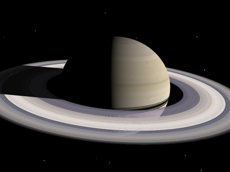

Yadgar

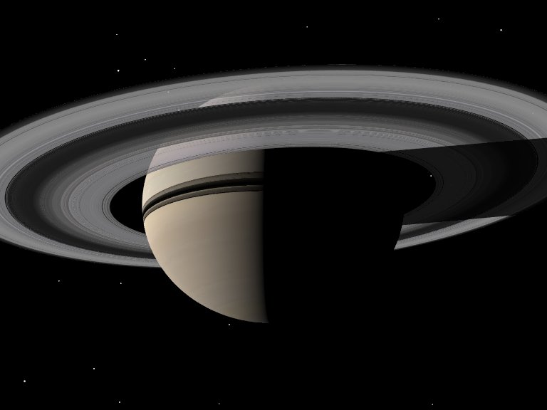

High!
Thank you for your help... as even 200 metres (like in my original
postings) for the rings is ten times too thick to be scientifically
accurate, but also your solution (with media) would have resulted in
rings many kilometres thick, I decided to use double_illuminate rather
than media (I wonder that it works also with 3.6!), as it also speeds up
  animation renderings considerably, compared to using media.
See below what I've got now...
Yadgar
