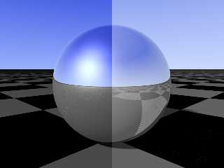

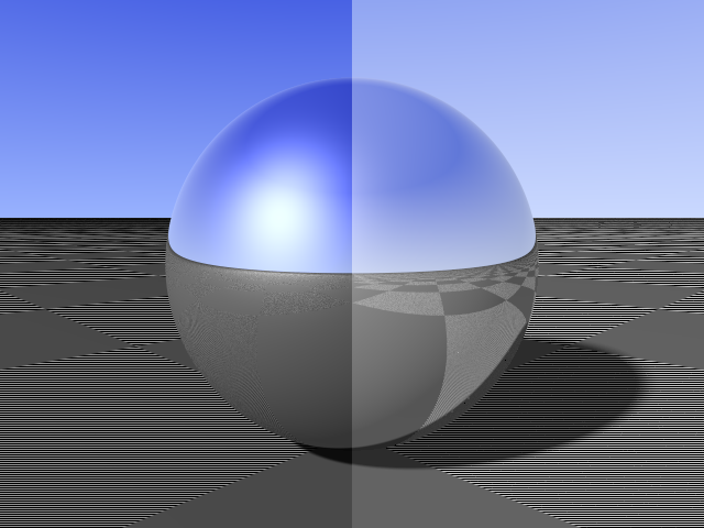

I guess you'll agree there's something wrong with the reflection on the
left side...
Although artificially constructed, this scene may serve to showcase how
raytracing computations can go wrong when ignoring gamma issues.
Left side was rendered with POV-Ray 3.6 with default settings (i.e.
without any gamma handling), right side was rendered with POV-Ray 3.7
defaults (i.e. full-fledged gamma handling); the only difference between
the scenes is in the brightness of the truly-grey squares, to roughly
preserve the percieved contrast to the black-and-white-striped squares
as seen on the unreflected plane (just as you would have to overhaul a
legacy scene if you want to render it with full gamma handling).
Download 'gammachecker_comparison.png' (103 KB)
Preview of image 'gammachecker_comparison.png'

No, what looks "right" can be quantified quite well: For instance, a
50%-intensity-grey should look exactly the same (when you squint your
eyes a bit, or otherwise "physically blur" what your display shows) as a
pattern of alternating black (0%) and white (100%) stripes.

> Or, better put, is the left or right side of your image "correct"?
As you can see (or /should/ see, unless your display an/or your image
viewing software is /totally/ screwed up), the left side shows a
checkered plane, but the reflection on the sphere does not. Can this
possibly be correct?
The right side may or may not look /perfectly/ correct, depending on
whether your display is perfectly calibrated or not, but if it is
/anywhere/ close to sanity, it /will/ look "much more correct" than the
left side (that's a physical fact, not just an assumption about your
personal visual perception).
The only thing that could mess up this "experiment" would be a system
that ignores both color profile information and gAMA chunk present in
the image file, /and/ instead of exhibiting just some typical random
display gamma would happen to use linear color space. *Very* unlikely,
unless the person in charge of the system has no clue about color
management but thinks he/she does.
That, or you may be unable to squint your eyes; in that case, some
peculiarities about your visual perception might kick in and spoil it
all, but even that seems rather unlikely to me. As soon as you somehow
physically blur the image projected by the display (which is what
squinting your eyes does), the experiment /will/ work on every system
that is able to display PNG files at least /roughly/ right.

Guess what: I'm presently on it. The left-side shot was designed to be
an illustration for that.
From: clipka
Subject: Re: Why you may want gamma-correction
Date: 6 Nov 2009 17:47:31
Message: <4af4a783$1@news.povray.org>
SharkD schrieb:
>> left side...
> Actually, no, I have no idea what you're talking about.
Do you see a checkered plane on the left side?
If you don't (even if you squint your eyes or take some steps back),
then your system really screws up PNG files.
If you do, then wouldn't you expect to see that checkered plane in the
reflection as well?
