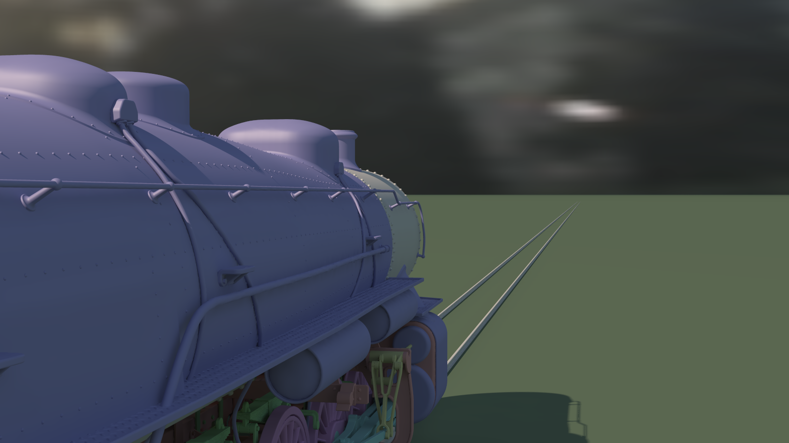

Added some more "steam greebles":
- Corrugated catwalks, handrails & treads
- Sand pipework
- Feedwater pipe
- Pressured air tanks
- Rivets, rivets and more rivets
Not perfectly authentic yet (e.g. the air tanks should actually go on
the left-hand side), but authenticity has to wait until after the
TINA-CHeP deadline (stay tuned on www.tc-rtc.co.uk).

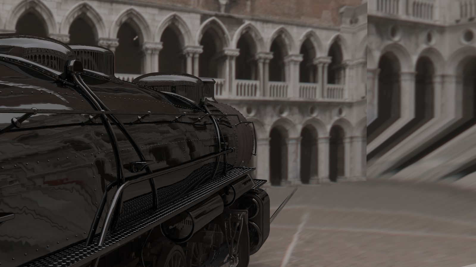

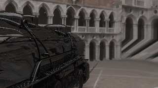

... and on display at venice after a fresh paint job.
Download 'steam 2009-10-17 1757.jpg' (126 KB)
Preview of image 'steam 2009-10-17 1757.jpg'
Subject: Re: Gotta catch that train
Date: 17 Oct 2009 17:48:09
Message: <4ada3b99$1@news.povray.org>
You must rotate that HDR background. The seam is horrible.
Other than that, good job.
I just use it as a lighting stage, which is why I didn't bother.
I like the paint and imperfections of the surface.  Did you use a warp or other
finish to do that?
From: nemesis
Date: 18 Oct 2009 18:59:03
Message: <4adb9db7@news.povray.org>
that's so friggin' nice!
From: clipka
Date: 19 Oct 2009 01:49:59
Message: <4adbfe07@news.povray.org>
> finish to do that?
Thanks. The irregularities in the reflection are simply two overlayed
"bumps":
   normal {
     average
     normal_map {
       [1 bumps 0.01 scale  2.0*in ]
       [1 bumps 0.05 scale 20.0*in ]
where "in" is a distance equivalent to 1 inch in the model.
The rivets are just spheres.
The corrugated catwalk uses an isosurface based on a "bump map" image;
an actual bump map turned out to be problematic regarding the direction
of light (an old ailment of POV-Ray's bump mapping), and the isosurface
didn't bog down rendering time too much.
