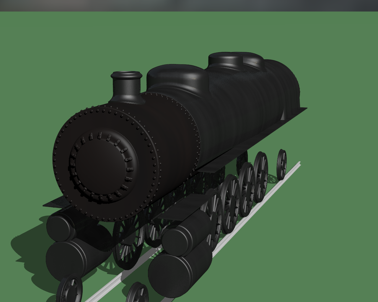

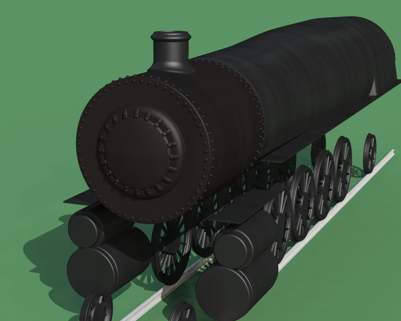

Found some time at last to get back to this model again.
So far, I've been able to stick to solid CSG modelling.
The boiler fairing was quite straightforward as expected, being
basically just a spline lathe. The firebox fairing is a spline prism
(actually two copies tilted a bit along the boiler axis) and to my
surprise fits snugly with the lathe.
The smokestack is a blob construct; the upper rim turned out differently
than planned, but I think it's perfect as it is. I'm a bit worried
though whether I can use the same approach for the steam dome and sand boxes
Boilerplate "decoration" is just a bunch of rounded boxes and -cylinders.
Well, still a long way to Tipperary...
Download 'steam.png' (709 KB)
Preview of image 'steam.png'

From: Trevor G Quayle
Subject: Re: Picking up steam... slowly...
Date: 17 Sep 2009 13:50:01

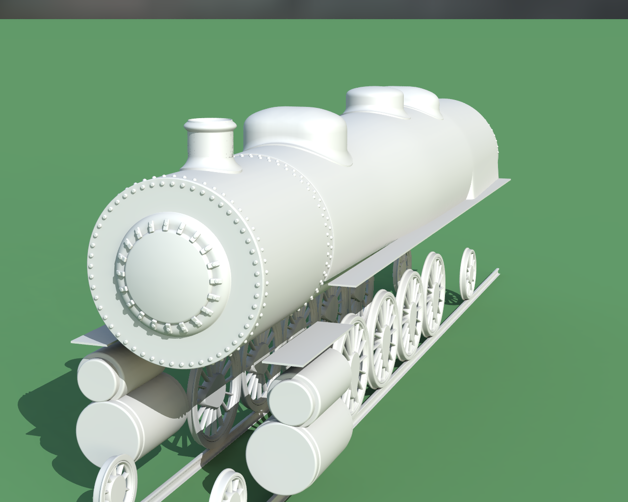

Cool work from what I can see.
Perhaps test render in a flat white texture so it's easier to see details.
-tgq

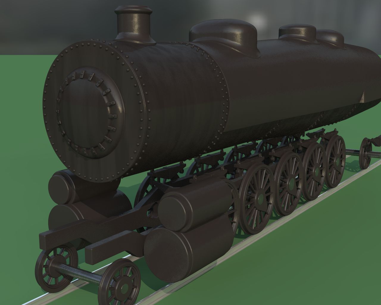

From: clipka
Date: 17 Sep 2009 13:54:45
Message: <4ab277e5@news.povray.org>
> ...crossin' some plains?
Absolutely :-)
Though they won't be this green...
I even got a perfect-fit quote from the book.
BTW, the steam dome and sand box "humps" were actually easier than I
would have thought. Not exactly to the blueprints, but could you tell?
(For some reason though they remind me of German WWII helmets :-P)
I was really worried about those; now that I got them, I'm confident
that I'll indeed be able to make it an all-CSG object.
Download 'steam.png' (455 KB)

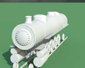

From: clipka
Date: 17 Sep 2009 15:28:13
Message: <4ab28dcd@news.povray.org>
Thanks - though such things are usually supposed to be steaming hot :-)
Well, I didn't want to bore you, but since you ask for it... I think the
black version is more impressive though ;-)
(BTW, someone knows how to get rid of the artifacts at the smokestack?)
Download 'steam.png' (492 KB)
From: clipka
Date: 17 Sep 2009 15:45:30
Message: <4ab291da$1@news.povray.org>
Ah well, never mind...
(Lesson learned: When punching a hole into a blob with a smaller but
stronger blob, make sure that it leaves a substantial wall thickness... >_<)

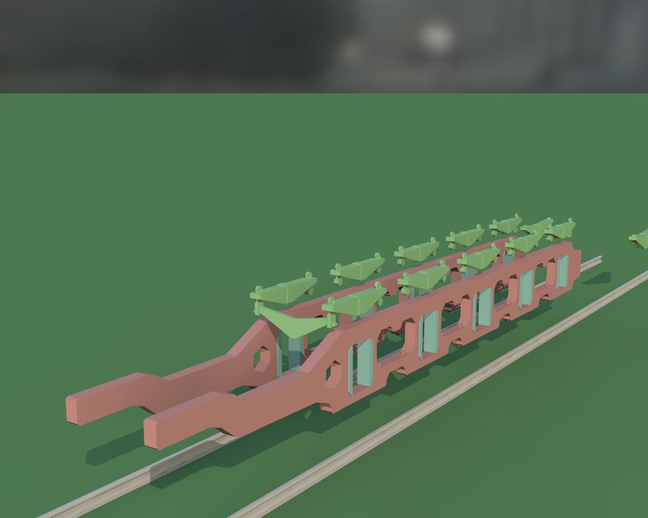

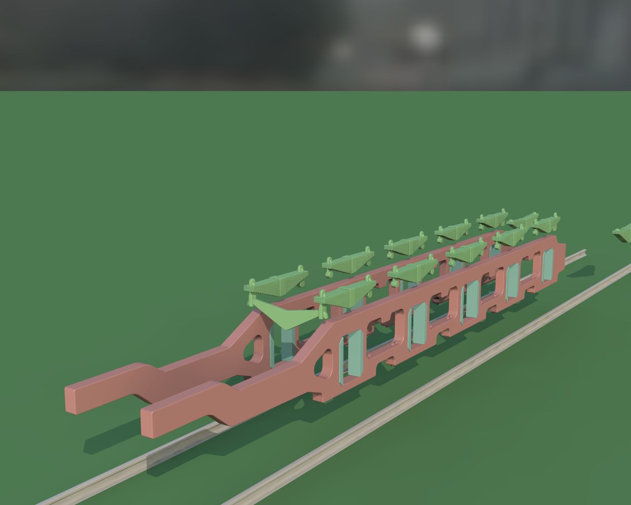

From: clipka
Date: 20 Sep 2009 21:00:25
Message: <4ab6d029@news.povray.org>
Growing a chassis...
Problem #1 that had to be solved: Develop a framework to generate nicely
beveled prism-like objects.
I wasn't sure whether I could pull this off by combining sphere_sweep
and prism objects in some mathematically smart manner, so I ultimately
settled for a nice framework to specify polygons with basically linear
outline, but rounded off at the vertices with circular arcs of arbitrary
radius. This also makes the whole thing easier to control.
The downside is that the heavy use of CSG already starts taking its toll
on rendering times, so I needed a quality parameter to switch beveling
off for quick test renders.
Problem #2 to overcome: Decipher the blueprints. (fortunately I do have
some at all :-))
Download 'steam.jpg' (80 KB) Download 'steam_1.jpg' (55 KB) Download 'steam_2.jpg' (51 KB)
Date: 22 Sep 2009 03:37:16
Message: <4ab87eac$1@news.povray.org>
Impressive and interesting. Nice texture too. I am curious to see how long
you will be able to sustain the CSG construction before render times become
unmanageable...
From: clipka
Date: 22 Sep 2009 05:14:32
Message: <4ab89578@news.povray.org>
> unmanageable...
I guess that will not happen at all.
I actually found that the detail stuff isn't so much of a problem - it
was the big holes punched into the main struts that bogged down render
times for some reason I didn't fully grasp. I'm using a different
approach for them now, which is much more render-time-friendly:
Previously, I had defined those holes separately from the struts' basic
outline, each of these being a complex compound based on a prism shape.
Changing this to use just one multi-loop prism made quite some difference.

From: clipka
Date: 22 Sep 2009 12:59:19
Message: <4ab90267@news.povray.org>
Just to show off the hardest single part so far.
The locomotive has 6 of these - plus 2 more that are similar, but a
little less complex.
Still all pure CSG.
Download 'steam.jpg' (63 KB)
Preview of image 'steam.jpg'
From: clipka
Date: 22 Sep 2009 13:03:41
Message: <4ab9036d$1@news.povray.org>
Alain schrieb:
> Punching holes in any object result in bounding inefeciency, that
> increases the render time.
I know that, but...
> Each and every ray that encounter the bounding box of one of the struts
> needs to be tested against the strut AND every object used to make the
> holes.
... for some reason the many, many small cylinders I'm cutting away to
round off inward edges don't seem to matter that much.
Date: 22 Sep 2009 14:00:40
Message: <4ab910c8$1@news.povray.org>
clipka a écrit :
> I know that, but...
>> struts needs to be tested against the strut AND every object used to
>> make the holes.
A cylinder is much more effecient than a prism to cut holes.
If you cut ceveral holes using prisms, you need to evaluate each prism
for every rays.
Use two prisms, one for the faces and another for the edges, and add
small cylinders to do the beveling between the faces and the edges.
You'll get an union with no or very few differences or intersections.
Do you use a prism and 3 cylinders to punch those rounded triangular
holes. If you use a besier spline, you can have straight and round
parts, and do away with a good part, even all, of the cylinders. Even if
the prism takes slightly longer to render after that, you'll gain more
by no longer having that difference.
From: clipka
Date: 22 Sep 2009 15:00:51
Message: <4ab91ee3$1@news.povray.org>
Um... yes sir, but how would you cut /straight/ lines with a cylinder?
> for every rays.
'Scuse me, but you're not telling me anything new. I didn't want to go
into that much detail, but that's exactly how I've been doing it right
from the start, except that I didn't make use of multi-loop polygons.
(You're forgetting the spheres and tori, btw... you can't properly bevel
in 3 dimensions without those.)
While this may be so, splines are (a) more cumbersome to work with than
the approach I'm using, as they are not so straightforward, to control;
(b) very difficult to smoothly interface to standard box-&-cylinder
geometry, and (c) I'd be lost with the math required to displace the
spline for the beveling job on the outline (if you know what I mean).

From: clipka
Date: 23 Sep 2009 08:55:18
Message: <4aba1ab6$1@news.povray.org>
>> Still all pure CSG.
> wow
Absolutely positively possible (at least for me) only due to a
"rounded-off corners thingumajig" framework.
There's absolutely /no way/ I would go through all the pain of computing
and hacking in the parameters for every individual torus, cylinder and
prism in there :-P
