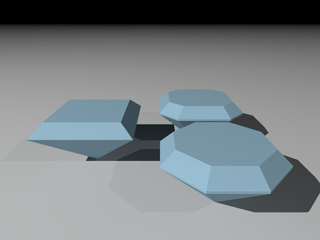

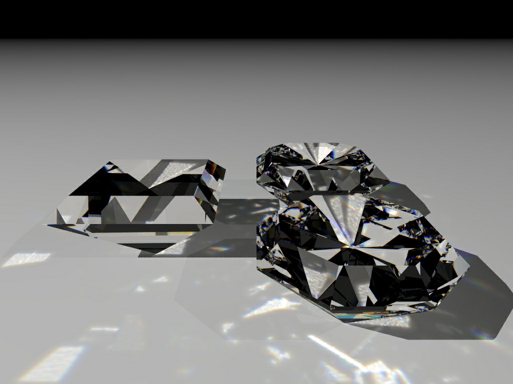

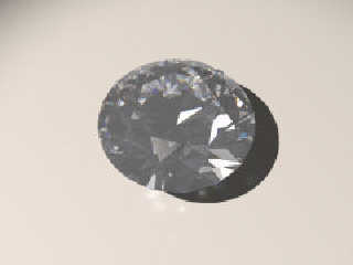

Semi-inspired by my recent rendering, I'm creating a set of macros to
generate cut gems. Also, at one point waaaay back in the past, someone
made a post of diamonds modeled in a piece of software called GemCad. I
wanted to do something like that, but do it differently:
Pure CSG Diamonds.
So, Here are a couple cuts from a class of cuts called "Old European"
On the left is a Table Cut. Nothing exciting, basically follows the
natural shape of a diamond. On the right is an Old Single Cut with two
different parameters. Neither of these are the well-known brilliant cut,
though the Old Single cut may very well be the basis for the brilliant
cut, since it already has all of the proper angles.
There are 2 renders: One with a basic material so you can better see the
shape of the facets, and one with a diamond-like material, complete with
photons.
The next cuts I'll probably tackle are Eight cut, Emerald and Step cut--
since these are relatively simple. Eight cut may be a bit slightly
challenging because the facets are rounded at the edges, but I might be
wrong, it could be very simple, especially if the stone has a girdle.
I'm learning all sorts of terminology with this project:
The top "half" is the crown of the gem, the flat facet at the top is
called the table, the bottom "half" is the pavilion, and space between
the crown and pavilion is called the girdle, if it exists. At the bottom
of the pavilion there can be one more facet, called the cullet, or the
pavilion can come to a point.
I still need to work on cut depth, as well ( which determines the angles
in the pavilion )
Download 'make_gemstone.jpg' (145 KB) Download 'make_gemstone_basic.jpg' (152 KB)
Preview of image 'make_gemstone.jpg'
Preview of image 'make_gemstone_basic.jpg'

Truly shiny.  But such small pieces truly demand some focal blur to appear
realistic!  Yes, I realize it may already have been hard enough with all the
refractions, caustics and dispersion... :P

What's your max_trace_level?  I find that I need an insanely high value high
value for this sort of thing--at least 60 to 100 to get rid of the visibly dark
areas.  Sometimes tracing doesn't bail even after 256, although at this point it
doesn't make much visual impact.

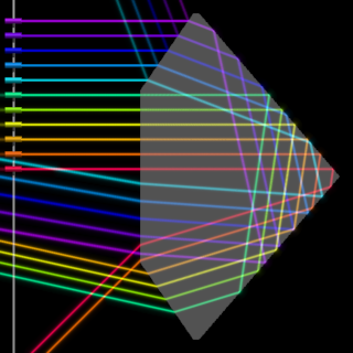

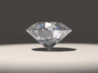

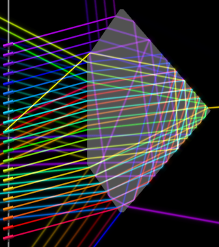

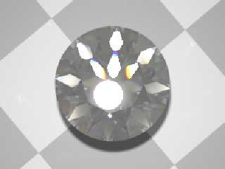

I did a brilliant round cut a few years ago, but was never satisfied with
the results.  They just never had the level of sparkle that I see in real
diamonds.  Looking at the light traces, I suspect that my parameters may
be suboptimal.  (I got the parameters from a Web site that appears to have
passed on.)
I also suspect a bug (feature?) in dispersion: renders seem to be darker
than without dispersion.  It just occurred to me that the multiple
reflections and refractions in a cut gem could possibly exacerbate the
problem.
I know Chris B. will show up to buttonhole us any second now, so I'll just
say that I've been shy about submitting this, because of my
dissatisfaction of the sparkle, but also because I fear that, with just
the one cut, the module lacks generality.
<Insert witty .sig here>

Are you working towards just certain cuts, or any arbitrary stone
cutting instruction set? I stopped pursuing an instruction parser, but
seeing these pictures I will have to start again.
50 but yeah... it went all the way to 50. I'm trying it with 255 to see
if there's a difference.
Oh, and I think some of it may be the black "sky" that it's refracting...

As many cuts as I can find, but with adjustable parameters. A general
parser would be way too much, I think.
The idea is for the user to say "I want an emerald cut, with a w/h ratio
of 1:1.4 a table height of 25% with a pavilion depth of 60% and no cullet."
Well, it would really be something like Gemstone_EmeralCut(1.4,.25,.6,0)
But, you get the picture ;)
BTW, don't forget about the "precious" keyword adc_bailout.  Helps a lot with
too much refraction.  An Alain tip I never forget... :)
> with the results.  They just never had the level of sparkle that I see
> in real diamonds.  Looking at the light traces, I suspect that my
> parameters may be suboptimal.  (I got the parameters from a Web site
> that appears to have passed on.)
> problem.
> just say that I've been shy about submitting this, because of my
Just a few remarks:
You may need a stronger dispersion, and probably more dispersion_samples.
Your specular highlights look like they are not sharp enough.
If using phong, try to multiply phong_size by around 100.
If using specular, try dividing roughness by around 100.
If you use a look_like for your light_source, try yo mage it smaller, or
put the light farther away.
Your transmit or filter value may be set to low, make it much closer to
1. Filter + transmit should add to 1 or almost 1.
Add some variable reflection and don't forget fresnel and conserve_energy.
When you add dispersion, the intensity get spread out. So, it's only
normal that the result looks darker. A solution is to mage the
light_source slightly stronger.
Adding photons can also add a great deal in realism.
From: Mike Raiford
Subject: Re: Shiny things!
Date: 6 Sep 2009 23:17:14
Message: <4aa47b3a@news.povray.org>
Eight cut, under an HDR probe, with traditional lighting for photo
effects...
Download 'make_gemstone.jpg' (152 KB)
Date: 7 Sep 2009 14:25:10
Message: <4aa55006$1@news.povray.org>
> effects...
Much beter. Obviously, the black areas where reflections of the black
background.
