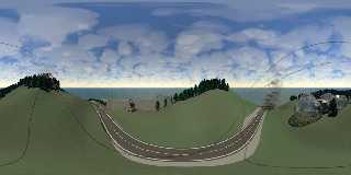

Here's the scene I was talking about in the other thread where an value
of 1 for assumed_gamma was resulting in the image being too bright and
washed out. Either I have to modify TerraPOV's atmospheric media, or I
have to modify every other object in my scene.
-Mike

To me this looks like you're using an awful lot of ambient.

Wow! That made a big difference! However, the colors still seem sort of
washed out. I've attached the new render as well as an old one from
before I lowered the gamma. I prefer the crisp, saturated colors of the
older image.
- Mike

This last one looks alright to me.

Here's my latest render. The scene uses two media for the sky: one for
the clouds and one for the haze. Either one of them by itself renders
pretty fast, but together they cause the render to take a *really* long
time.
-Mike

Are they overlaping or sharing the same container?
I'd try with containers that are distinct, with some gap between them.
That way, you compute one media, them, somewhat further, you compute the
other one. The haze could easily use a low samples value, like samples
3, while the clouds will use a larger samples value, like samples 30.

They each use their own container. The smaller container is inside the
larger. If it makes the scene render faster, I would like to change them
so they use the same container. Not sure how to go about doing this
though. I also don't want to make them use distinct volumes. Their media
should "add".
-Mike

This forces both medias to use the same number of samples.
Also, the sampling for the clouds probably continue into the haze media.
To use only one container, you'll need to add another density pattern.
One media with a single density for the haze.
One media with two densities for the clouds. The new pttern can be
"planar" with a map similar to: (added in the cloud's media block)
density{planar {color_map{ [0 rgb 0][0.02 rgb 1] }}}
To have the clouds go sharply from invisible to full density.
Two media in a container add.
A media with two densities multiply the densities.

Actually I am using concentric spheres. The media attached to the
smaller sphere uses an onion pattern, so I'll need to figure out how to
limit it to just the assigned area instead of repeating.
-Mike

Here is the media for the cloud sphere, which is the inner of the two
volumes. What I need is to be able to "clip" the media to "InnerRadius"
and "OuterRadius" so that I can then simply copy/move the media to the
larger atmosphere sphere.
-Mike

In that case, you can use the spherical pattern, scaled and with a
color_map set to only have a shell.
something like:
density{spherical scale 1000 color_map{[0 rgb 0][0.0000001 rgb 1][0.001
rgb 1][0.0010001 rgb 0]}}
