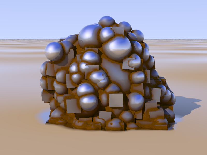

To accomplish its task efficiently, radiosity needs to keep track of how
far other objects are. Isn't it a shame to leave this information to
radiosity alone, when it would come in handy for a proximity pattern?
This shot is proof of that concept.
Download 'proximity.png' (276 KB)
Preview of image 'proximity.png'

   Very promising... I'm already impatient to try it. Indeed, the wet-sand
beach surface is also very nice, and intriguing.
jaime
From: clipka
Subject: Re: Rusty Thing on Beach
Date: 22 Aug 2009 13:51:00
Message: <4a903004$1@news.povray.org>
I'm quite confident to finish it up in time for beta 35 ;-). ATM it only
works with texture maps - which of course is flexible enough, but I'd
prefer to make it work with pigment and normal maps, too. (No way of
making it work with pattern functions though. At least not as long as it
re-uses radiosity data.)
I came across the wet-beach idea by accident. It's basically just a bozo
texture map with a dry-beach (= diffuse only) and a wet-beach (= highly
reflective) texture. Except that I also did make use of that proximity
pattern to force the wet-beach texture in the proximity of "the Thing",
to give the illusion of a washed-out channel around it.

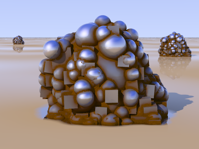

I guess details may suffer when too far away from the camera (due to
radiosity code maintaining some maximum sample density, which depends on
distance from camera), but they'll just get less precise, and don't seem
to "shift" (that was a problem initially).
See attached shot.
One thing that bothers me though is that the proximity pattern is highly
sensitive to final-render-sampling artifacts, so it requires a
higher-resolution pretrace.
Download 'proximity.png' (215 KB)

That's good to know, since a shifting pattern can lose all semblance of realism
during animation.
> See attached shot.
It seems to behave itself well enough.
There's always a trade off somewhere :(
Sam

From: clipka
Date: 24 Aug 2009 04:21:00
Message: <4a924d6c$1@news.povray.org>
stbenge schrieb:
> clipka wrote:
>> (BTW, someone's asking in povray.newusers for advice on your fastprox
>> macros... and speaking of them, do you have them for download anywhere?)
> There is a pattern which is much easier to use than fastprox. I posted
> it also to p.t.s-f. It's actually much more accurate than the "fast"
> prox macros, as evidenced by the attached image. It also produces
> outside edge data.
It also seems to give much cleaner results than my reusing radiosity data.
A drawback I see is that it gives only a falloff to a certain distance
from edges and crevices, then stays level, right?
At the same time there are benefits of course:
- It can be used to model an object with dirty crevices and worn-out
edges that has recently been transported to someplace else; my approach
can only detect proximity to /any/ geometry, and cannot easily be
limited to a subset of the scene geometry (let alone some geometry that
isn't even in the scene).
- It is a true 3D pattern; my approach is only suitable for object
surfaces, and is therefore unsuited for use in media density, or in a
pattern function (which in turn could probably be used to generate a
smoothed version of the object using isosurfaces - what a powerful tool
for beveling that would be!).
Maybe it would really be a good thing to go for a voxel-based approach,
in hope to combine the quality of your approach with the speed gained
through caching data (you wouldn't want /all/ those N inside-tests to be
executed for /each/ iteration step of /every/ ray-object intersection
test to be performed on an isosurface... >_<)
From: clipka
Date: 24 Aug 2009 04:26:39
Message: <4a924ebf$1@news.povray.org>
stbenge schrieb:
> Now, is this a process that follows from screen-level evaluation? Or
> does the sampling fill 3D space evenly? Both? I guess what I mean to
> ask, is will there be a change in the pattern between animation frames?
Being based on radiosity, it follows the same principles when to take
samples - that is, it is entirely screen-level driven - but using the
radiosity save/load mechanism will allow you to carry over samples from
one scene to the next.
From: stbenge
Date: 24 Aug 2009 04:49:41
Message: <4a925425@news.povray.org>
clipka wrote:
> stbenge schrieb:
>> outside edge data.
In a way, this is true. But my methods wreak havoc upon memory and CPU
usage.
Right. A disruption in space by an object continues only to a finite,
specified distance from the object by way of 3D averaging of point data.
Objects must be predeclared which is a big drawback.
Is this good or bad for your method? It seems that having access to
~any~ scene geometry is good. My method is restrictive and costly for
high numbers of objects.
That's the best part I suppose, it's 3D. But I've used it for
isosurfaces and media, and let me say, the results are a mixed bag. Good
surface exploration, sure, but bad, bad render times.
You're very right, I wouldn't and I don't. What looks good as a pigment
becomes very ugly when used as an isosurface. Actually, it looks great
when you overload pigment_pattern lists with 256*256 pattern samples,
keep the accuracy low and the max grad high. Not that I've done it, not
that I want to, not that I need to learn patience some time ;)
From: stbenge
Date: 24 Aug 2009 04:57:13
Message: <4a9255e9$1@news.povray.org>
clipka wrote:
Well, I'm all for this idea of yours. I think its a good, low-cost
method which will become very accessible to a lot of people. /every/
surface, eh? Good stuff indeed :)
From: clipka
Date: 24 Aug 2009 08:06:50
Message: <4a92825a@news.povray.org>
>> data.
> usage.
Sure they do - unless they're implemented in a compiled language and the
data cached.
>> approach can only detect proximity to /any/ geometry, and cannot
>> easily be limited to a subset of the scene geometry (let alone some
>> geometry that isn't even in the scene).
I'd say it depends on what you want to do. At the moment, neither method
seems to be the silver bullet.
From: stbenge
Date: 24 Aug 2009 17:32:39
Message: <4a9306f7@news.povray.org>
stbenge wrote:
> clipka wrote:
>> You're making a point there. Strange that I didn't think of that
>> myself: After all, I did come up with that backside illumination
>> thing, which
> Wait up! You haven't dismissed it as a curiosity, have you? I think even
> if it makes a cameo appearance in a beta somewhere, I might like to see
>  it :)
This is what I get for not paying attention. It looks like I'll get to
play with this feature in about an hour :)
From: clipka
Date: 24 Aug 2009 17:47:04
Message: <4a930a58$1@news.povray.org>
>> even if it makes a cameo appearance in a beta somewhere, I might like
>> to see  it :)
The peculiar thing is that right until now, that former comment of yours
perfectly slipped me, even though I had replied to the post and it
really wasn't long... so much for not paying attention :-D
