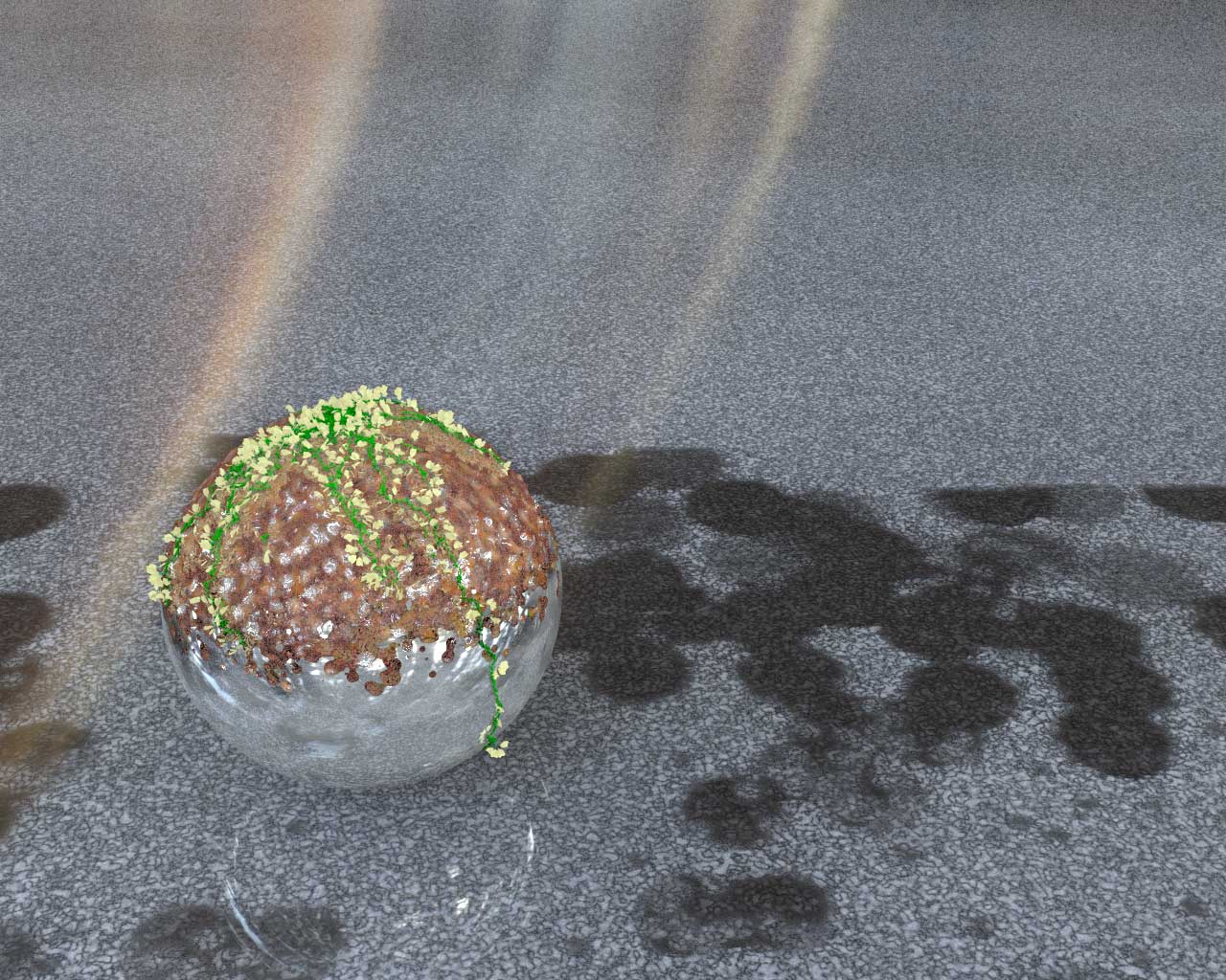

1) I messed up scaling the water iso, so the waves are too wide to see.
2) I used a crappy HDR probe image.
3) I used the vine macro and the corrosion macro, just to see if they play
nice. They do.
This image uses radiosity, but I doubt it caused the odd blotches.
Anyone have any ideas about what these are? Once I can figure it out, I'll
rerender...as it took 13hr..
ian
Download 'HDRSphere.jpg' (217 KB)
Preview of image 'HDRSphere.jpg'

They look like radiosity artifacts to me. Try raising the count. Also, make sure
recursion_limit is high enough that radiosity rays are making it through the
water surface!
Bill

Turns out that it was MTL... O_o'
I fixed my isosurface. And I found a bug in my macros.
Apparently, something does not like it when your trace test vector is
different between calls to the various macros. WTF? I thought that I had
written them so that it didn't matter. Guess I was wrong.
Once this next render is done I will post its source, as I am not seeing the
problem.
My next version will probably include the glacier iso and snow macros, so I
can have spring on the lower left and winter on the upper right, just to get
some thematic asymmetric balance in there.
ian

I *guarantee* you it did, beyond any doubt.
The blotches also tell me that you're using a version of POV prior to
3.7.0.beta.29-rad1 (or a derivative; given that you mention HDR, I reckon it's
MegaPOV 1.2.1)
Your scene's setting is the role model for the infamous POV 3.6 (and earlier)
"black splotchy artifacts" radiosity bug: An abundance of reflective stuff with
an abundance of interreflection. With this setting, you're almost *inevitably*
to contract the "black pox".
There's just one thing to rule them all, find them, bring them all, and in the
brightness bind them: Crank up max_trace_level a really good deal. All other
resistance is futile.
(Or use the current POV 3.7 beta of course.)

recursion_limit is not the screw to tweak here. That parameter is somewhat akin
to the max_trace_level, but rather than limiting the number of *total* bounces
calculated, it just limits the number of *diffuse* bounces. There may be an
arbitrary number of reflection/refraction bounces in between - radiosity
doesn't care (unless the general max_trace_level restriction kicks in).
I never tested it, but thinking about it, my first guess would be that raising
recursion_limit would actually make the splotches worse in number (albeit
possibly weaker).
