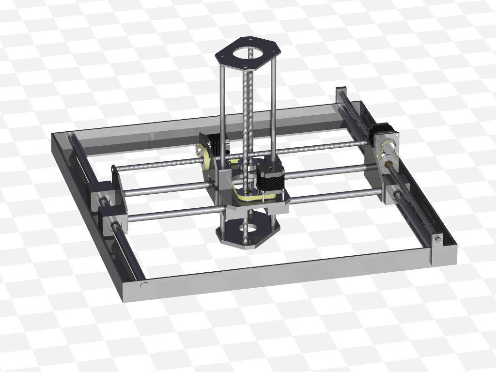

As well as pretty pictures, POVRay is very useful as a 3D design tool.
I've been designing a CNC router for the last few weeks and being able
to render it from any angle has helped me get over many design
difficulties.
Rarius

From: Kenneth
Subject: Re: My CNC router design
Date: 7 Mar 2009 23:05:01
Message: <web.49b33df54b56cbe3f50167bc0@news.povray.org>
> difficulties.
> Rarius
As always when designing such machinery, 'success lies in the details'--the
proper bearings, the elimination of mechanical backlash, etc.  I'm curious as
to what type of threaded drive shafts you plan on using?
Something to be aware of (and this is from my own personal experience) is that
using *multiple* threaded shafts to drive a single axis can create problems and
headaches in trying to get things to work reliably (not insurmountable ones, of
course)-- the shafts need to be as parallel as is humanly possible--in two
axes--so the moving platform doesn't 'lock up' at some point. Perhaps you've
taken that into account already.
Good luck with the design; it looks very promising. (Someday I want to build one
of these things myself.)
Ken W.

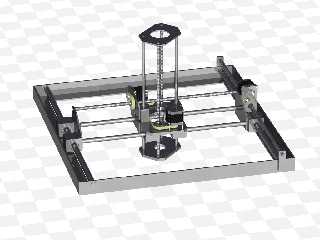

From: Rarius
Date: 8 Mar 2009 06:14:12
Message: <49b39a74@news.povray.org>
Here is a plain text post with a updated image of my CNC design.
Rarius
Download '3AxisRouter3.png' (196 KB)
Preview of image '3AxisRouter3.png'
From: Rarius
Date: 8 Mar 2009 06:21:52
Message: <49b39c40@news.povray.org>
> details'--the
> as
The drive spindles are 12mm trapezoidal with a 3mm pitch
(http://www.worldofcnc.com/products.asp?recnumber=61) running in bronze nuts
(http://www.worldofcnc.com/products.asp?recnumber=47). The rails are 12mm,
16mm and 20mm ground shafts
(http://www.worldofcnc.com/products.asp?recnumber=14) running through linear
bearings (http://www.worldofcnc.com/products.asp?recnumber=16).
I bought a job lot from eBay. It included four spindles, three pairs of
round rails and all the linear bearings needed... All in all about £200
worth. I got it all for £55!
> that
> problems and
> ones, of
> you've
You make a good point. Originally I was going to drive the two Z axis
spindles with two stepper motors. By tying the two Z axis drives together
with the toothed drive belt I don't beleive that I should have any problems
such as you describe.
I have changed the system from driving the spindles so that the spindles are
now locked in position and the nuts are rotated around them, thus pulling
themselves along the spindle. This should remove any problems from the
spindles wobbling as they turn and also removes the need for bearings at
both ends!
I think the problem of "racking" on the X axis is more of a worry. Although
not shown on the image I have decided to add a cable system like that used
on large draftsmans drawing boards to stop any rotational movement as the
carriage moves backwards and forwards along the X axis.
Rarius
From: clipka
Date: 8 Mar 2009 07:30:00
Message: <web.49b3aba14b56cbe3a745f7570@news.povray.org>
> Rarius
Hey, someone stole the drilling tool!
Attachment worked fine this time, thanks.
From: Kenneth
Date: 8 Mar 2009 07:40:00
Message: <web.49b3adf34b56cbe3f50167bc0@news.povray.org>
> running in bronze nuts. The rails are 12mm, 16mm and 20mm ground shafts
> running through linear bearings.
Some nice components! Especially the linear bearings with the recirculating
balls. I'm not familiar with 'trapezoidal' threads; from the photo at the
website, they look kind of like 'Acme' threads here in the 'States.
You lucky guy!! I'm jealous.
Ken W.
From: CShake
Date: 8 Mar 2009 12:49:26
Message: <49b3f716$1@news.povray.org>
> Rarius
Yeah, that could be an issue. Since you've got two sliding rails and a
third driving rail, your system is kinematically over constrained, so
any racking between the two sides would put a lot more frictional load
on the drive motor, possibly causing harm. This can be helped by doing
what you said with extra cables, or another workaround is using thinner
bearings spaced farther apart, instead of a single long sleeve bearing.
That way any rotation can move the individual bearing races a little bit
out of alignment, instead of putting a huge torque side load on each end
of a long bearing.
How are you keeping z vertical? If x is the first motor, I'm slightly
worried about it bending around y, especially if you have a large load
on the cutter - it could bend against the long thin rails.
Another thing - the timing belt pulleys on the z axis aren't centered on
the threaded rods?
-cshake

"CShake" <cshake+pov### [at] gmailcom> wrote in message
news:49b3f716$1@news.povray.org...
>> Although not shown on the image I have decided to add a cable system like
>> that used on large draftsmans drawing boards to stop any rotational
>> movement as the carriage moves backwards and forwards along the X axis.
>> Rarius
> third driving rail, your system is kinematically over constrained, so any
> racking between the two sides would put a lot more frictional load on the
> drive motor, possibly causing harm. This can be helped by doing what you
> said with extra cables, or another workaround is using thinner bearings
> spaced farther apart, instead of a single long sleeve bearing. That way
> any rotation can move the individual bearing races a little bit out of
> alignment, instead of putting a huge torque side load on each end of a
> long bearing.
I would have liked to move the X bearings further apart, but that quickly
starts to eat into the available work area. If I had been buying the rails
new I would have bought much longer ones, but as I bought them second hand I
am stuck with what I have.
> worried about it bending around y, especially if you have a large load on
Just to clarify: In my design, the X and Y  lie in the horizontal plane. X
is the front/back axis, with the motor on the far right. Y is the side to
side axis and Z is the up/down axis.
The Z axis is held vertical by the two vertical  rods that drop through two
pairs of linear bearings. I agree that three would be better but I'll see if
the two can cope. I can always rebuild later.  It is lifted by the two
vertical spindles that are both driven by the stepper motor.
The sideways force on the router bit should be reasonably small as I will be
using small bits and low feedrates.
> the threaded rods?
Thanks for pointing that out. A typo crept into the script during an edit
lat last night! Fixed now.
Rarius
