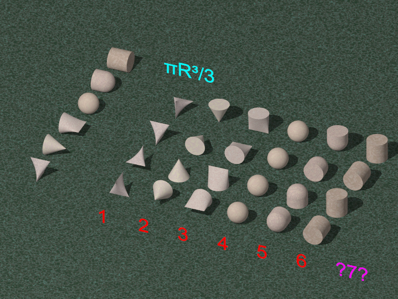

More than the classical cone/sphere/cylinder used to count 1,2,3.
Counting from 1 to 6, here a set of increasing volumes.
Constraint are:
 * Volume must be inside a box of size 2R
 * Each side of the box must be touched, at least by a point, even on border
 * Volume of solid must be an exact multiple of piR³/3
In theory, a 7piR³/3 volume can fit the box (as 7*pi/3 < 8), but is
there such simple solid ? And what does it looks like ?
Solids are:
 1. Milk carton (berlingot) quartic
 2. Cone
 3. conocuneus (coin conique) quartic
 4. Sphere
 5. spherical top on cylinder
 6. Cylinder
Download 'volume.jpg' (289 KB)
Preview of image 'volume.jpg'

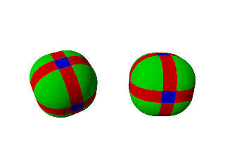

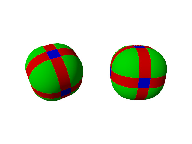

Here is a crazy superellipsoid shape which fits the bill of 7*pi/3. Although I
do have a mathematical formula which gives an exact multiple it is very nasty
so I am not sure if this counts under your brief for the shape. I have mainly
constructed this as a point of interest that such a shape can be found and
built easily with pov csg. I am still hoping I can find a simpler shape which
wouldn't have required quite so much work to build.
Malcolm

Le 15.01.2009 22:48, milco2006 nous fit lire :
Can you explain a bit how, I fail to understand it's construction.
Is there some ratio from green to blue/red ?
> Although I
I have nothing against a superellipsoid, as long as you provide its
parameters (and hopefully they are some kind of 'nice', even a cubic
root of a fraction might match), and by the same way demonstrate that
the volume is exactly and mathematicaly 7pi/3.
(and not an approximate value close enough)
Which seems a bit complex to perform, given that the sole formula of
volume that I found on mathworld for the superellipsoid is based on the
Gamma function, which is far from simplying to 7pi/3 at some stage.
(Just prove me wrong... I have no doubt that one superellipsoid, or even
a whole family of them, can have the right volume... but the real answer
 need to identify which ones!)

From: milco2006
Subject: Re: 6 volumes
Date: 18 Jan 2009 17:55:01
Message: <web.4973b2be1026618d3b1a12740@news.povray.org>
Firstly let me apologise as the term superellipsoid is slightly incorrect as it
is really more of a rounded box in the strictest sense. The reason I left it
split into blue and red and green is that this splits the shape down into 8
parts of spheres (green), 12 parts of cylinders (red), 6 small boxes (blue) and
one big box (which is inside). This identifies the different parts of which the
shape is composed.
As I mentioned the different parts are varying shapes. To calculate the volume
one merely requires to add up the volumes of the whole or part shapes. To get
an exact formulation I used 'l' to be the length between the centres of the
corner spheres and 'r' to be their radius. We also know that l+2*r=2*R which
allows us to construct a cubic equation solely in l. This can be solved to find
required values and thus the shape can be constructed. The solution is not just
a little nasty, but rather very nasty but does exist and is expressible using
cube roots and fractions of polynomials in pi.
The nastiness of the solution somewhat detracts from the problem at hand
somewhat. So although I have presented a shape that has the correct volume it
is not a very satisfying solution.
The value can be calculated exactly due to the ability to split the shape into
standard geometrical sections. And as the solution to the cubic can be given in
a series of constants and mathematical operators it can technically be
calculated without approximation.
I am still keen to find a more natural shape that fulfils your conditions
however I hope this explanation is helpful.
Malcolm

Le 16.01.2009 20:04, Trevor G Quayle nous fit lire :
> Le_Forgeron <jgr### [at] freefr> wrote:
>> Solids are:
>>  2. Cone
>>  4. Sphere
>>  6. Cylinder
> #3 could also be replaced with a paraboloid.
> V=1/2pi a^2 h    - a=R, h=2R
> V=1/2pi R^2 2R
> V=piR³
> V=3piR³/3
> -tgq
Yes. Well seen.
Nevertheless, I have a slight preference for ruled surface when
possible. (1,2,3 & 6 are ruled surfaces, 4 is obvious, and the one I'm
most dissatisfied with is 5). That's personal, so no problem if your
favorite suite uses a paraboloid, it's just that recognizing x2 vs x4
only by the eye is not obvious for me, whereas a ruled surface is less
ambiguous.
