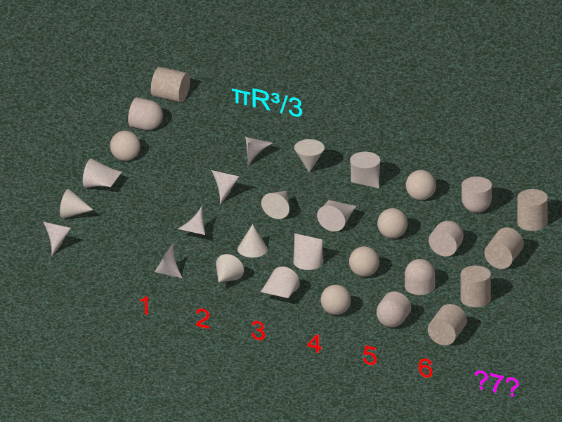

More than the classical cone/sphere/cylinder used to count 1,2,3.
Counting from 1 to 6, here a set of increasing volumes.
Constraint are:
 * Volume must be inside a box of size 2R
 * Each side of the box must be touched, at least by a point, even on border
 * Volume of solid must be an exact multiple of piR³/3
In theory, a 7piR³/3 volume can fit the box (as 7*pi/3 < 8), but is
there such simple solid ? And what does it looks like ?
Solids are:
 1. Milk carton (berlingot) quartic
 2. Cone
 3. conocuneus (coin conique) quartic
 4. Sphere
 5. spherical top on cylinder
 6. Cylinder
Download 'volume.jpg' (289 KB)
Preview of image 'volume.jpg'

Would a shape with a square top and circular bottom work (similar to 3 which is
a line top and round bottom).
I don't know what the exact volume is but it would seem that it would be the
average of a cylinder and a cube: (6+8)/2=7

The problem here is that the targeted volume is (pi/3)*7, not 1*7, and the
volume of the cylinder is (pi/3)*6, not 1*6, while the cube's volume is plain
boring 1*8.
So a gradual cross-section morph from square to circle in a way that the
cross-section area increases linearly (similar to #3) would indeed give a
volume equal to the average of a cylinder's and a cube's volume, but that
wouldn't fit the bill.
Of course, a rectangular box of size 2*2*(pi*7/12), skewed by 2-(pi*7/12) to
"fill" a 2*2*2 cube, would do the job, but something tells me that it would not
be quite in line with the spirit of the puzzle ;)

>> Solids are:
>>  2. Cone
>>  4. Sphere
>>  6. Cylinder
> #3 could also be replaced with a paraboloid.
> V=1/2pi a^2 h    - a=R, h=2R
> V=1/2pi R^2 2R
> V=piR³
> V=3piR³/3
> -tgq
Yes. Well seen.
Nevertheless, I have a slight preference for ruled surface when
possible. (1,2,3 & 6 are ruled surfaces, 4 is obvious, and the one I'm
most dissatisfied with is 5). That's personal, so no problem if your
favorite suite uses a paraboloid, it's just that recognizing x2 vs x4
only by the eye is not obvious for me, whereas a ruled surface is less
ambiguous.
