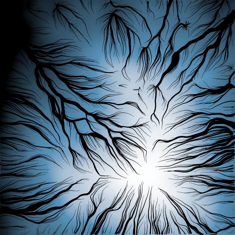

Sheesh, this image didn't want to compress well at all!
Can anyone guess what I was working toward when I came across this
image? It should be easy to guess. There seems to be a lack of good,
free implementations of it anywhere...
Sam

That's beautiful.
I don't know what it's supposed to be, some kind of roots or seaweed maybe?
I'd really like to see the source code I have no idea how you've done it!
Tek

From: stbenge
Subject: Re: Dunes (64k jpg)
Date: 9 Aug 2008 21:14:06
Message: <489e40de@news.povray.org>

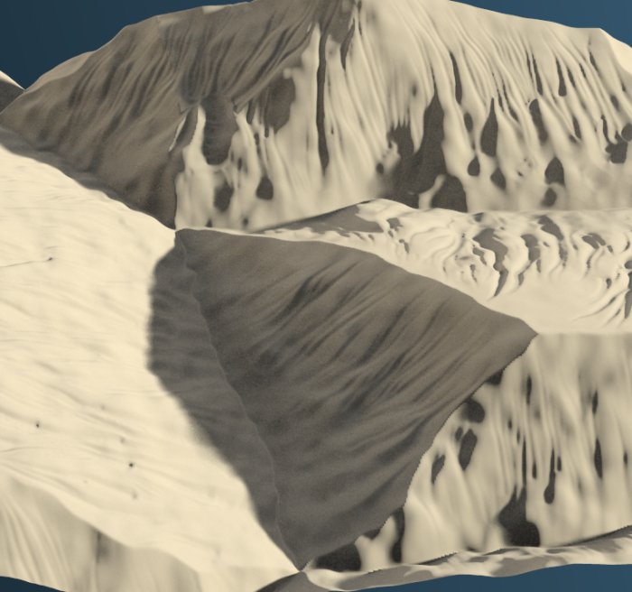

Tek wrote:
> That's beautiful.
Actually, it's the preliminary result of an erosion setup I have going.
The attached image shows what it can do so far. It still needs more work
done to it before it can simulate sharp-edged "Alaska style" erosion.
All I'm really doing is using trace() on a height_field and updating the
vectors to correspond with the surface normal. The objects are cylinders
which grow bigger the longer they are "alive."
Sam

Very neat! Shouldn't cones not be more appropriate than cylinders in this
context?

Ah of course! That's a really nice effect already but I look forward to
seeing the "Alaska style" results :)

stbenge wrote:
> There seems to be a lack of good, free implementations of it
> anywhere...
The basic edition of World Machine is free, although the
output resolution is then restricted to 512x512. Still, could
be enough to get the basic erosion done and then add some
finer details in POV using f_ridge.

Thomas de Groot wrote:
> "stbenge" <THI### [at] hotmailcom> schreef in bericht
> context?
Yes, of course, but I wanted to test the proof-of-concept first, and
worry about cone-sphere connection issues later. As it is, this project
isn't working out too well...
Sam
Well, you might be looking forward for a long time, because this
technique isn't working out! All I've managed to do is scratch the
surface down the sides of the height_field. Maybe I should post the
source so other people can look at it. A free, fully-automated erosion
setup producing 16-bit gray scale height maps... that would be nice.
Sam

Christian Froeschlin wrote:
>> anywhere...
That's a good idea, especially since it seems POV 3.7b handles 16-bit
gray scale images better. I discovered yesterday that you can
encapsulate them inside pigment statements without them turning back
into black-green green-red ramp wave nightmares. It makes the
possibilities open up ;)
Sam

stbenge <THI### [at] hotmailcom> wrote:
> Sam
Suddenly I am reminded of playing with the 'flow' command in hf_lab in an
attempt to build eroded height fields... I had limited success.  I am very
interested in your technique(s), though.  I've wondered whether a decent
erosion routine could be made into functions for use with isosurface based
landscapes.
-Reactor
That's been my experience with everything I've tried. World Machine has
good erosion, but the free version limits the size of the map :(
Christian Froeschlin has a good idea for making use of the limited
files. The way POV now handles 16-bit grayscale images makes his idea
even easier to implement, I think.
> I am very
> landscapes.
Anything can be done, but at what cost? Isosurfaces are already slow,
and to incorporate erosion... well, I hope you won't be using your
computer for a while :)
I'd rather make it work with height_fields, but in a more dynamic way
than it is now. I don't know how to do this yet, though.
Sam

finding a good way of making overhangs in landscapes.  The next thing I want to
try is something my brother described: a six-sided heightfield in which 6
images determine the shape of the landscape.  I am not sure how to implement
that yet, but that and another idea of blending heightfields and meshes are
things we want to test out and see if they would be feasible.
-Reactor
Date: 13 Aug 2008 04:13:15
Message: <48a2979b$1@news.povray.org>
"Reactor" <rea### [at] hotmailcom> schreef in bericht
news:web.48a1e2994025b6ec993f4ab30@news.povray.org...
> No, unfortunately.  I was having trouble with the Wings uv mapping export
> at the
> time.  I might revisit it at another point, but it was really an
> experiment into
> want to
> implement
> are
I see. I have not been overly enthousiastic about Wings uv mapping. Nowadays
I prefer Silo to it (not free, however).
In the past, I have made objects composed of different heightfields, unioned
and differenced together. In particular, a six-sided tower! That works very
well indeed. Overhangs can also be created by heightfields placed
vertically. Differenced with a horizontal heightfield on top, and you have a
(ragged)cliff.
I think that blending of heightfields together and/or with meshes is not
difficult in itself, the problem is the seam which will often show up as a
fairly straight line under some viewing angles. That can be hidden to some
degree by an appropriate global texture or by carefully placed objects in
the line of sight, but it is tricky.
From: Sven Littkowski
Subject: Re: Unexpected Abstract (168k jpg)
Date: 31 Aug 2008 16:32:05
Message: <48baffc5@news.povray.org>
Some sort of trees seen from below, against the sunny sky..?
