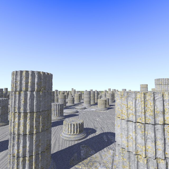

I have also put my teeth into Bill Pragnell's Mesh Approximator macros,
revisiting the ruined place I had been working on earlier.
Here, I have *eroded* the column segments using the MeshShape() macro. It
took some experimenting until the shape came out right, but I am rather
satisfied with this. The basic shape is CSG. I experimented with isosurface
but could not get the top and bottom surfaces right. They resulted in
strange funnel-shaped surfaces.
Another difficulty is the base of the column which consists of a flat CSG of
torus and cylinder. I have not (yet) been able to approximate that correctly
with the macro.
Anyway, here is the state of the art.
Download 'IonianTempleRuins_3.jpg' (85 KB)
Preview of image 'IonianTempleRuins_3.jpg'
From: Stephen
Subject: Re: More again from the mesh relief macros
Date: 10 Jun 2008 06:13:10
Message: <rsks44dlcong1hmr487v235eu73un6d02d@4ax.com>
On Tue, 10 Jun 2008 11:40:52 +0200, "Thomas de Groot"
That is looking nicely weathered.
I know that it is still a WIP and you're using it to test/demo but I
have a couple of suggestions.
I think that the gaps between the blocks are too large and the layout
of the palace (?) is wrong. Columns that apparent size would support a
larger open space between the rows IMO. Anyway the columns are looking
good.
Regards
     Stephen
Date: 10 Jun 2008 07:44:57
Message: <484e6939@news.povray.org>
"Stephen" <mcavoysAT@aolDOTcom> schreef in bericht
news:rsks44dlcong1hmr487v235eu73un6d02d@4ax.com...
> good.
Thank you indeed, Stephen.
I am aware of the gap between the blocks. I have already reduced it but
still not enough. It appears from the weathering macro itself as the central
axis is slightly thicker than the edges. I have now compensated
(automatically) for the basis of the block, but I need to do this also for
the top, in order for trace() to do a correct job.
About your second comment: It might depend on the type of space involved.
The present setting would be rather claustrophobic, depending on the size
relationship with human beings. I am not too concerned about this now, but I
shall keep this in mind for further development.
From: Bill Pragnell
Date: 10 Jun 2008 08:35:00
Message: <web.484e748d7b589d73731f01d10@news.povray.org>
Not to blow my own trumpet too blatantly, but I think this looks much better!
Although that's partly because you've also got the lichen texturing just right
- it looks really realistic. How do the render times compare?
I find this to be the case also.
> with the macro.
Don't forget, you can relocate the object to be eroded before calling the macro.
If you move it upwards slightly it may improve things (the underside won't look
nice, but obviously that's not visible!). Another thing to try is the inner
shape - a wide rounded cylinder could well work better than the default
squashed sphere.
Looking good!
Bill

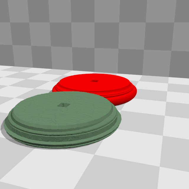

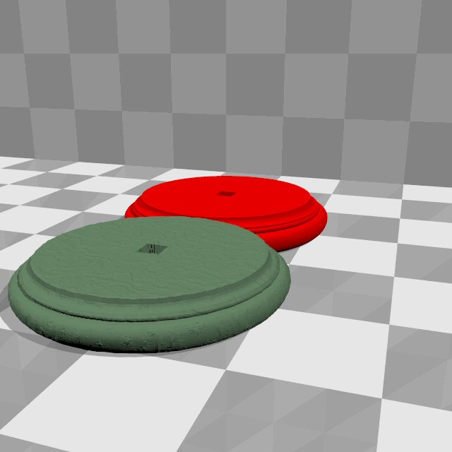

I am sorry for the very bad composition of this image, but it is just a test
to show what I am talking about. The red object is the original column base,
the green object is obtained with a cylinder as inner shape. Not good yet,
as I more or less expected. I tried with a scaled down copy as inner shape,
but that was not satisfying either. Next, I want to try with an adapted copy
of the original.

Download 'BP_meshdemo.jpg' (29 KB) Download 'IonianColumnBase.inc.txt' (2 KB)
Preview of image 'BP_meshdemo.jpg'
From: Bill Pragnell
Date: 11 Jun 2008 06:50:01
Message: <web.484fad347b589d73731f01d10@news.povray.org>
> If you want to experiment, I attached the original inc file to this message.
It is not surprising that you're having trouble; there are too many gaps in the
base object. Look at the cross-section in the image below!
You need to close these gaps, especially the thin gap across the centre and the
concave underside. Unless the square peg-hole has some special purpose I'd plug
this too. And don't forget to make sure it's a merge, not a union, or the
internal surfaces get hit first!
A default flattened sphere as inner object should work OK once you've filled the
gaps.
Hope this helps!
Bill
Download 'coltest.jpg' (30 KB)
Preview of image 'coltest.jpg'

I closed the gaps, and this is the result (with rounded cylinder as inner
shape). The square hole (used for transport of stone blocks and/or anchoring
of column segments) does not really interfere, so I left it in place.
Download 'BP_meshdemo.jpg' (33 KB)
From: Bill Pragnell
Date: 11 Jun 2008 11:10:01
Message: <web.484fe9dc7b589d73731f01d10@news.povray.org>
Much better :-)
