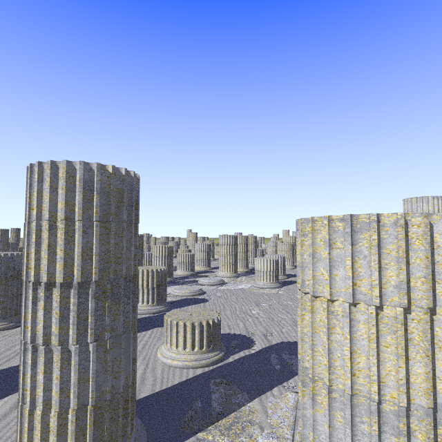

Progressing onwards I guess...
The stone texture is now a complex layering of Jim Charter's StainedStones
macro, Meothuru's corrosion texture, and my own lichen texture. Forget - for
the time being - the need for better radiosity settings and a finer aa. All
in due time. I show here the png version to minimize compression artifacts.
Sorry for the larger file.
I added a height_field with a sand ripple texture. The bad thing is that the
sand does not react whatsoever with obstacles like the columns. That is
simply not good enough although the idea itself is sound. So, I shall have
to think about a way to simulate that...
Download 'IonianTempleRuins_2_06.png' (515 KB)
Preview of image 'IonianTempleRuins_2_06.png'
> in due time.
   Then I think it looks promising... with better radiosity and aa it surely
will look impressive. The texture looks right, perhaps each block needs it's
own "gradient y" dirty layer on top. Also, have you tried a much lower point
of view?
   Perhaps you can remake this heightfield with a top orthographic view of
the current scene, using something in place of each column to simulate the
accumulated sand around. This "something" can be perhaps another heighfield
with an "island-like" shape, randomly rotated for each column... so you
would get a heighfield with a peak in place of each column. I hope my
explanation is understandable...
Jaime
Subject: Re: Ruined Place - WIP 4
Date: 21 Feb 2008 09:54:08
Message: <47bd9090$1@news.povray.org>
"Jaime Vives Piqueres" <jai### [at] ignoranciaorg> schreef in bericht
news:47bd52c9@news.povray.org...
>> StainedStones macro, Meothuru's corrosion texture, and my own lichen
>> texture. Forget - for the time being - the need for better radiosity
>> settings and a finer aa. All in due time.
> surely will look impressive. The texture looks right, perhaps each block
> needs it's own "gradient y" dirty layer on top. Also, have you tried a
> much lower point of view?
the blocks have this gradient (Jim's macro) but it is now somewhat obscured
by Meothuru's texture (although that one is semi transparant) I shall see
what I can do.
>> the sand does not react whatsoever with obstacles like the columns. That
>> is simply not good enough although the idea itself is sound. So, I shall
>> have to think about a way to simulate that...
> heighfield with an "island-like" shape, randomly rotated for each
> column... so you would get a heighfield with a peak in place of each
> column. I hope my explanation is understandable...
Perfectly clear Jaime! I have in fact been thinking exactly in that
direction and it is something I want to experiment with.

Looking good! I think this texture is a great improvement!
Actually, I would use a slope pigment shifted somewhere between y and x (or
both) so that it appears that dirt has accumulated on top and in the flutes in
the direction wind has blown it.
Also, I really think you need to use some isosurfaces to difference out broken
chunks of your columns.  I think that would add a lot of realism to the scene.
And, just a personal opinion, but I feel like the flutes are a bit too deep.
What would it look like if the flutes were shallower but wider?
-- Kirk

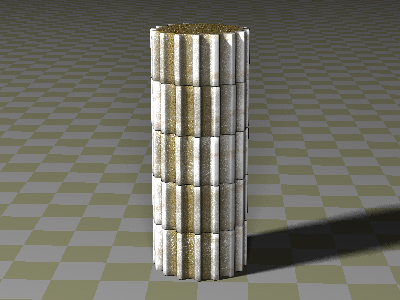

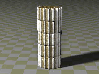

From: Jim Charter
Date: 21 Feb 2008 21:27:07
Message: <47be32fb@news.povray.org>
Hi Thomas, glad to see you are back on this.  I couldn't resist playing
around a bit because I thought the antique ruins an interesting subject
and also I wanted to throw one more idea into your toolkit.
I wanted to play with a method for applying texture which would vary
with the surface.  As you know, one of the usual ways used is the slope
pattern, another is to use methods that share the same pattern for both
distorting a surface (either perturbing the normals or actual
isosurface), and texturing the surface.  Another method I wanted to try
was to use the average of a number of object patterns based on the
object being textured.  Here I used a cylinder of diameter less than
that of the column and averaged a number of scale changes to create some
grunge in the column flutes.  I used your lichen pattern for the grunge
just because it was handy.  I hope this wasn't too presumptuous on my part.
-Jim

Thank you, Kirk. Yes, getting there slowly. I am a slow worker and you guys
are already way ahead of me in giving suggestions for improvements :-)
> (or
> flutes in
Yes, that is an excellent idea and one that I should combine with Jim's.
> broken
> scene.
I am not sure. That would be one direction this scene could take. My present
option is more a place that has been cleaned up to be used for something
else. Which does not opt out the chunks and such of course. Only, I have not
yet reached that stage in my visualization of the scene :-)
> deep.
There are all kind of flutes indeed. I used here the classical feature (also
in numbers) for the Ionian columns. I still have on my ToDo list a number of
different columns.
> part.
This is looking very good Jim! Especially the grunge which is a natural
feature you will see often in flutes. I see a weekend of experimentation
before me to get familiar with your's and Kirk's techniques. Especially the
cylindrical pattern looks interesting to me.
Thanks for thinking along with me! :-)
From: Jim Charter
Date: 22 Feb 2008 10:53:10
Message: <47beefe6$1@news.povray.org>
Cool.
I see that you are right, in this case the 'cylindrical' pattern
can probably be used to do the same thing.
What I actually used and wanted to point out to you was the 'object'
pattern, within which I used a cylinder shape.
Anyway here is the code abbreviated.  There still may be ways in
which the approach gives more control.
//define the 'object' pattern
//here it is a cylinder, often I
//the object I am texturing itself
#local Pigment_Object =
pigment {
   average
   pigment_map {
   #local I=0;#while(I<30)
     [1
       object {
         cylinder {-.45*y,
		.45*y,
		.80 		//a little smaller
                         	//than the Column_Barrel
           scale x*.9    	//skew it a bit
           scale 1+.3*rand(S)    //randomize through the
                                 //iterations
         pigment { rgb 0 }  //outside
         pigment { rgb 1 }  //inside
   #local I=I+1;#end
   turbulence .1
#local Grunge =
texture {
   pigment {
     pigment_pattern { Pigment_Object }
     pigment_map {
       [0 rgbt 1]
       [1 P_Lichen]
//stack up some Column_Barrels
#local A=0;#while(A<5)
   object{
     Column_Barrel
     texture{T_Marble translate y*rand(S)}
     //take advantage of the transparent areas of the
     //texture to layer some random translations
     #local I=0;#while(I<15)
       texture{
         Grunge
         translate y*(1-2*rand(S))
     #local I=I+1;#end
     rotate y*rand(S) //one degree random rotation
     rotate y*(int(rand(S)*2)*24) //two flutes of
                                  //random rotation
#local A=A+1;#end
Date: 23 Feb 2008 05:23:06
Message: <47bff40a$1@news.povray.org>
"Kirk Andrews" <kir### [at] tektonartcom> schreef in bericht
news:web.47bda203d1c20822af0d79570@news.povray.org...
> broken
> scene.
As a first possibility, I have explored the use of isosurfaces for the whole
column segment. As can be expected, for rendering a whole field of columns
this way, render time is going to be preposterously long, even although the
segments look good. Try this code and play with the max_gradient as you need
to increase that to obtain smooth results:
//start code
#declare f_cyl = function {pow(x,2) + pow(y,2) + pow(z,2) - 1}
#declare f_flute = function {f_cyl(x*10-10, 0, z*10)}
// a square hole on top and bottom of the column segment:
#declare f_hole = function {max((y*y-1),(x*x-1),(z*z-1)) }
#declare f_rough = function{f_wrinkles(x*.4, y*.4, z*.4)}
#declare Angle = 15;
#declare Flutes = 0;
isosurface {
function {max(f_cyl(x, 0, z),
              -f_hole(y,x*8,z*8),
              -f_hole(y-10,x*8,z*8)
              #if (Flutes)
              -f_flute(x, 0, z),
              #while (Angle<345)
                -f_flute(x*cos(radians(Angle)) - z*sin(radians(Angle)), 0,
x*sin(radians(Angle)) + z*cos(radians(Angle))),
                #local Angle = Angle+15;
              #end //of Angle
              #end //of flutes
          + f_rough(x, y, z)*0.3
  max_gradient 10.0
  contained_by {box {<-1, 0, -1>, < 1, 1, 1>}}
  accuracy 1e-3
  rotate <0,0,0>
//end code
