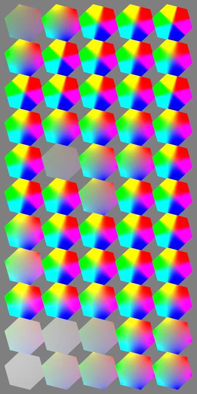

I'm wondering why, short of historical reason, does the
interpolation of weighted textures(pigment) is performed in the rgb
space.
Wouldn't it be possible to perform it in HSV or HSL space, even for
out of rgb <0,0,0> / rgb <1,1,1> block ?
And wouldn't the result be different and maybe more natural (or not ?)
Linear for SL/SV should be easy, but I'm still wondering about
interpolation of opposite hue: what would be the right solution ?
Could it be chosen per interpolation ?
Attached is a rgb interpolation of the polygon, with various
strength of mix.

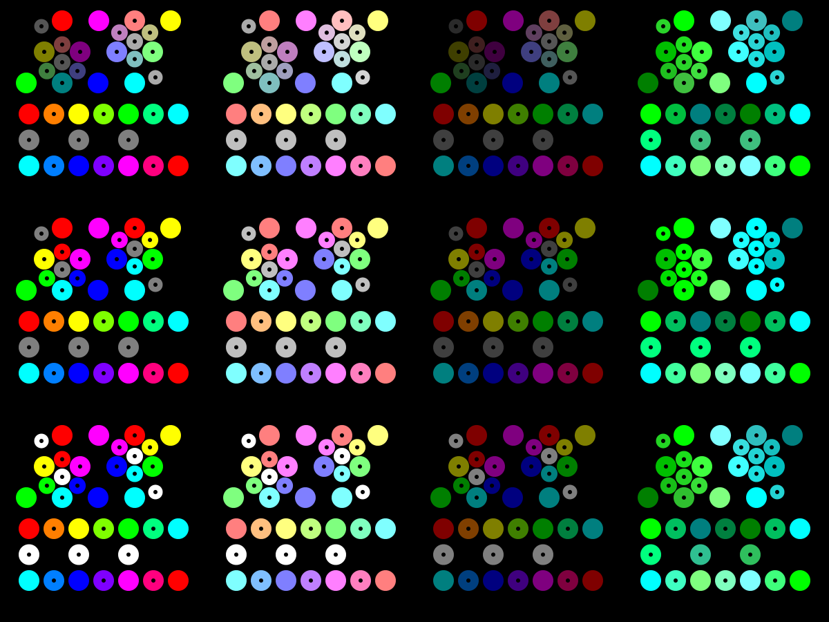

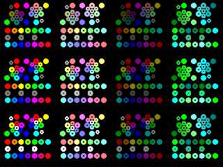

I had a try with RGB (the pov current way), HSL & HSV. (see attached
picture)
First row is RGB interpolation
Second HSL
Third HSV.
There is no point in trying YUV/YIQ/Secam/Pal/NTSC... colorspace as
they are matrix transformation of RGB, and as such keep the same result.
First column is Pure colours (<1,0,0>),
Second column is Light colours (<1,0.5,0.5>)
Third column is dark colours (0.5,0,0),
Fourth column is Green & Cyan, with dark & light.
The original colours are in full-disc.
The interpolated colours are in opened-disc, at mid-way between the
used colours. The center open-disc is the interpolation of the three
original colours. The opened-disc on the side is the interpolation
of the three first-level interpolation.
There is differences!
For the management of Shades, I prefer HSL: mixing dark & light
gives normal, which does not happen for HSV nor RGB!

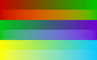

Oh I knocked up a quick program to interpolate between two colours in RGB
space and Yuv space.  In each pair, the top version is RGB, the lower
version is Yuv.
Actually, I just realised, you were probably thinking of the YUV signals
used in TV, that are just linear combinations of RGB.  I'm talking about the
CIE Yuv color space, revised in 1976 so that colours are spread equally in
the uv plane.  See:
http://hyperphysics.phy-astr.gsu.edu/hbase/vision/cie1976.html
Download 'interpolation comparison.png' (3 KB)
Preview of image 'interpolation comparison.png'

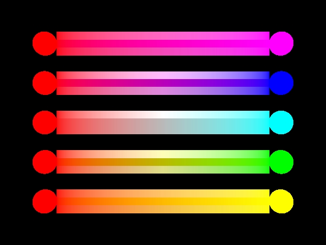

From: Trevor G Quayle
Subject: Re: texture interpolation... why rgb ?
Date: 29 Nov 2007 15:30:01
Message: <web.474f21112088bdecc150d4c10@news.povray.org>
> picture)
I've been having a look at this.  One problem in your graphic is the
interpolation of opposite colours in HSV and HSL.
You are basically interpolating linearly between individual H,S and V/L values.
The interpolation of H is done in the shortest direction around the
circumference. This poses a problem because there is no logical way to choose
the direction to interpolate H around the circumference, as both directions are
equal in length, so you have chosen to interpolate directly across the colour
space, which creates a discontinuity (eg: check the interpolation of
<1,0,0><0,1,1> compared to <1,0,0><0.001,1,1>, they should be virtually
indistinguishable, but the slight value added to the R value tips the shortest
route from being undefined to defined).  It would be far better to interploate
all colours directly across the colour space to remove this discontinuity.
A second problem I see is that this really only shows the halfway colour, and
not the full transition from one to the other.
The attached image shows interpolation between pure red and the other 5 pure
colours using interpolation across the colour space as described above.
top band: HSV
middle band: RGB

Here's some new mixes using different shades of red:
Top to bottom:
1. red to dark red
2. red to light red
3. dark red to light red
4. red to black
5. red to white
If there's any particular mix you want I can make an image for you, or I could
post the code.  The difficult trick in the interpolation is that you have to
convert the RGB to HSV/HSL(polar) to XYZ(cartesian) coordinates, interpolate
then convert back XYZ -> HSV/HSL -> RGB.
-tgq

Here's a better version of the original one without gamma f***ing it up.  (I
have to stop using PNG, it causes nothing but gamma problems for me).  You can
still see the big differences, particularly between red and green or blue.
The HSL doesn't look to bad here, but I still prefer the RGB (HSV is completely
out...)
-tgq

Here's an intersting take on this one.  The transitions are converted to
equal-weighting grayscale (r=g=b=0.333).
Of particular note is the transition from red to blue or green, where the gray
value increases then decreases for both the HSV and HSL, however not as
drastically for the HSL.
-tgq

One more interesting little experiment before I pack it in for the day.
Here I interpolated between pure Blue and Red, Green, and Gray with an
equivilant intesity (0.11).  The top shows it in colour and the bottom shows it
converted to grayscale via an external converter.
Here it can be clearly seen that the RGB interpolation retains constant
intensity, whereas the other two do not.
-tgq

From: scott
Date: 30 Nov 2007 04:32:24
Message: <474fd8a8$1@news.povray.org>
>> RGB space and Yuv space.  In each pair, the top version is RGB, the
>> lower version is Yuv.
>  The yuv interpolation doesn't look half-bad.
I realised an improvement though.
Although the "colour" part (u and v) is supposed to be interpolated evenly,
the Y part will not be.  Y is linear luminance, ie not gamma corrected, so
interpolating it directly will not give a very "even" looking result (there
will be too much "white").
So I modified the code to do this (now a black-white gradient looks
identical in both RGB and Yuv interpolation) and it looks a bit better,
especially when going from dark to light colours.  Again, top bar is RGB and
lower bar is Yuv.
Also, the problem with converting from RGB to Yuv and back is that it
assumes your display device is exactly calibrated to a standard (I used sRGB
in the calculations).  If it's not then the results won't look as good as
they could.
Download 'interpolation comparison 2.png' (3 KB)
Preview of image 'interpolation comparison 2.png'

I think this does present an interesting result.  Similar to the RGB gradient,
the colour luminance is constantly increasing or decreasing (unlike in HSV or
HSL where it tends to arc up or down past the final luminance and back again),
however following a different path of colour mix.
-tgq

The problem with the macro is that it can't be used in a function, which is what
I wanted.
Here is the pigment declaration for an HSV gradient:

here is a small experiment (real patched code), currently only for
polygon interpolation.
Still a little problem of green for degenerate hsv...
Next step, the blob 3D object...
Playing with ADC_bailout might be fun, if only it was per object and
not a global.

Download 'demo1.png' (87 KB) Download 'demo2.png' (72 KB) Download 'demo3.png' (72 KB) Download 'demo4.png' (98 KB) Download 'demo5.png' (86 KB)
Preview of image 'demo1.png'
Preview of image 'demo2.png'
Preview of image 'demo3.png'
Preview of image 'demo4.png'
Preview of image 'demo5.png'
