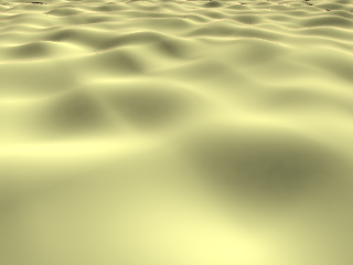

I thought I'd take another shot at a decent sand texture; this is the
result of my first pass. It has all sorts of things wrong with it, but
it's not a bad start. :-) I'm not so much aiming for photorealistic sand
as I'm shooting for something that people instantly recognize as sand.
Whenever anyone posts sand images up, people complain about not seeing
sand grains, even if the sand in question is so far away that you
wouldn't be able to see the sand grains. The general solution to this
seems to be to have some sort of patterning going on at just about the
pixel level, where you can just see that there is something going on,
but you can't really see what.
The problem that I've had with this is that you have to tune your
patterning to the resolution you're rendering at. If you render at a
lower resolution, the patterning disappears; if you render at a higher
resolution, the larger-than-realistic "sand grains" become glaringly
obvious.
This also marks the first time I've tried to do subsurface scattering. I
didn't realize just how easy it is to set up, actually.
BTW, does anybody know if it's possible to make subsurface scattering
and normal perturbations play well together?
William Tracy
You know you've been raytracing too long when you stop using a
protractor to measure angles because you can do it just by looking.
    -- Taps a.k.a. Tapio Vocadlo

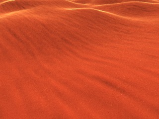

From: William Tracy
Subject: Re: Sand
Date: 22 Nov 2007 18:28:00
Message: <47461080@news.povray.org>
Hash: SHA1
I'm starting to come up with some stuff that I want to build sand
castles in. :-)
I'm starting to wonder if all my "details" are really helping or
hurting. Here's two renders, one with lots of yummy little patterns, and
one that's completely flat except for the subsurface scattering.
Speaking of subsurface scattering, just a little goes a long way. I
probably overdid the scattering media in these images, because
everything looks like its underwater. Which is still cool. ;-)
William Tracy
You know you've been raytracing too long when you thought the infamous
Book of Questions would have deeper stuff in it, like "If you could only
use one renderer, which would it be?', etc.

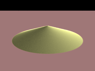

From: William Tracy
Subject: Re: Sand
Date: 22 Nov 2007 23:56:49
Message: <47465d91$1@news.povray.org>
Hash: SHA1
Mark Birch wrote:
> It's useless in animations, but have you tried the 'crand' option?
It works better than I expected, actually.
(...and sorry for not remembering to convert those other pictures to jpg
before uploading them.)
William Tracy

Sand is - at the same time - easy and complicated to do. Imo, your renders
look well. I suppose that the technique used depends on the type of scene
one wants to build and the effect one wants to convey. This means that there
is no definitive solution, or so I experienced myself. Using crand, like
Mark says, can help, although I do not particularly like it. Perhaps using
more contrast between the "grain" colors gives even better results. That, of
course, depends on the type of sand one wants to render.

I like these two images, individually. Is there a way that you could merge the
materials, with the grainy one in the foreground fading to the smooth one in the
midground?
Stephen

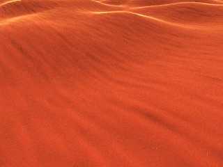

I used a kind of 'fadeaway' technique for my snow texture for TerraPOV, and I
posted recently and test render here. It is based on the distance wrt camera
(use of spherical pattern): when near it is one texture, when far it tends to
be a plain color (or whatever else). I intend to integrate fadeaway texturing
macros like this in TerraPOV, because terrain pigments become plain colors with
distance. Something like this can be applied to sand (same problem). It can also
be used for other purposes, of course.
Currently, it is coded as:
// Parameters:
//    _color
//        Color of the snow. Can be C_SNOW_COLOR_BLUEISH.
//    _distance
//        Distance where the texture becomes a plain color
//    _scale
//        Scale for the near aspect of the texture
#macro TP_SnowFadeaway (_color, _distance, _scale)
    #local _t = texture
        pigment_pattern {spherical scale _distance}
        texture_map
            [0 TP_FarSnow(_color)]
            [.8 TP_SparkleSnow(_color, _scale)]
            [1 TP_SparkleSnow(_color, _scale/3)]
    _t
#end
with TP_FarSnow() and TP_SparkleSnow() as other texture macros. This snow
texture is quite complex, but I think the result is OK.
I'll probablly define a general convenience macro with the following interface
#macro _tp_make_fadeway (_texture1, _texture2, _distance, _campos)
   // use of a more generic macro with thresholds and scales
#end
If this can help...
    Bruno

But the one you realized is more impressive.
Paolo

Another possibility, I guess, would be to use the boxed or the cylindrical
patterns. Maybe cylindrical would be better than spherical in a landscape?
What do you think?
From: Trevor G Quayle
Subject: Re: Sand
Date: 23 Nov 2007 11:50:00
Message: <web.47470378ee83a16cc150d4c10@news.povray.org>
Looking pretty good.  Sand can be a difficult thing to simulate.  God idea
trying some SSS with it.
A few things you can try too.
-as stated before, maybe don't use a uniform colour, but have a patterned
varition as real sand tends to be
-maybe try different normal types: instead of granite or bumps, you may get
better result using either a solid crackle, or cells pattern.  This will give
you flat surfaces with varying normals, and sharp transitions betwen rather
than the continuous transitions of other types.  You can also colour (or
texture) map in cordination with the pattern used.  You may need good AA though
to get nice results.
keep up the good work.
-tgq

I've been looking at this scene:
http://www.irtc.org/ftp/pub/stills/2004-08-31/em_giza.jpg
My sand texture is already better than that ;-) but I need to look into
how the sloping sand shapes at the base of the pyramids was done. My
geometry is still pretty hacked-together.
Bruno Cabasson wrote:
> I was busy in RL those two last weeks and could not read much here. William,
> your work seems very interesting. Would you mind, when achieved or partial,
> sharing things so that I can integrate this nice stuff in TerraPOV?
Cool, is it that good? :-)
Anyway, for anyone who wants to play around, here's I have so far, minus
the heightfield. As others have pointed out, there's a bunch of ways to
improve this. :-)
You'll probably want to tweak the colors and the media (right now I have
it set up for red sand), and you'll probably have to play with scaling
the bozo map (the extra special sand grains) to fit your scene.
Finally, a heads-up that terrain with SSS can take a while to render.
:-) On a ~2GHz processor, the little bitty images I've been rendering
take about 30 seconds.
> What do you think?
The last time I was working on my "Alien Desert" image (which will
eventually use my improved sand...), I used a boxed pattern as
described. I had a bozo pattern for sand grains in the foreground, and
solid in the background.
The transition between the two was far enough away where you couldn't
even tell the difference between the two textures, so I don't know how
useful it would be for creating smooth transitions.
But it did make a big improvement in my render times. :-) Having bozo
all over a virtually limitless heightfield is slow. (I can't wait to see
how much slower SSS is!)
Very good idea.
Take a peek at the code I posted farther up in the thread. Normals
aren't really helpful here, because the surface is transparent. :-(
Early on I tried normals on the solid surface *below* the SSS, but that
made the patterns only visible on the dark side of the sand dunes, which
is why my first screenshots were all backlit. :-)
Oddly enough, crand *does* work on a transparent surface. I'm still on
the fence whether that's a good long-term solution.
Heh, you have no idea how I abuse AA. :-) I've posted images here before
with textures that look gorgeous under 0.1 AA, but which look like vomit
on the screen without AA. ;-)

Ah right, I see what you mean.  Forgot about the SSS.  Still, maybe try to use
the crackle or cell pattern for your density instead.
-tgq
Subject: Re: Sand
Date: 23 Nov 2007 15:25:00
Message: <web.474736c6ee83a16cc150d4c10@news.povray.org>
Some further thoughts on this.
Maybe you can still use normals, but try adding fresnel (or variable)
reflection.
Have a look at this photo: http://www.benzor.com/misc/desert.jpg
Part of the colouring and look of the sand appears to come from actual specular
reflection.
-tgq

With the example William provided above, the cells pattern gives an
excellent result!
Subject: Re: Sand
Date: 24 Nov 2007 04:19:33
Message: <4747eca5@news.povray.org>
"Thomas de Groot" <t.d### [at] internlDOTnet> schreef in bericht
news:4747ebe9$1@news.povray.org...
> excellent result!
I forgot to say that I changed the scale to 0.0005 too, but that may vary
with the scene involved.
Good work William!
