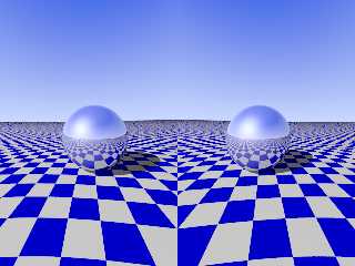

Here's a different approach to stereoscopic imaging without having to parse
twice or use the clock setting. I don't know enough about lenses but I think
someone might be able to tweak this to work correctly. I used a repeated
spherical camera normal to get 2 images.

From: sooperFoX
Subject: Re: Single Parse Stereoscopic?
Date: 19 Nov 2007 07:45:00
Message: <web.474184b5f2015f4b943b35b60@news.povray.org>
Hi Nekar,
I am not a photographer (nor very advanced with pov camera) so I could not give
you any _technical_ advice but I think for this to work you'll either need to
move the camera *waaay* back and use a narrow camera angle, or use a different
type of projection because the radial angular perspective distortion ruins the
effect somewhat.
When looking at the image "wall-eyed" I notice that there is a little depth
information near the centre of the image (i.e. it works pretty well for the
sphere and its reflection), but as you get further out to the edges (and
particularly noticeable on the horizontal lines), the curvature distortion is
misaligned between the two images and the brain really struggles to find a
correlation on the two halves, and it becomes very 'distracting'.
I think it is perhaps because of the symmetrical effect in the curvature (it
looks like the distortion is 'mirrored'). If you could find a way to not mirror
the warp/normal but instead clone it from one side of the vertical axis to the
other (-x to +x) that might work. I'm sorry that I don't know enough about the
warp or the spherical pattern to actually help you HOW to do this. This is all
just my observation.
Frankly I am very impressed that it works! I think your theory is more than
halfway there and with some fine-tuning could have application.
Have you thought about modelling how a real stereoscopic camera might work? I.e.
four planar mirrors, two for each 'eye', angled just right so as to split and
spatially separate the viewport down the middle?
E.g. one half of the rays would hit the first mirror and bounce off to the left,
then get reflected back to the intended focal point, only their origin would be
slightly left of the camera's location, and the other half would hit the third
mirror and bounce off to the fourth, and be reflected back to the same focal
point, this time from the right. You should be able to use some geometry to
figure out the angle required for each of the two mirrors on one side, then
just flip it for the other side. Or, maybe you wanted to avoid this altogether
and try another method! :)
Anyway I hope I have helped in some small way, if you're not totally confused by
my non-technical understanding of this... :)
sooperFoX

I was just thinking about this some more.. I think it has to do with the
spherical normal to begin with. It looks like the 'splitting' of the viewport
is happening OK (thanks to the warp I presume) but the spherical nature of the
normal is what is causing the distortion.
What if you tried a gradient, something like (forgive my syntax, I don't have
POV in front of me)
gradient x
normal_map {
[0.0 <1, -1>]
[0.5 <0, -1>]
[0.5 <0,  1>]
[1.0 <1,  1>]
translate -0.5*x
...or similar. I have absolutely no idea how you would focus something like that
though! Perhaps some clever scaling.. hehehe
Just throwin' it out there.
sooperFoX
P.S. the more I think about it, the more it seems like just trying to find a
"short-cut" for the method I described at the end of my last post.. maybe
prisms instead of mirrors though.. hmmm

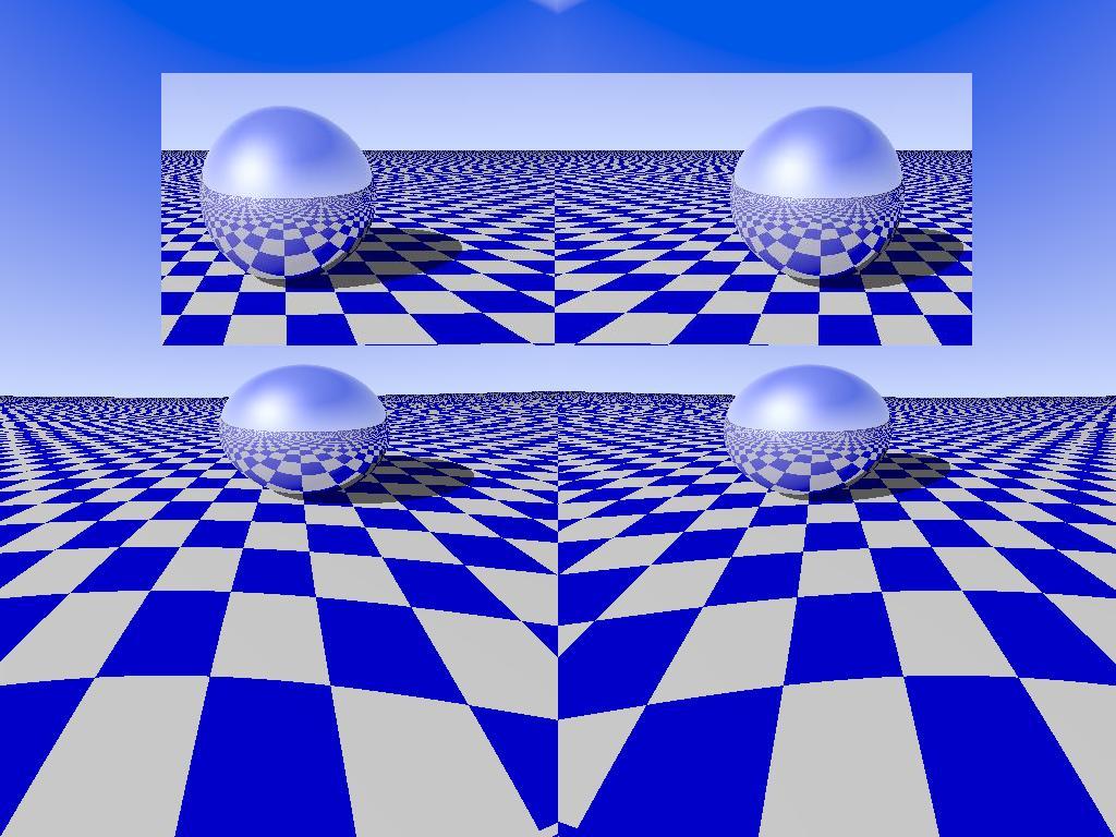

Try with this camera:
camera {
   right x*image_width/image_height/3 //Otherwise, the sphere is
//stretched verticaly, a lot!
   location  <0.0, 0.5, -4.0>
   look_at   z
           normal {cylindrical 0.5/*scale <10,10,01>*/ translate <.5,.5,-.5>
//pattern modifier
           warp {
                     repeat x           // repeat direction
                 translate -.5*y
                 scale <.7,.7,10>
   angle 60 // to keep the sphere images from drifting apart
This camera get rid of the spherical distortion.
Good for parallel vewing.

I can't make any useful suggestions, I just complain ;)
In the upper picture
Alains' version seems to stretch the spheres toward the center
the spheres are curves on the outside edges, but stretched toward the center.
In the lower picture
Nekar's version seems to compress the sphere from the top
Leef_me

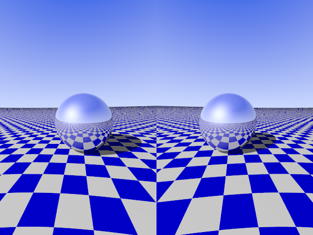

From: William Tracy
Date: 20 Nov 2007 00:58:10
Message: <47427772$1@news.povray.org>
Hash: SHA1
Your images keep giving me the feeling of the "cameras" being too far apart.
Anyway, here's someone who's successfully done what you're trying to do:
http://www.irtc.org/ftp/pub/stills/1998-02-28/dpatrol.jpg
http://www.irtc.org/ftp/pub/stills/1998-02-28/dpatrol.txt
William Tracy

From: Nekar Xenos
Date: 20 Nov 2007 01:15:47
Message: <47427b93@news.povray.org>
"Leef_me" <nomail@nomail> wrote in message
news:web.4741f3fcf2015f4b2a7b15450@news.povray.org...
> center.
> Leef_me
changing the scale in the camera to <.8,1,10>"looks a lot better now
-Nekar Xenos-
Date: 20 Nov 2007 09:58:03
Message: <4742f5fb$1@news.povray.org>
Nekar Xenos nous apporta ses lumieres en ce 2007/11/20 09:35:
> "scott" <sco### [at] laptopcom> wrote in message
> news:4742e4d6$1@news.povray.org...
>> Yeh, I was going to suggest that method too, we had a real digital camera
>> lying around here somewhere with an attachment like that on it,
>> specifically for taking photos to be shown on a 3D display.
> This is very good but if the intent is for animation camera normal is
> faster, so I would like to stick to the camera normal.
Try this one:
camera {
   location  <0.0, 0.5, -8.0>
   look_at   z
           normal {marble -0.8 translate <.5,.5,-.5>  }
   angle 60
This get rid of the distortions as marble have a triangular shape. Also, it's
repeating, so you no longer need the repeat warp. It act like a pair of
achromatic prisms instead as a pair of shifted lences.
Fundamentalism: If shit happens to a televangelist, it's okay.
From: Bill Pragnell
Date: 20 Nov 2007 10:40:01
Message: <web.4742ff6cf2015f4b731f01d10@news.povray.org>
Alain <ele### [at] netscapenet> wrote:
> Try this one:
[snip camera]
That's much better, the previous versions were all slightly fuzzy and gave me a
bit of a headache. This new camera does the job much more effectively; the
composite image is much sharper.
When I render it, there is a glass-like vertical boundary at the sides of each
image - what causes this?
Cross-Eyed Bill

From: Trevor G Quayle
Date: 20 Nov 2007 14:55:01
Message: <web.47433b90f2015f4bc150d4c10@news.povray.org>
I wrote a macro many years ago (2001) that uses mirrors to create a stereoscopic
effect to some success.
Here is a modern render using it.
-tgq
Date: 21 Nov 2007 08:40:02
Message: <web.4744352ef2015f4bc150d4c10@news.povray.org>
"Leef_me" <nomail@nomail> wrote:
> > -tgq
> VERY NICE.
> Would you be willing to share your work with the rest of the class?
> Leef_me
> (muttering to self)     very nice indeed...
Certainly.  I thought I had posted it way back then, but I can seem to find it
on the boards now...
Anyways, I'll post the macro file and sample scene file in p.b.sf to be picked
apart.
The sample scene file doesn't use the my HDRI light system as the posted image
does as people may not have it or may not have megaPOV installed for it.  If
you want to use it, find it in the p.b.sf group
(http://news.povray.org/povray.binaries.scene-files/message/%3Cweb.46488bca4e05d400c150d4c10%40news.povray.org%3E/#%3Cw
eb.46488bca4e05d400c150d4c10%40news.povray.org%3E)
For the macro, you set the number of views you want and the spacing of the
cameras.  The camera viewing angle is calculated from this.  (To get a wider
view, you have to spac the cameras further apart, not further away).
This macro is not particularly suited to large scenes as the object or scene
being viewed has to be declared as a single object to be passed to the macro.
The macro works by placing the camera at the look_at location, and surrounding
it with mirrors reflecting directly back at it with appropriate spacing based
on the variables.  This means that the camera is potentially inside the viewing
object, which is why it needs to be declared and given a "no_image" flag so the
camera can see out of it.
Anyways, have a look and make any adjustments or changes as needed.
-tgq
Date: 22 Nov 2007 13:55:01
Message: <web.4745cf58f2015f4bc150d4c10@news.povray.org>
The images and macro I've done so far is for parallel viewing which has some
limitations compared to cross viewing.  Unless you are capable of diverging
your eyes, the actual image spacing needs to be smaller than your actual eye
spacing, which means the object has to be smaller.
For parallel viewing, it is quite simple to set up with mirrors.  You can either
do it like in the other post with diverging mirrors, or the way I did it.  I
think it is possible to do cross-eyed with mirrors, but it would be much more
complex with more maths and mirros to get the images to cross over.  However,
megaPOV has a camera_view pigment.  With this, you just look orthagonally at a
couple of boxes, and map the viewing mirrors as pigments on them.  Not sure if
this feature is to get extended to POV4 (or maybe 3.7...), but it is very
useful for doing single pass stereoscopics (amongst other things).  Without
this, you caould always write a 3-part animation, one pass for each eye, then
the third pass to combine them.
Here is a sample cross-eye render pair to try out.  If you are interested, I can
post the macro for the camera, it is very simple and very simple to implement.
You can also use it directly in a scene, as you don't need to predeclare and
pass the viewing objects.
-tgq
