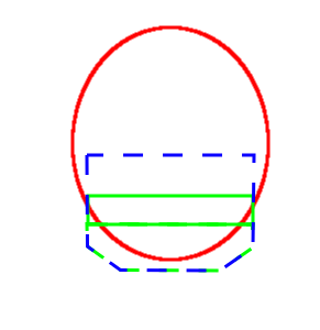

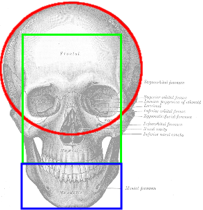

After a six-week break, I returned to my self portrait project... as I
firstly try to do a "cheap" (in terms of rendering time) CSG version, I
started with a "skull ellipsoid" to which I would like to add face with
upper jaw and an animatable mandible, as displayed in the three
schematical drawings below.
The radii of the "skull ellipsoid" (centered at the origin) are as
follows: <0.115, 0.108, 0.138>
To fit the front parts in, I vertically sliced off the skull shell at
z=-0.097. Now I have to determine the width of the cut surface at y=0.
With a non-stretched sphere, that would be easy:
sqrt(radius^2-0.097^2)*2*radius - but how to transfer this to an
ellipsoid? To determine the exact radius length at the intersection of x
axis, cutoff box and ellipsoid, I would have to know its angle with the
z axis...
See you in Khyberspace!
Yadgar

Hi Yadgar.
Doesn't seem to difficult (but maybe I missed something?)
The equation of your ellipsoid is:
(x/0.115)^2 + (y/0.108)^2 + (z/0.138)^2 - 1 = 0
The cut surface z==-0.097 is an ellipse, with equation:
(x/0.115)^2 + (y/0.108)^2 + (0.097 /0.138)^2 - 1 = 0
the width at y=0 is given by:
(x/0.115)^2 + (0.097 /0.138)^2 - 1 = 0
<=> |x| = 0.115 * sqrt ( 1 - (0.097 /0.138)^2)
so width = 2 * 0.115 * sqrt ( 1 - (0.097 /0.138)^2)
Hope this helps...

Can't you just use a sphere, fit the other part to it
and then scale it all along an axis so that the sphere
becomes an ellipsoid ?
Tor Olav

From: Jörg 'Yadgar' Bleimann
Subject: Re: Geometrical Problem
Date: 7 Oct 2007 13:51:23
Message: <47091c9b$1@news.povray.org>
High!
Meanwhile, I found out a different solution:
as the length of the secant of a circle or ellipse decreases with
increasing distance to its center point proportionally with the cosine
of the arcus-sine of distance/radius, the searched length here is
0.115*2*cos(asin(0.097/0.138)) = 0.163596726 !
But nevertheless, thank you!
Yadgar

a little more complicated formula, but the same result, since
(cos(asin(x)))^2= 1-x^2

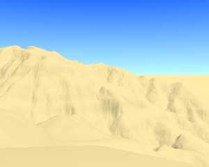

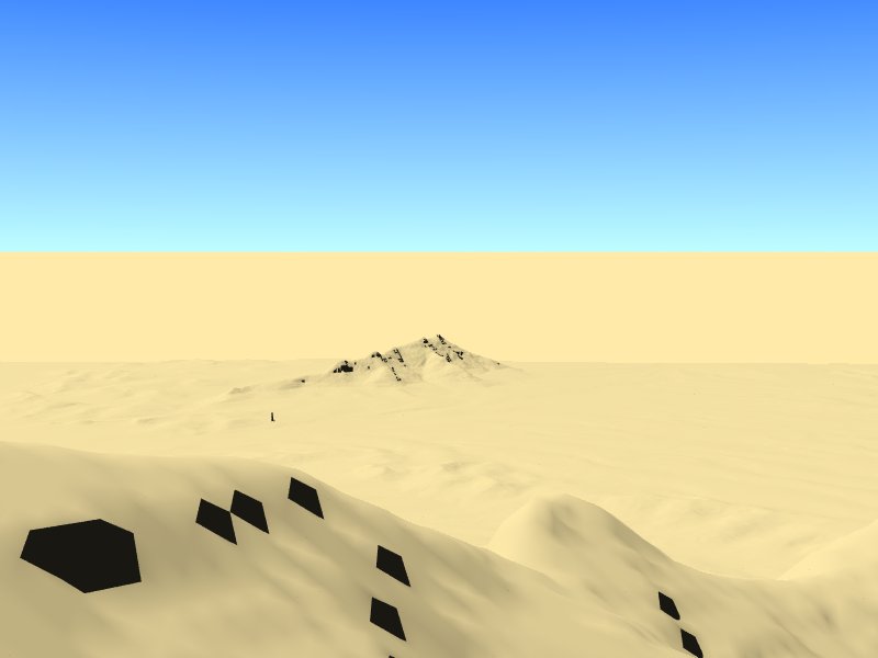

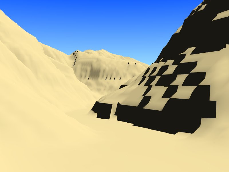

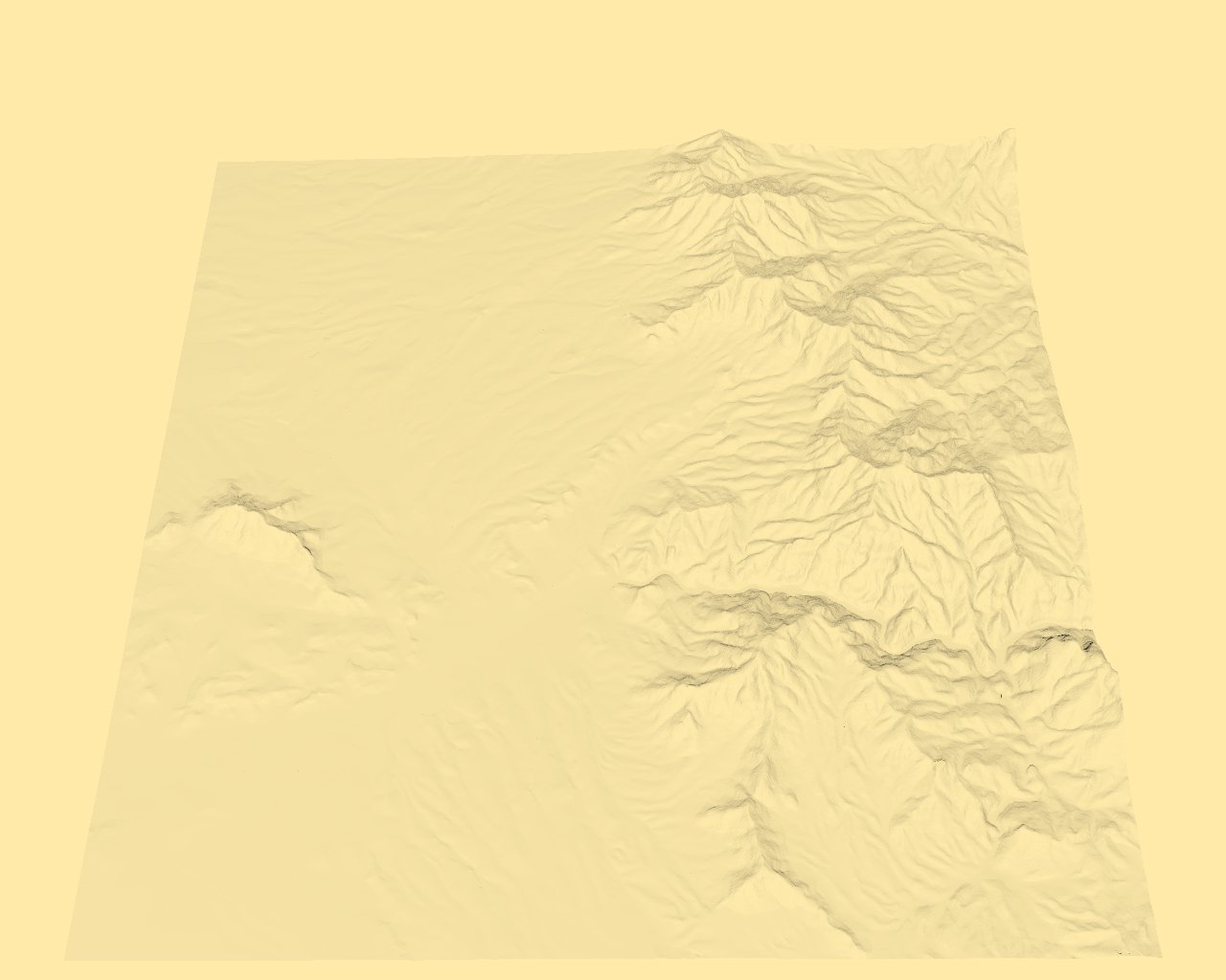

Khyberspace is a general term for "virtual Afghanistan", Afghanistan
(preferably the pre-war country before 1978, but also alternate history
concepts or even future extrapolation from the current state) as a
virtual world, either as a "primitive" text-based version like seen in
Multi User Dungeons (MUDs), a (more or less) photo-realistic 3D world
(that's where PoV-Ray would be used) or even a realtime-navigable 3D
world based on VRML/X3D.
Full-blown Khyberspace would be an immense task, since modeling a whole
country of about 650,000 square kilometres at a reasonable level of
detail also in "pedestrian" views would take tens of thousands of
programming years, let alone populating it with credible Afghan
characters (ideally avatars... er, afghatars played by human users of
Khyberspace, not just stupid computer-generated creatures).

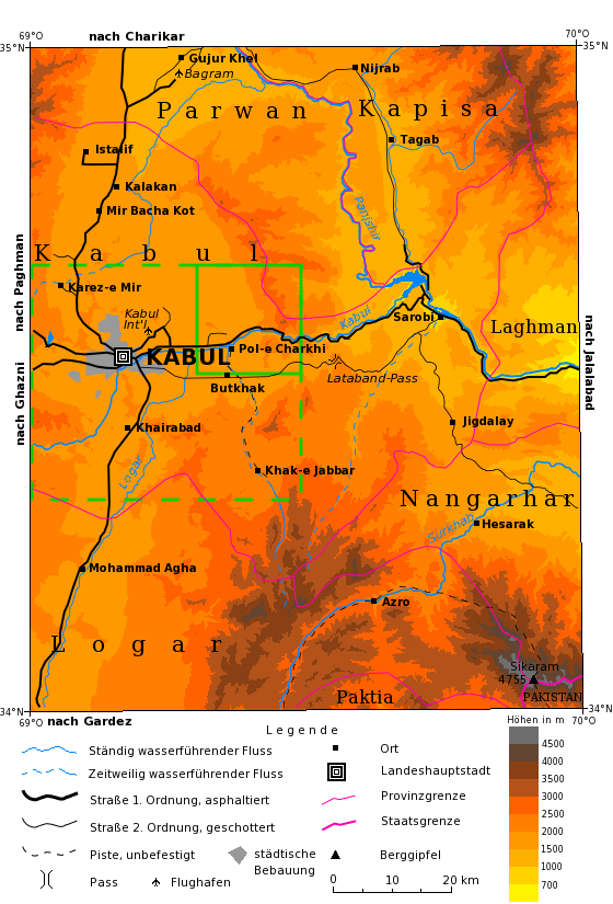

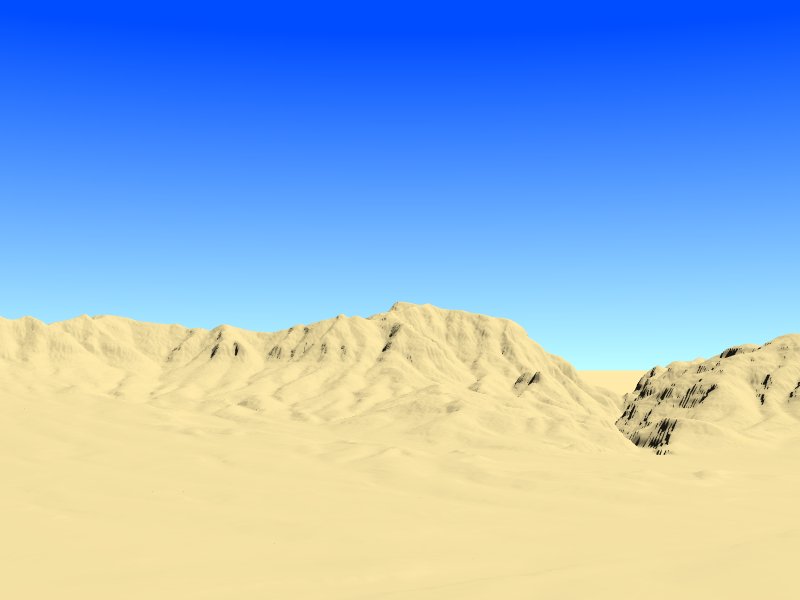

Three years ago, I started with Kabul (the capital) and its nearer
surroundings by manually pixeling a high-resolution heightfield from a
topographical map (attached here some recent renderings and maps - still
very crude!)... unless I find people to join me, there would be some
chance to finish at least the city until 2050...
Yadgar
