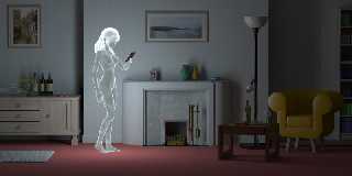

I've been playing with my IRTC entry from last year (the one that's
still on the IRTC home page!), with an end to putting a poster of it on
Zazzle. This will take some time, because I suspect it should be R-rated
in deference to Zazzle's slightly OTT content guidelines and, as I
previously mentioned, there is an issue with UK credit cards for age
validation at the moment.
However, I'm happy with the image itself, so I thought I'd post a
reduced version here. It differs from the original in several ways.
Firstly, I've completely changed the lighting. Radiosity is still used,
but only to deepen the shadows; the light is now cast be two crossed
area_lights roughly the same size as the ghost. This has the effect of
making everything much smoother, and does away with the lighting
artifacts. Secondly, and slightly more trivially, I've added some
objects in the room to provide a more detailed scene.

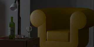

My only real issue is the photons used on the glasses and bottles in the
corner (see detail image). It looks better with than without, but
doesn't quite look like the ghost is causing them, despite using the
area_light keyword in the light source's photons block.
Anyway, hope y'all like the images.
Bill

Subject: Re: IRTC entry revisited
Date: 4 Oct 2007 09:33:25
Message: <4704eba5$1@news.povray.org>
A magnificent image, Bill. The lighting is very smooth and very convincing.
I certainly like the photons, although indeed it seems difficult to relate
them to the ghost, but on the other hand, without, the scene would be less
'interesting'.

From: alphaQuad
Date: 4 Oct 2007 18:10:00
Message: <web.470563d8ae3c8c78e2a7b7450@news.povray.org>
> Bill
I am speechless.
Except, how am I going to learn this ghost effect? Please maybe?
aQ

From: Stephen
Date: 5 Oct 2007 09:30:01
Message: <web.47063badae3c8c78726bd13c0@news.povray.org>
[snip]
I think that this is looking better and better.
But thinking about it, it seems to me that the ghost is emitting too much
light and you can see too much from here glow. (She must have over done her
Weetabix:) To be this bright I think you would need your night vision and
that would mean loosing the colour from the scene. Or you could add an
external light that was seeping into the room and slightly illuminating it.
Stephen

From: Bill Pragnell
Date: 8 Oct 2007 10:45:00
Message: <web.470a4217ae3c8c78731f01d10@news.povray.org>
"alphaQuad" <alp### [at] earthlinknet> wrote:
> I am speechless.
I'll take that as a positive comment! :)
Well, it wasn't that easy to be honest. I took the DAZ model, posed it and
exported it as a .obj file. Then I opened it in Blender, plugged any holes
(mainly in the face), shrank it very slightly along its normals, then saved
it as a separate .obj file. Now I have two copies of the mesh, one very
slightly smaller than the other.
Next, I converted them to POV-Ray using PoseRay, and put them together as a
union. The inner mesh was textured a dark blue, and the outer mesh was made
transparent and filled with emitting media. In this way, you get a thin
shell over the mesh surface that is brighter at grazing angles because of
the additional viewing ray length, giving a glowing outline effect.
If desired, the inner mesh can be differenced from the outer mesh, then the
ghost will be fully transparent. Making the mesh fully closed is important,
otherwise holes will show up as saturated by the media colour. It's also
important to scale the mesh along its normals - using scale in POV-Ray will
not work.
The hair was imported into POV-Ray as a separate mesh and completely filled
with the same media.
(there may be a simpler way to do this with clever pigments, but I'm not
sure...)
Bill

> more as a ghost (not that she doesn't now).
The look I was going for all along, before I even knew if the ghost would
work or not, was of the ghost being the *only* light source in the scene, a
proper pitch-black environment. I guess this variation would make her look
more ghostly in a kind of indistinct way - she should probably be
transparent if I tried this version... hmm, perhaps I will give it a go.
Render times for the large version (4800x2000) are only a day or two and
this would probably be quicker because I wouldn't need big fat area_lights
any more. Although I would have to crank up the radiosity settings a bit.
I'll get back to you!
I have done a daylight version too, although I used a 'live' subject in that
and not a ghost.
> > Weetabix:)
>    LOL!  :)  Did you mean her 'Ready Brek'?
Yep, she died of a breakfast cereal overdose. You heard it here first. :)
Bill
From: Kyle
Date: 8 Oct 2007 11:54:57
Message: <9jkkg3psqrnen51d5t1srjho152g024avc@4ax.com>
On Mon,  8 Oct 2007 10:43:35 EDT, "Bill Pragnell" <bil### [at] hotmailcom> wrote:
>not work.
>sure...)
Wow, I thought you were just using the slope pattern.
From: Bill Pragnell
Date: 8 Oct 2007 14:05:00
Message: <web.470a7131ae3c8c78403037120@news.povray.org>
I take it you mean with a camera ray as the direction vector? It looks
subtly different... no matter how you tweak it, the effect is reminiscent
of lighting, and I wanted the ghost to look a little more ethereal.
I agree the technique does seem a little overkill! :)
