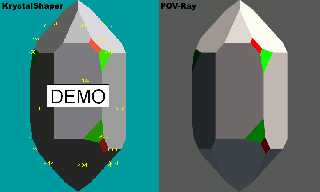

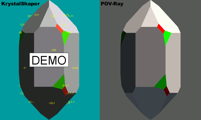

Hi everyone!
No amazing eye candy to show you, but I have resolved the issues
surrounding my inability to accurately depict odd angles for certain
crystal morphologies.
Attached is a png image showing both a screenshot from KrystalShaper,
and a corresponding crystal shape rendered with POV-Ray. The problem
areas are highlighted in red and green.
I used exact angles and distances for this test. My reproduction seems
100% accurate, which means I can go on to create a library of minerals
with support for randomized distances. A tutorial describing the
technique may also be possible (although I still have that Weathered
Surfaces tutorial to finish).
Questions or comments are always welcome!
Sam
Download 'quartz.png' (10 KB)
Preview of image 'quartz.png'

From: Samuel Benge
Subject: Re: quartz (9.02kb png)
Date: 23 Aug 2007 19:10:19
Message: <46ce13db@news.povray.org>
Tim Attwood wrote:
> Cool, I saw your hexagon and was messing with
> Miller indices, and I found this site
> http://www.gly.uga.edu/schroeder/geol6550/millerindices.html
> which seems to explain simple Miller indices OK.
> Still haven't looked at Miller-Bravais indices.
> This is what I ended up with, but it's mostly untested.
I tried your macros, but they doesn't work for hexagonal structures.
They may work for cubic systems, but I still have yet to test 'em.
One would have to specify the so-called "unit cube" to work with other
crystal systems, in order to get the other axes right. Thanks for
contributing!
Sam

From: Samuel Benge
Date: 23 Aug 2007 19:34:25
Message: <46ce1981$1@news.povray.org>
Bill Pragnell wrote:
> Having thunk about it a little, I think one problem with using the Miller
> indices directly is that the x,y,z axes are not always orthogonal in
> crystal structures. For example, the x and y axes in the hexagonal system
> are not at right angles to one another, but at 120º; although the z axis is
> perpendicular to them both. This goes for other structures too - e.g.
> rhombohedral and monoclinic are bound to suffer similar problems. You might
> have more luck with this approach for cubic systems.
I agree with everything you just said. All my (limited) research into
this area seems to point to the simple fact that:
> you could always define axis vectors for the different systems and
> use them instead of the regular coordinate vectors.
But I don't know how to implement this just yet. It *should* be as easy
as offsetting a direction with and angle (eg. 120°), but I still have
yet to get it to work.
> On the other hand, you seem to be producing pretty nice crystal shapes with
> your current method, so who am I to meddle with your productivity! :-)
I think *any* crystal can be accurately depicted with this method, so
you could say I'm happy with it :) Punching in Miller indices would be
much easier, but hey, at least I can still squeeze geometry from that
demo version of KrystalShaper :)
> Let's see some more renders like that first one
I'll be making more, you can count on it :D
Sam
