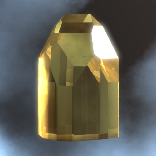

Hi everyone,
I discovered a way to accurately depict minerals with POV-Ray. I found a
demo version of a program called KrystalShaper
(http://www.jcrystal.com/products/krystalshaper/) which allows one to
view various crystal morphologies for different minerals. The demo
version does not allow you to save or export, but you can view the
Miller indices (http://en.wikipedia.org/wiki/Miller_index) of a
crystal's faces, and determine the angle between them.
Using the angles acquired from the program, I made an intersection of
planes to create the crystal. It would not be too difficult to randomize
the result to make unique, natural-looking specimens.
The render itself is nothing amazing, but the possibilities represented
by it are exciting!
Questions and comments, welcome as always!
Sam
Download 'topaz.jpg' (84 KB)
Preview of image 'topaz.jpg'
From: Bill Pragnell
Subject: Re: topaz (84k jpg)
Date: 22 Aug 2007 05:50:00
Message: <web.46cc06481b274c68731f01d10@news.povray.org>
Nice image, all the nicer for the colour bleeding!
Surely the Miller indices define the crystal planes, so you can use them
directly to define your intersection planes (i.e., no knowledge of angles
required)?
Bill
From: Jim Charter
Date: 22 Aug 2007 09:21:12
Message: <46cc3848$1@news.povray.org>
Samuel Benge wrote:
> Hi everyone,
> by it are exciting!
> Sam
Actually I thought the render itself *was* pretty amazing.

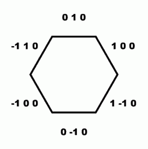

From: Samuel Benge
Date: 22 Aug 2007 15:33:32
Message: <46cc8f8c@news.povray.org>
Thanks!
Yes....
> so you can use them
> required)?
No. I wish that were true, because it would make everything much easier.
Now, it *might* be true for cubic crystal systems, but I have to check
on that. For hexagonal systems that theory just doesn't hold.
Look at the attached image. If we were talking just straight normals
here, the numbers would be decimals or very large integers. Instead, we
have angles represented by three small integers, ranging between -1 and
1 (they can be higher, I've seen them as high as 6).
I don't understand how the Miller indices work, but I know it has to do
with how molecules in the crystal are offset from one another. The
Wikipedia article just confused me, as I have no formal training in
higher mathematics.
If you have a way to calculate the normals for single faces (not the
angle between two faces), by all means, let me know! Otherwise, I'm off
to try the answer via Google....
Sam

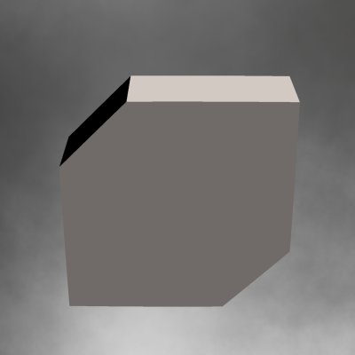

From: Samuel Benge
Date: 22 Aug 2007 17:57:44
Message: <46ccb158@news.povray.org>
Alain wrote:
> Samuel Benge nous apporta ses lumieres en ce 2007/08/22 15:34:
>> off to try the answer via Google....
> intersection{
> plane{Miler_indice, 1}
> material{...}
Attached is an image demonstrating the result of that approach.
Here is the code:
intersection{
  plane{z,1}
  plane{-z,1}
  plane{<0,-1,0>,3 }
  plane{<1,-1,0>,3 }
  plane{<1,0,0>,3 }
  plane{<0,1,0>,3 }
  plane{<-1,1,0>,3 }
  plane{<-1,0,0>,3 }
  pigment{rgb .5}
See the problem? These indices were supposed to make a hexagon, but
instead produced 90 and 45 degree angles. Am I missing something?
Sam
Download 'wrong.jpg' (7 KB)
Preview of image 'wrong.jpg'

> Thanks! I thought I overdid the glare.... it's approaching soap-opera
> proportions :)

Great pic. Phear the Topaz bullet!
How did you do the background?
> Thanks!
> Yes....
>> so you can use them
>> required)?
> higher mathematics.
> Sam
	From your example image:
intersection {
   plane {
      Miller.x * <1/sqrt (2), 0.5, 0> + Miller.y * <0, 1, 0>,
      1 / sqrt (2)
	But I don't know how the third number works, nor if it will hold
for Miller values other than +/-1...
		Jerome
