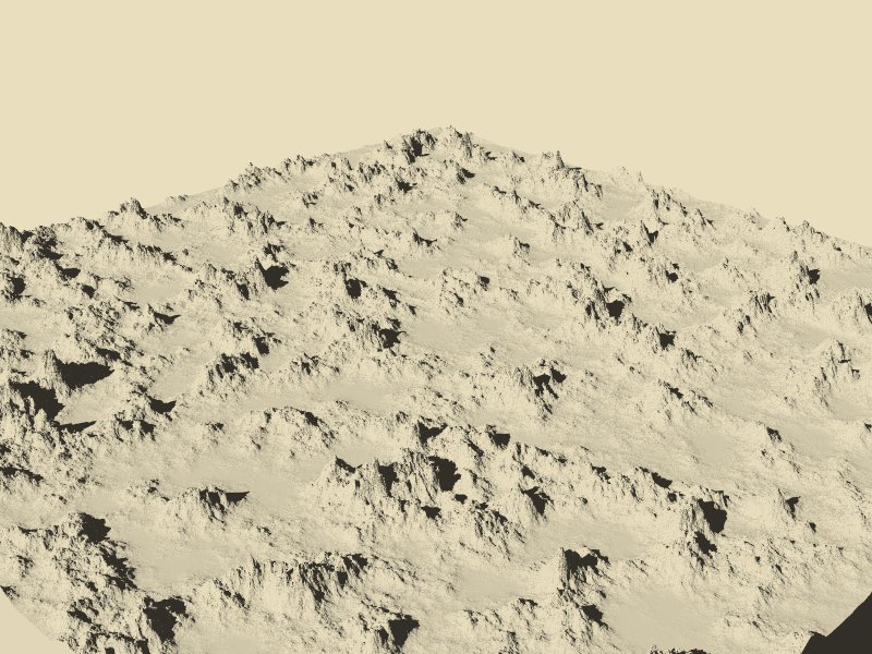

During the last months, I experimented with various isosurface (and
pattern) functions to generate realistic-looking landscapes. To
"navigate" around these landscapes (e. g. for placing cameras or, in the
future, trees or buildings) I found it necessary to have an orthographic
map view of the terrain at different scales.

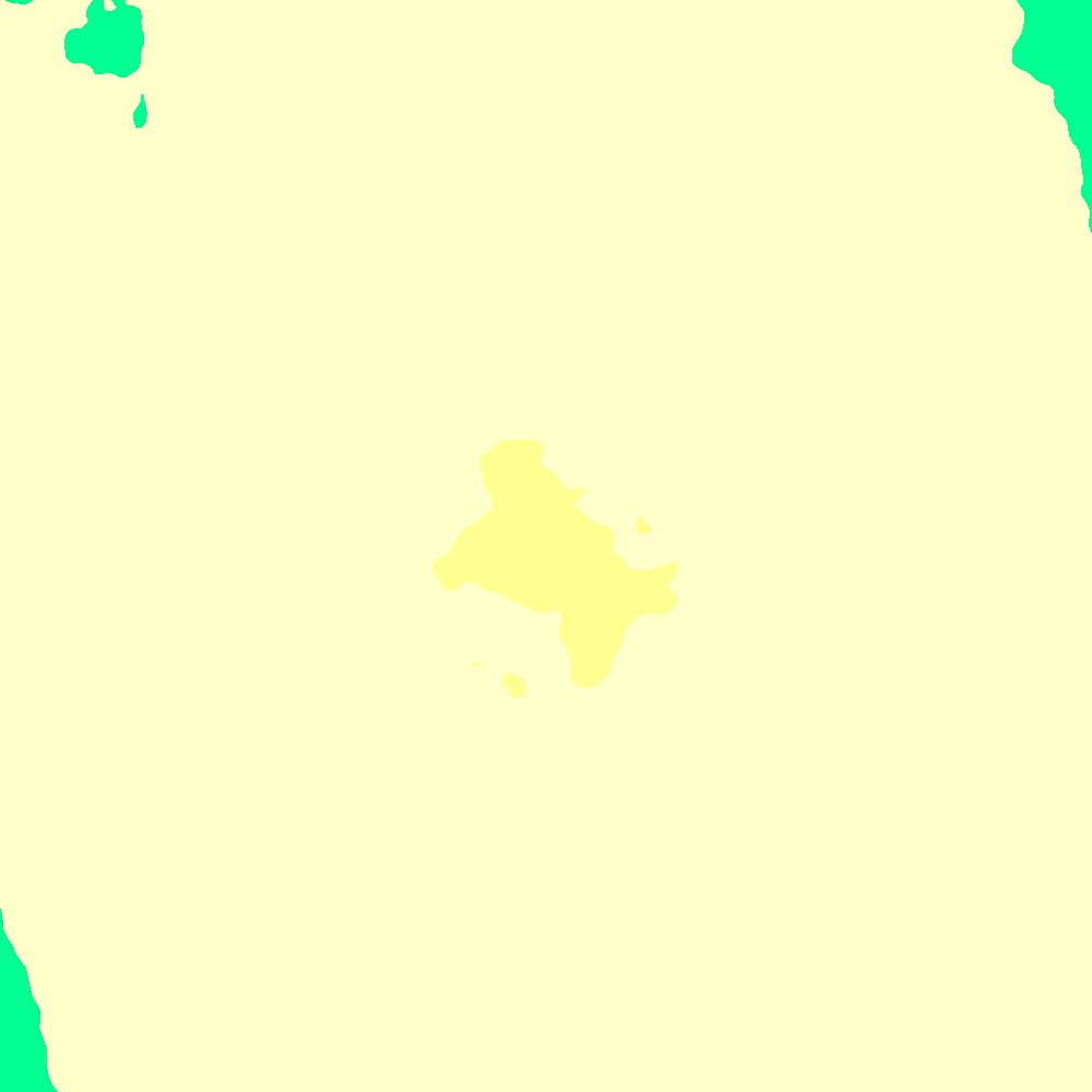

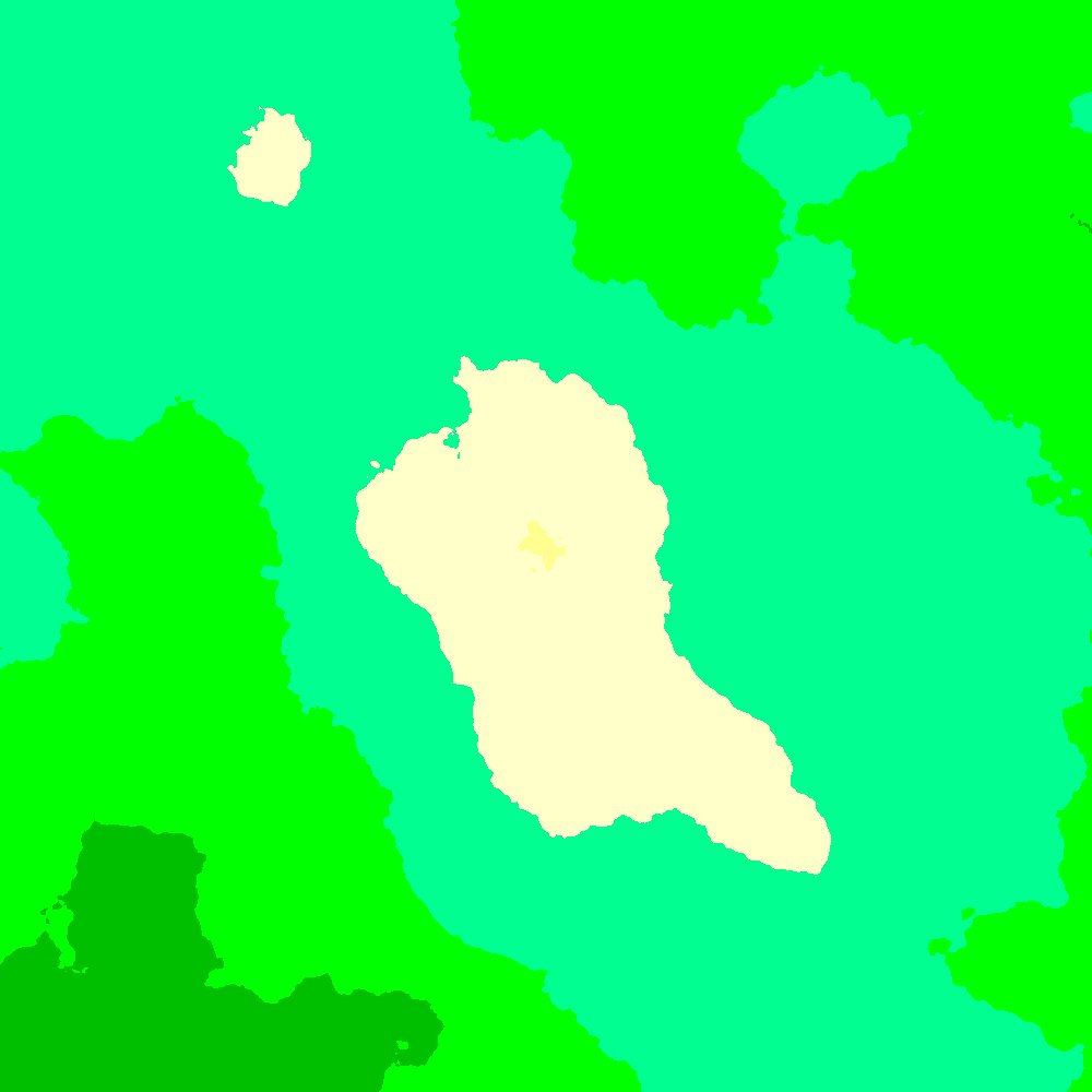

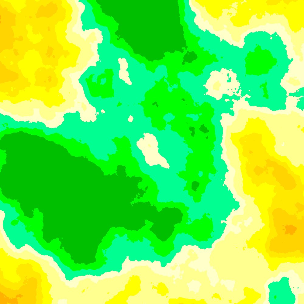

But at very large scales such as 1 by 1 kilometres (whis equals to 1
metre/pixel at my favourite rendering resolution - see last attachment)

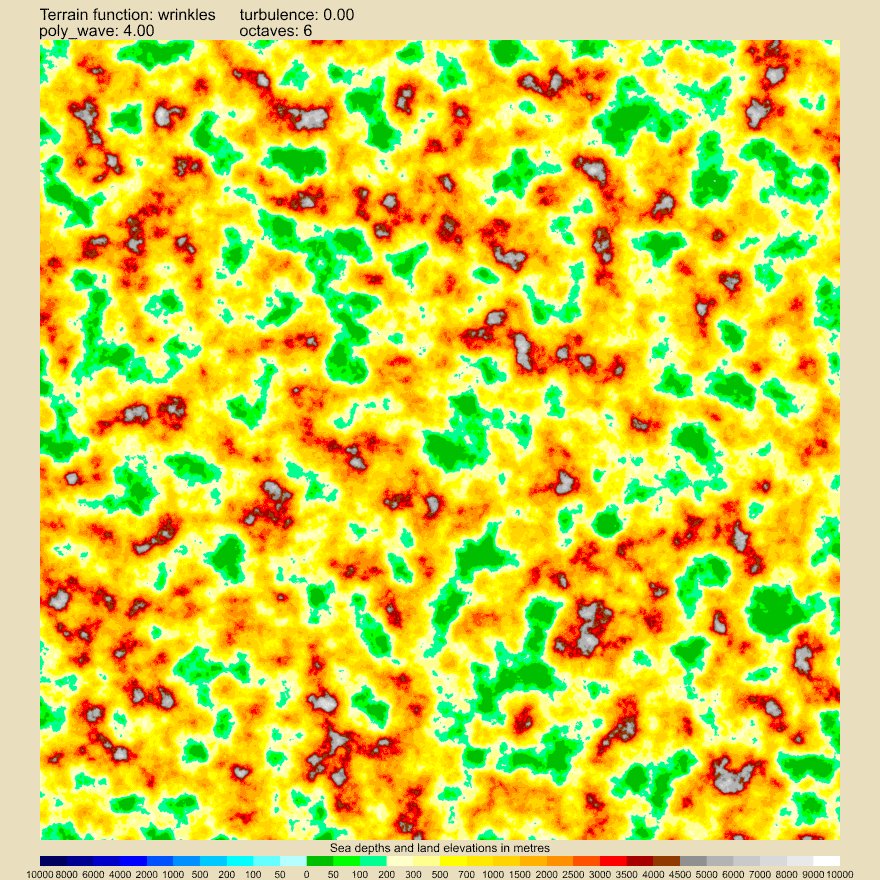

a problem occurs: as the human eye's ability to discern hues is limited,
I have to adapt the color_map for the original 200 by 200 kilometres
physical map to the height range of the respective large-scale section.
To do this, I would have to know the highest and lowest point of the relief.

Alternatively you could add a second layer to your colour map, say with some
narrow black lines like isobars on a weather map.
