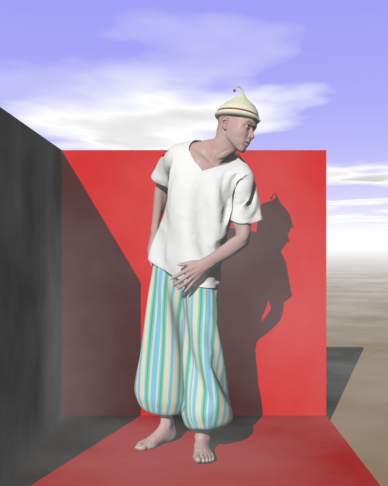

Now, my friends, compare this image with the preceding one in Take 5. Very
similar? Not so! (forget about the red walls. They here for fun only)
From top to bottom:
- The hat has been uv mapped and seamed properly.
- The t-shirt: I exported the conforming t-shirt to Silo (had to do it
through Poseray for some reason), combined all the meshes, merged the
ovelapping vertices, corrected some wrong geometry, exported again to a
.obj, and imported it in Poser where I made it a dynamic cloth in the Cloth
Room. Look how the cloth falls much more naturally about the figure!!
- The pantaloon: I added seams at the base of the trousers, thus correcting
greatly the stretching of the map.
Note: Stephen mentioned end-caps when exporting the conforming clothes. I
think this is due to problems with the Wings3D import (I experienced that
also on other mesh imports). End-caps do not happen in Silo, nor will they
happen I believe in Blender. Note however, that the exported object may have
numerous wrong faces (invisible in fact) so do not subdivide the mesh
further or you will have to correct them.

It fits better as well.
Much better
Good but there is a bit of a pinch at the turn. Sorry :-)
I thought that it was the Poser export, I'm sure I saw them in PoseRay.
Interesting, I used an old copy of Max.
Which export, from Poser or the modeller?
Regards
	Stephen

"Stephen" <mcavoysATaolDOTcom@> schreef in bericht
news:0aui53drmj8gbed77karjfo195joeug01m@4ax.com...
> On Sun, 27 May 2007 11:42:34 +0200, "Thomas de Groot"
> <t.d### [at] internlDOTnet>
>>From top to bottom:
Ah! That's because Iskander moved it on his head :-)
>>Cloth
> Much better
Yes, this is really an interesting development. I have never been very
enthousiastic about conforming clothes as they often appear to be too
artificial. If this transformation remains easy for all of them, then there
is great potential to generate more natural looking clothing.
>>correcting
Of course! Where the seams are, a pinch automatically appears. That is to be
expected... also in RL when using a striped tissue. It doesn't really
matter.
Interesting. Maybe we have two different issues here...
Well... We are not yet done with experimenting these cases then!
Yes, good question. I mean the object exported from Poser. My experience (so
far) after combining the different meshes into one, and merging the
vertices, is that there remain a number of redundant faces, i.e. edges with
more than two faces. If you need to subdivide the mesh further, you have to
get rid of them to avoid ugly spiky artefacts.
Thanks for your comments Stephen!

OK, where did his name come from?
>> Much better
Much more natural but I can see us spending more time in Poser than in Pov-Ray
>>>correcting
>matter.
I actually thought that might be the case. Hmm! Even more impressed.
It could be. I just remembered I exported as 3DS, so I could work in Max.
Actually I generally use 3DS because you get fewer groups in the figure meshes.
Sorry, you're going too fast for me. What different meshes are combined into
one? I normally export the Poser objects separately and combine them in the
scene. Or do you mean the separate parts of the cloth? But that aside I've found
lots of redundant faces too.
Regards
	Stephen

Nice job Thomas. The shirt looks much better dynamic vs. conforming. The
pants look great. And I like his hat!
> into
> the
> found
     But isn't the 'Cleanup' command supposed to get rid of this? I thought
it did. (Even PoseRay clears unwanted verts iirc).
       ~Steve~ <puzzled>

   That is MUCH better! Well done, looks good to me!
      ~Steve~

Yes but ... :-)

Now THAT is nice!
>>> Much better
>>there
> Pov-Ray :-(
Not really, I believe. All this work on the t-shirt took only a couple of
hours or less, and that for a first experiment. The simulation in Poser
takes some time of course, but if all goes well you end up with a posed
image you are at liberty to use in POV-Ray as you want. In the end, I guess
that we shall spend much more time in POV-Ray for scene building. Time spent
in Poser is certainly worth it.

I'm sorry. I should learn to explain better. The export of a conforming
cloth (or a figure, for that matter) from Poser, shows the different meshes
it is built from (pectorals, shoulders, neck... etc). So, the first action
is to group/combine all those separate meshes into a single one, and
join/merge the overlapping vertices of the original meshes. To answer Steve
here: This cannot be done in Poseray I believe, as you have to group first
the different constituent meshes. In the same action, the loose triangles
that may also be present in the mesh are nicely joined to the whole.
After this stage, as you say Stephen, you are left with a number of
redundant faces which you can try to get rid of, or (if you do not intend to
subdivide) just leave alone as they will not be visible in the end: they are
located on the inside of the mesh.
Thanks Janet! I think I got the incentive to transmogrify a lot of
conforming clothes into dynamic ones (at least those that would really get
better from the operation).
Have you noted how the shirt also nicely collides with the underlying pants?
I was a bit worried about that but it went well. The trick is revealed in
the tutorial manual. You just have to simulate the different clothes in
succession, from inside to outside. Each simulation will take the earlier
results into account it seems. The manual tells this a little bit more
confusedly though, so I was in doubt.
The pants are very nice now. I could certainly work a bit more on them, but
I shall leave that for another occasion. There is now a next step in
complexity that I want to explore: breeches with bindings along the calves.
I think I know how to do this (again, the tutorial manual give a number of
useful hints in that direction) but I have to try this out on a figure.
<grin> yes the hat! Such a simple object, originally built from a torus. I
wanted something outlandish anyway  :-)

Iskander missed a small thing: a golden earring :-)

> One thing I did yesterday, was exporting a conforming cloth in 3DS, import
> it in Wings3D, and lo! the endcaps were there!!!
Ha! OBJ’s are the way to go then, I better get a modeler that can handle
them. Wings, Silo Blender? Steve (St) has done some sterling work with
Wings. Oh! Joy more to learn :-)
> Hmm... No, in Silo I have first to merge the different meshes into one.
> Those redundant faces and polygons might indeed intersect... However, if
> you make the animation in Poser, there shouldn't be any redundant faces,
> should there? Or am I making a false assumption here?
No you aren’t making a false assumption. I exported some cloth from poser to
tailor it to the figure I was using. That’s when the redundant faces and
polygons appeared.

> Wouldn't these be shorter pantaloons? I'm no sailor tailor, just curious.
There are a lot of different type of breeches, depending on historical epoch
mainly, and use. I googled some images and there are even a number of sewing
'patterns' for making them in RL. Not so useful in the mesh universe, but it
might give some ideas. What I want to try is the Celtic or the Viking type
of breeches, and bind them at the calves, perhaps with some additional
leggings (for winter) if I feel confident enough.
17:00 hours: the breeches are finished and ready for simulation. Next step
are the bindings...
>> I
> It is definitely unique and outlandish. :)
Yes indeed.

Oh, man, you are getting fancy! That's a great idea with the torus. And it
makes UV mapping easier, I would think. I see what you mean about
animating. :) I am very glad you started these Poser cloth threads, and I
will keep watching!

UV mapping easier? Hmm... yes, for some cases that would be so. Thinking
about my pantaloons, no, because there the design is already baggy from the
start. It is a different approach towards a fairly similar result (a case of
convergent evolution so to speak).
