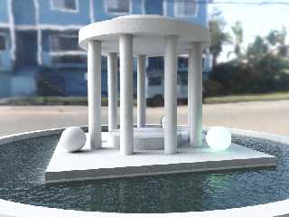

I decided to have a play with HDR. I was getting really really *really* ugly
lighting using radiosity (even with very high quality settings) so this
image was created using Megapov's no_radiosity flag on the sky dome, and 110
area lights sampled from the dome to get the lighting. I did some tests and
110 lights with the right amount of blur looked pretty much identical to
5000 non-area lights.
I chucked a glowing orb in there so you can see it's still doing radiosity,
it's just the light from the HDR image is done using lightsources not
radiosity.
HDR probe is from the website of a friend of mine: http://unparent.com/
(photography->hdr probes)
Comments appreciated, I'm trying to get it to look pretty realistic. I'll
post the source if anyone wants it.
Tek
http://evilsuperbrain.com
Download 'hdr-megapov-1.21.jpg' (156 KB)
Preview of image 'hdr-megapov-1.21.jpg'

I like it, although I think you are being let down by the HDR probe you are
using: generally it looks a little wavy, and it is particularly noticeable
on the white trim of the house around the doorway.
Perhaps you could turn that into a feature by adding some mist/steam rising
from the water to imply that is the cause of the wavy effect?
Having said that I like your approach to HDR lighting and I wouldn't mind
having a look at the source.
Cheers.

Well if it were a finished picture I'd make sure the HDR probe was either
not visible (except in reflections) or was very out of focus.
Tek

size of the area light is determined by the size of the representative area
of the specific light source.
4) Automatic/manual brightness adjustment:  Allows the system to either
automatically determine a good overall brightness of the lighting based on
the brightness of the HDR or allow the user to target a given effective
light brightness.
And much more including a few experimental techniques/features like gamma
adjustment and brightness weighting.
It has turned out to be quite complex, but I am quite satisfied with the
results I have been getting and feel that I am very near to being satisfied
enough to release it.
The process also taught me a great deal about a number of items:
-HDR images and concepts
-programming methods
-voronoi tesselations
-median cut method
-summed area tables
I hope this helps you along the way with your progress. Whether what you end
up doing turns out to meet your expectations or not, you can still learn a
lot about POV and other topics along the way.
Feel free to ask more questions and I can try to answer or help if/when I
can.
-tgq
From: Trevor G Quayle
Subject: Re: hdr
Date: 12 Apr 2007 11:15:01
Message: <web.461e4c64c3e2923bc150d4c10@news.povray.org>

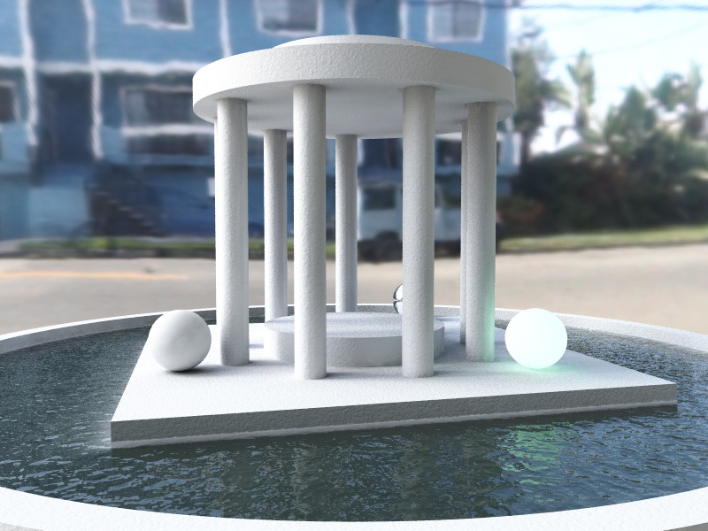

I had a look at the scene and it looks like a good start.  However, It
doesn't use area lights like I thought you had said.  On another note, I
don't think it's necessary to use parallel lights, probably doesn't make
much of a difference though as long as your light dome is big enough.
I must say that I really like the texture on the sphere.  I've been meaning
to try something like that for a metallic paint finish for cars and stuff.
Keep up the good work.
-tgq
From: Tek
Subject: Re: hdr
Date: 12 Apr 2007 11:39:03
Message: <461e5297@news.povray.org>
The scene does use area lights, look:
   light_source {
    dir*1000, col*4/num_lights parallel point_at 0
    #if (area_ang > 0)
     area_light
x*1000*tan(radians(area_ang)),y*1000*tan(radians(area_ang)),4,4 adaptive 1
jitter circular orient
    #end
That metallic paint was just a quick experiment that's turned out much
better than I expected, I'm currently building a car model to show it off
properly :-D
Tek
"Trevor G Quayle" <Tin### [at] hotmailcom> wrote in message
news:web.461e4c64c3e2923bc150d4c10@news.povray.org...
> meaning
> -tgq
From: Tek
Subject: Re: hdr
Date: 12 Apr 2007 11:48:02
Message: <461e54b2$1@news.povray.org>
> 1) I started out with a full geodesic distribution and sampling.  Geodesic
> distribution has a slight downfall in that the spacing at the mid
> latitudes
> (+- 45 deg)  is greater than at the poles and equator.
That's not really what I understand by the term "geodesic", I was thinking
of using a geodisic distribution based on subdividing the triangles of an
icosahedron like this
http://en.wikipedia.org/wiki/Image:G%C3%A9ode_V_3_1.gif One light on each
vertex would be a near perfect distribution.
Tek
news:web.461e451cc3e2923bc150d4c10@news.povray.org...
> "Tek" <tek### [at] evilsuperbraincom> wrote:
>> My light dome's not adaptive like that. I sample each light from an
>> average
>> of 20 points on the dome to get less aliasing, but for the light
>> positions I
>> just messed with some formulae until I got a nice even distribution of
>> lights over the dome (I couldn't be bothered coding a geodisic dome light
>> placement). My formula for spreading lights over a sphere is:
>> To be honest I don't know why it gives such a good distribution, I found
>> it
>> by trial and error, I have a knack for messing with pow() functions until
>> I
>> get something that looks right!
>> Your weighted sampling technique sounds good, I assume you use bigger
>> area
>> lights if they're representing a region with less lights in (if you see
>> what
>> I mean). My area lights are setup so I can specify an angular size for
>> them,
>> which matches the region I'm sampling on the dome, the angular size was
>> chosen using a simple sun-dial test scene adjusted until the distinct
>> shadows overlapped enough that they looked like 1 smooth shadow.
> My development process progressed as follows:
> latitudes
> 2) So then I switced to an equal spacing distribution. (basically divide
> the
> circumference at the given height by the desired spacing and round to the
> nearest integer).
> Even distribution gave good results with a high number of lightsources
> (2000
> or so) but was essentially oversampling in the low-light areas, needlessly
> adding more lights than required.
> 3) At this point I switched to a random point selection with 2 levels.
> Above a given brightness threshold, I chose a given number of light
> sources, and below the threshold another number of light sources.
> This allowed me to get more weighting to the bright lights, but I found I
> was now undersampling the low light too much (ie, not getting that blue
> ambient tinge in outdoor scenes).
> 4) Now I added centroidal voronoi tesselation techniques to gravitate the
> chosen point lights to a natural even brightness distribution.
> This was a little better, but was very computationally intensive.
> 5) At this point I came across median cut method and tried implementing
> this.  In order to do this efficiently, a few precalcs needed to be done.
> This involved prebuilding summed area tables for the HDR.  Because I had
> to
> use a finite size to store the SATs, I had to choose a subdivision level
> for
> the HDR (ie. pixelate it).
> This worked out quite well and was much more effective and quick at given
> a
> nice equal brightness distribution with much fewer light sources (I use
> 256
> typically).  One downfall is that at low subdivision (large pixel size)
> small point lights in the HDR could be lost.  This is remedied by
> increasing the subdivision (which adds to the parse time, but not render
> time)
> Along with the median cut method technique, I have the central voronoi
> tesselation technique still available to tweak the calculated distribution
> (though I never use it because of computation time).
> A few other features have been added along the way:
> 1) previewing of light distribution: renders a preview of the HDR itself
> showing the calculated light distribution.  Makes tweaking the numbers and
> seeing the results easy and quick to do.
> 2) Clipped area rebuilding algorithm:  artificially rebuilds clipped areas
> of HDRs (Some HDRs I have still have a cutoff threshold becuase of
> limitations in their creation).  This can also be used to try to adapt LDR
> images to the system, though the result may not be great and may need a
> lot
> of tweaking of the variables.
> 3) Area lights: allows area lights to be used instead of point lights.
> The
> area
> light brightness.
> satisfied
> -median cut method
> -summed area tables
> end
> can.
> -tgq
Subject: Re: hdr
Date: 12 Apr 2007 11:50:01
Message: <web.461e54f4c3e2923bc150d4c10@news.povray.org>
>    light_source {
>     #if (area_ang > 0)
>      area_light
>     #end
You must've uploaded a different file:
light_source { dir*1000, col*4/num_lights parallel point_at 0 }
-tgq
From: Tek
Subject: Re: hdr
Date: 12 Apr 2007 23:54:09
Message: <461efee1$1@news.povray.org>
Doh! That's an older version of the file, the new one is posted as a reply
to that in p.b.s-f
That also explains why you were talking about the metallic sphere (which is
still in the new file, but commented out). I should have paid more
attention!
Tek
news:web.461e54f4c3e2923bc150d4c10@news.povray.org...
>>    light_source {
>>     #if (area_ang > 0)
>>      area_light
>> 1
>>     #end
> -tgq
From: Christian Froeschlin
Subject: Re: hdr
Date: 14 Apr 2007 12:00:38
Message: <4620faa6$1@news.povray.org>
Well, this is looking good. I finally got around to playing a bit
with HDR images and light domes, and I think a useful speed vs. quality
parameter would be a threshold for dropping light sources which do not
contribute a lot because the dome is locally dark.
Here's an adapted version of your do_lights macro, although I don't
have the patience to do such high quality renders and not the eye
for detecting the subtle differences in the shadows. Maybe you want
to try it out. It simply skips light sources when the value is below
a specified threshold, but sneakily preserves the global illumination
by distributing the lost light over the remaining light sources.
For this, light source creation had to be delayed into a second phase.
I also dropped "parallel" and "point_at" because I had strange effects
with that and the dome should simulate diffuse lighting anyway? BTW,
I never used point_at without spot_light, is it implicit?
Of course, a *really* smart macro might perform a recursive subdivision
on the sphere, using more light sources in areas where there is a lot of
light and/or structure, similar to anti-aliasing ;)
Download 'us-ascii' (3 KB)
Subject: Re: hdr
Date: 14 Apr 2007 15:00:01
Message: <web.462123e4c3e2923b2ac336070@news.povray.org>
Perhaps I should think about releasing the one that I have been developing
for a while (perhaps this week, I think I am probably at a point where I am
satisfied with its performance...).  It sort of does what your are
describing through use of a median cut algorithm which does it naturally
without the need for recursion.  It is basically the opposite of the idea
of evenly placing light sources with varying brightness.  It instead places
light sources of equal brightness with varying spacing.  With this method, a
good overall scene lighting is achieved with fewer light sources and without
sacrificing light contribution from any one area.
-tgq
Subject: Re: hdr
Date: 15 Apr 2007 10:06:35
Message: <4622316b$1@news.povray.org>
Oops, accidentally posted broken version, replace
   #local skipped_col_cumul = skipped_col_cumul + col;
with
   #local skipped_light_cumul = skipped_light_cumul + col;
From: Allen
Subject: Re: hdr
Date: 18 Apr 2007 01:50:02
Message: <web.4625b0dcc3e2923be0c98e3b0@news.povray.org>
Okay,
It's been plaguing me.... what is HDR and what program uses HDR?
Subject: Re: hdr
Date: 18 Apr 2007 09:10:02
Message: <web.4626178fc3e2923bc150d4c10@news.povray.org>
"Allen" <nomail@nomail> wrote:
> Okay,
