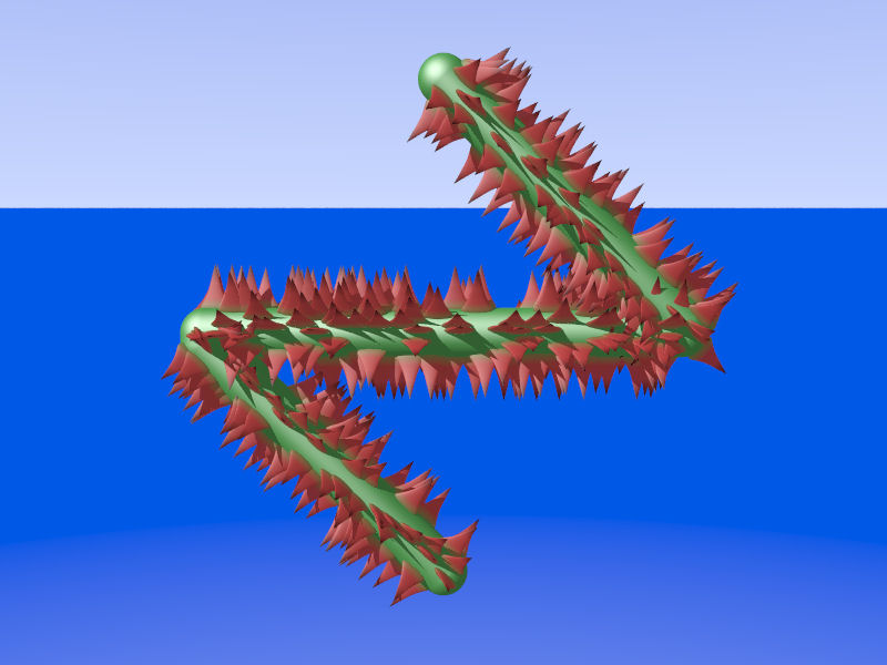

Illustrating my question in pov-ray.advanced-users about Tim Attwood's macro
(22 January 2007).

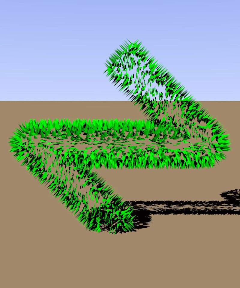

This works sorta, but you need to know the spline,
and it isn't a very good distribution on the sharp bends.
#declare rsd = seed(1);
union {
#local c = 0;
#while (c<500)
   object{Thorn
   rotate 360*rand(rsd)*z
   Spline_Trans(Stem, rand(rsd), y, 0.01, 0.01)
   #local c = c + 1;
#end
Download 'thorn.jpg' (69 KB)
Preview of image 'thorn.jpg'

Yes, this is another possibility for a more cactus-like object. I shall try
that too!
Thanks a lot, Tim.

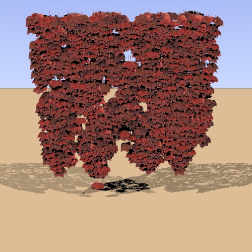

This is a result test when using
Point_At_Trans(vnormalize(<Norm.x,0,Norm.z>)). Exactly what I wanted. The
top is trashy, but that can easily be corrected :-)
Thanks again, Tim.

From: Stephen
Subject: Re: Random points on surface of an object (in advanced-users)
Date: 20 Feb 2007 11:50:00
Message: <web.45db25b96a72babbf1cb1e660@news.povray.org>
> Thanks again, Tim.
> Thomas
It looks OK to me, nice topiary
Stephen

> I looked at your image again at home on a decent screen and I see what you
> mean about the top being messy.
Yes, it mainly comes from the leaf image that contains a long stem. So,
first thing to do is get rid of that. Secondly, this is where the supporting
object bends away. It may then be viewpoint-related. I shall have to
investigate.
Fwiw, there are some 6000 leaves here and it took v.3.7 about 5 minutes to
parse and render on a Pentium D machine. About 30 minutes with v.3.6.

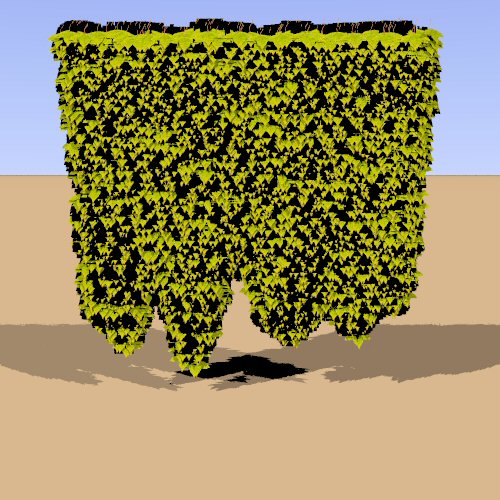

However, there are limits still. The same image, with 2000 leaves but with
four different image_maps choosen randomly (see image), took about 15
minutes and the hard drive started to protest. You can easily get to the
limits of your memory that way.
Download 'RandomDistribution.jpg' (182 KB)
Preview of image 'RandomDistribution.jpg'
You'll have to get rid of those stalks, Thomas.  :-)
Could you pre-render the leaves and convert them into a mesh so you would only
have to do it once?
Regards
	Stephen
Date: 23 Feb 2007 04:36:45
Message: <45deb5ad@news.povray.org>
"Stephen" <mcavoysATaolDOTcom@> schreef in bericht
news:8qsrt21v39lv1eoudo4cupc16ebnaj9c3b@4ax.com...
Yes. Well, you know how it is: take a leaf down, trim the stem, put the leaf
back, take the next leaf down....  :-)
> only
> have to do it once?
Shame on me! You put the finger on the sore spot! This is a flagrant case of
sloppy code writing! I was so stupid to call the image_map for every single
leaf. No wonder the pc (which is sometimes more intelligent than I am) was
protesting. Corrected now.
