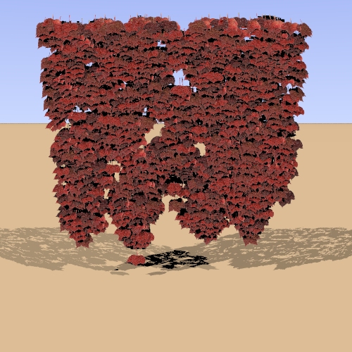

Illustrating my question in pov-ray.advanced-users about Tim Attwood's macro
(22 January 2007).
Download 'RandomDistribution.jpg' (144 KB)
Preview of image 'RandomDistribution.jpg'

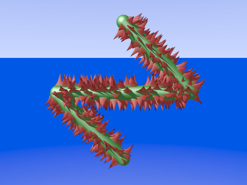

This works sorta, but you need to know the spline,
and it isn't a very good distribution on the sharp bends.
#declare rsd = seed(1);
union {
#local c = 0;
#while (c<500)
   object{Thorn
   rotate 360*rand(rsd)*z
   Spline_Trans(Stem, rand(rsd), y, 0.01, 0.01)
   #local c = c + 1;
#end
Download 'thorn.jpg' (69 KB)
Preview of image 'thorn.jpg'
Subject: Re: Random points on surface of an object (in advanced-users)
Date: 20 Feb 2007 07:59:14
Message: <45daf0a2$1@news.povray.org>
"Tim Attwood" <tim### [at] comcastnet> schreef in bericht
news:45dad2e5@news.povray.org...
> union {
> #local c = 0;
> #while (c<500)
>   object{Thorn
>   #local c = c + 1;
> #end
Yes, this is another possibility for a more cactus-like object. I shall try
that too!
Thanks a lot, Tim.

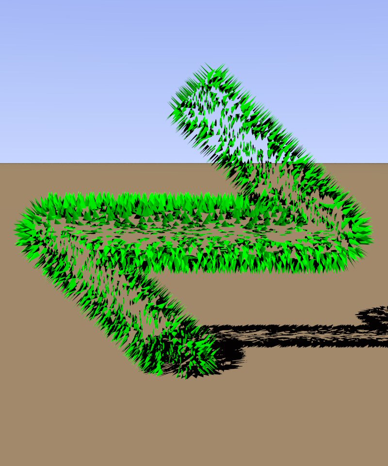

This is a result test when using
Point_At_Trans(vnormalize(<Norm.x,0,Norm.z>)). Exactly what I wanted. The
top is trashy, but that can easily be corrected :-)
Thanks again, Tim.
Download 'RandomDistribution.jpg' (88 KB)
From: Stephen
Date: 20 Feb 2007 11:50:00
Message: <web.45db25b96a72babbf1cb1e660@news.povray.org>
> Thanks again, Tim.
> Thomas
It looks OK to me, nice topiary
Stephen
Date: 21 Feb 2007 03:05:19
Message: <45dbfd3f@news.povray.org>
"Stephen" <mcavoys_AT_aolDOT.com> schreef in bericht
news:web.45db25b96a72babbf1cb1e660@news.povray.org...
Yes, this works quite well. When I saw Tim's code, I immediately thought
about its use for topiaries and all those cases where vegetation is hanging
down a wall. But its use could certainly be extended to lots of other
applications! For instance, a figure covered with bees? or flies?  :-)

> Or made of bees or point glows as a hive intelligence (?).
Yes, indeed, that would also be an interesting idea to work out.
> I looked at your image again at home on a decent screen and I see what you
> mean about the top being messy.
Yes, it mainly comes from the leaf image that contains a long stem. So,
first thing to do is get rid of that. Secondly, this is where the supporting
object bends away. It may then be viewpoint-related. I shall have to
investigate.
Fwiw, there are some 6000 leaves here and it took v.3.7 about 5 minutes to
parse and render on a Pentium D machine. About 30 minutes with v.3.6.

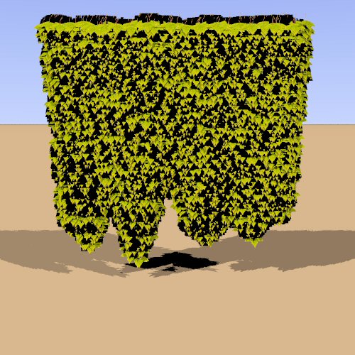

However, there are limits still. The same image, with 2000 leaves but with
four different image_maps choosen randomly (see image), took about 15
minutes and the hard drive started to protest. You can easily get to the
limits of your memory that way.
Download 'RandomDistribution.jpg' (182 KB)
From: Stephen
Date: 22 Feb 2007 14:47:32
Message: <8qsrt21v39lv1eoudo4cupc16ebnaj9c3b@4ax.com>
On Thu, 22 Feb 2007 09:44:27 +0100, "Thomas de Groot" <t.d### [at] internlDOTnet>
You'll have to get rid of those stalks, Thomas.  :-)
Could you pre-render the leaves and convert them into a mesh so you would only
have to do it once?
Regards
	Stephen
Date: 23 Feb 2007 04:36:45
Message: <45deb5ad@news.povray.org>
"Stephen" <mcavoysATaolDOTcom@> schreef in bericht
news:8qsrt21v39lv1eoudo4cupc16ebnaj9c3b@4ax.com...
Yes. Well, you know how it is: take a leaf down, trim the stem, put the leaf
back, take the next leaf down....  :-)
> only
> have to do it once?
Shame on me! You put the finger on the sore spot! This is a flagrant case of
sloppy code writing! I was so stupid to call the image_map for every single
leaf. No wonder the pc (which is sometimes more intelligent than I am) was
protesting. Corrected now.
