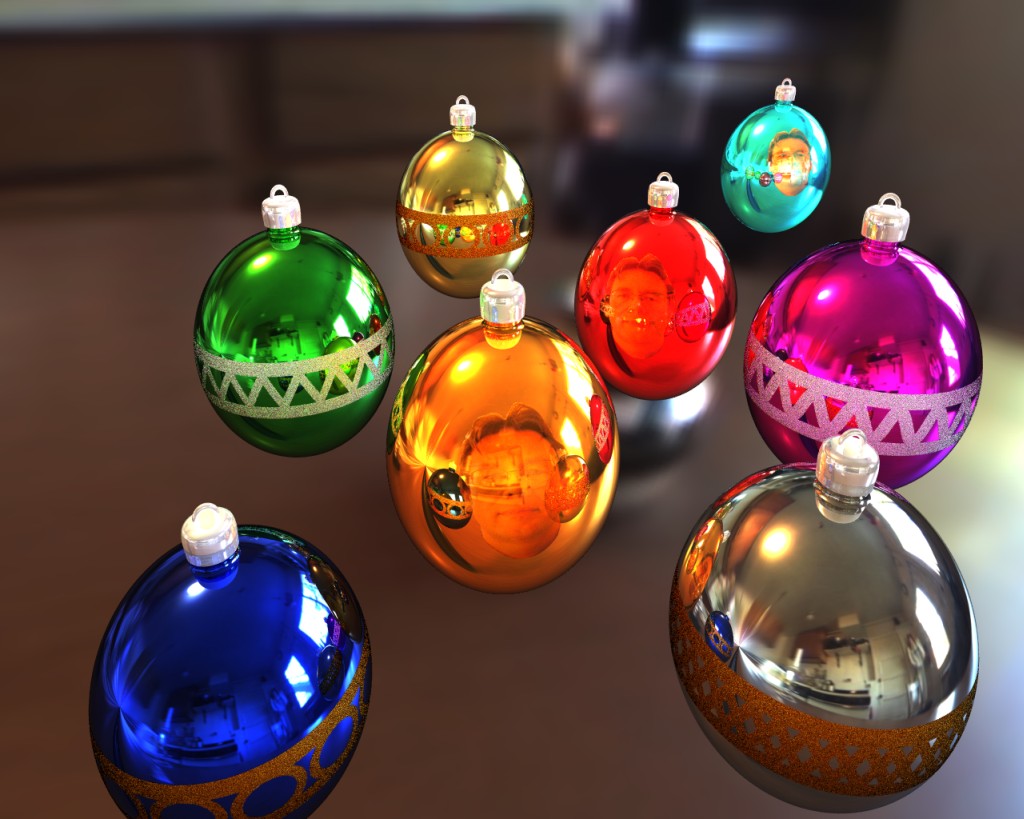

Hi
I'm getting strange black reflections on shiny balls.I'm usingt mlpov 0.8
with hdri. Anybody has an idea what is causing this?
The balls consits of two parts an inner ball with the following texture
#declare  lightyellowfinball =   finish { ambient 0 diffuse .0 reflection
{ <2.3,2.3,1>*1.1*0.9,<0.5,0.5,0.5>*0.9  } }
around this is a second ball slightly thicker
with the following texture map
#declare ttextur=   texture { pigment {rgbt <1,1,1,1>} normal {bumps 1 scale
.01}};
#if (strcmp(texturepic,"")!=0)
sphere{
0,1+0.001
      texture { uv_mapping
        image_pattern { gif texturepic  }
        texture_map {
                [0 uv_mapping ttextur]
                [1 uv_mapping textur scale 1/mapscale]
         scale mapscale
         translate <0,1.02*mapscale,0>
rotate <0,15,0>
translate <0,1,0>
this seems to work fine for the balls themselves, but the transparent part
of the reflections go black... When i render the same pic without the second
ball the reflections don't go black
Download 'HDRItest3.jpg' (70 KB)
Preview of image 'HDRItest3.jpg'
From: Orchid XP v3
Subject: Re: black reflections on shiny balls
Date: 27 Jan 2007 10:27:32
Message: <45bb6f64$1@news.povray.org>
I would guess you're hitting the max trace limit. Try adding this:
global_settings {max_trace_level 10}
(IIRC the default is 5. Check the documentation...)
From: Johan Feyaerts
Date: 27 Jan 2007 10:41:44
Message: <45bb72b8@news.povray.org>
yep that seems to work.
I don't really get why the trace level needs to increase when there is a
transparent layer around the shiny finish,but anyhow problem  is solved now.

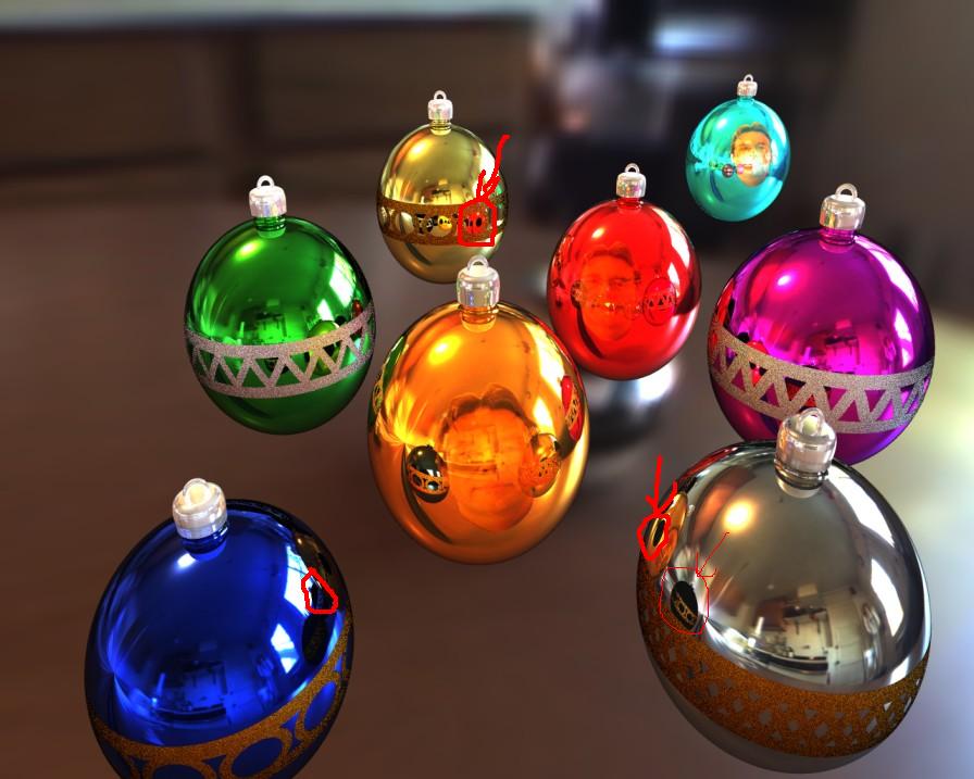

Date: 27 Jan 2007 17:37:07
Message: <45bbd413@news.povray.org>
I changed the settings to
global_settings {
  radiosity {
    pretrace_start 0.08           // start pretrace at this size
    pretrace_end   0.04           // end pretrace at this size
    count 60                      // higher -> higher quality (1..1600) [35]
    nearest_count 5               // higher -> higher quality (1..10) [5]
    error_bound 1.8               // higher -> smoother, less accurate [1.8]
    recursion_limit 5             // how much interreflections are
calculated (1..5+) [3]
    low_error_factor .5           // reduce error_bound during last pretrace
step
    gray_threshold 0.0            // increase for weakening colors (0..1)
[0]
    minimum_reuse 0.015           // reuse of old radiosity samples [0.015]
    brightness 1                  // brightness of radiosity effects (0..1)
[1]
//    adc_bailout 0.01/2
    adc_bailout 1/64
    normal on                     // take surface normals into account [off]
  max_trace_level 26
This seems satisfactory to me, most disturbing black spots seem to be gone
now.
I plan to do an animation with this scene (hopefully ready by christmas
2007), so I guess I'll have to reduce the trace level to something like 17
make it faster
Thanks for the advice.

                                        #declare j=0;
                                        #declare
jmax=dimension_size(filterarr,1);
                                        #while (j<jmax)
                                                filter   filterarr[j], 1
                                        #declare j=j+1;
                                        #end//
                                        once
                        scale <1,1,1>*1.2
                        warp {
                                spherical
                                orientation z
                                dist_exp 1
                        // translate <0,1.1,0>
                        //  rotate 100*y  //color rgbf <1,1,0>
                        // rotate x*-22
                        // scale  0.1
                scale mapscale
                rotate y*130
                finish{finpic}
#end
.01}};
        texture_map {
         scale mapscale
rotate <0,15,0>
translate <0,1,0>
but pov complains that it cannot layer a patterned texture over another. I
think it's the first and the last texture that are conflicting. If I just
put the shiny finish in the texture map then it gets bumps like the metal
part in textur which is not the intention.
#end
"Ben Chambers" <ben### [at] pacificwebguycom> wrote in message
news:45bd78e5@news.povray.org...
> Johan Feyaerts wrote:
>> I think I tried that already but pov protested that image maps could not
>> be combined with texture maps.
> An image_map is a pigment type, which is part of a texture.  So you
> shouldn't try to combine the two.
> Instead, declare the image map as the pigment of a complete texture, and
> layer that with another complete texture.
> ...Chambers
From: Ben Chambers
Date: 2 Feb 2007 03:56:39
Message: <45c2fcc7@news.povray.org>
Try it like this:
#declare foo = texture { <first texture here> }
#declare bar = texture { <texture w/ image map here> }
texture {average texture_map {[1 foo][1 bar]}}
...Chambers
