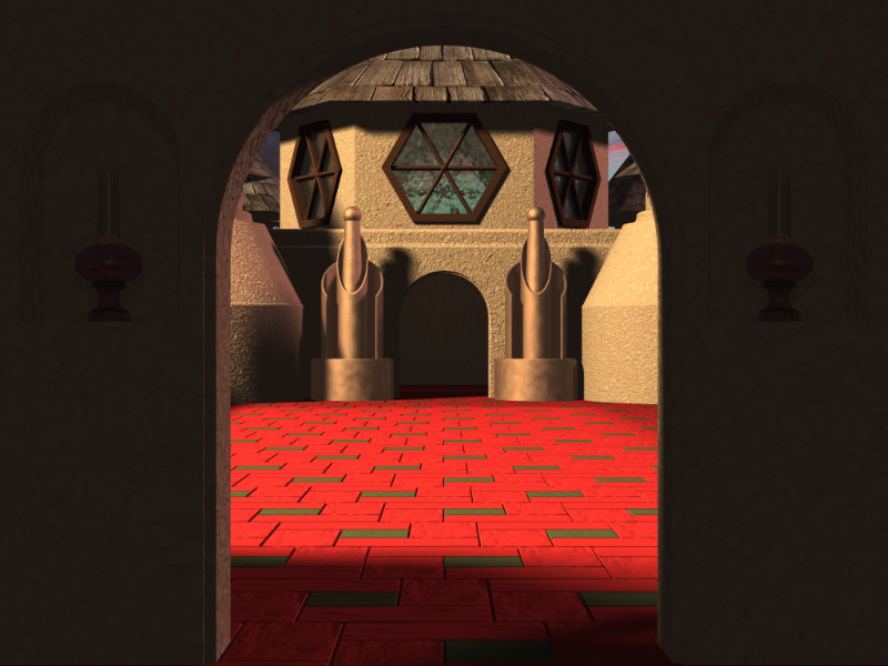

This started out as a barracks in some off world scene but ended up looking
a bit more
terrestrial ..... kind of like tudor meets bajoran.
Jim

From: Ben Chambers
Subject: Re: A courtyard scene
Date: 21 Jan 2007 12:54:45
Message: <45b3a8e5$1@news.povray.org>
I like it, except that the red bricks are way too bright.  They really
stand out against all the other colors.
...Chambers
From: Slime
Date: 21 Jan 2007 17:52:33
Message: <45b3eeb1$1@news.povray.org>
I agree. You have interesting architecture in the back, but the floor is too
loud to let you notice it.
Also, you need some light on the viewer's side of the archway. Maybe a soft
spotlight falling over the walls would be good. I can tell that you want the
archway to be a frame, but it's so dark that it looks flat and fake compared
to the rest.
Maybe you could move the camera closer to the door and increase the camera
angle, to let us see more of the outside? The roof and the sky beyond it,
for instance, as well as whatever's on the left and right. You could also
move the camera down some and have it look up, so we see less of the floor
and more of the sky. I feel like there's something interesting out there,
but I can't see it.
 - Slime
 [ http://www.slimeland.com/ ]
From: Jim Holsenback
Date: 22 Jan 2007 06:30:09
Message: <45b4a041@news.povray.org>
"Slime" <fak### [at] emailaddress> wrote in message
news:45b3eeb1$1@news.povray.org...
> too
yeah ... I had a more muted color scheme that I liked better .... changing
it back!
> soft
> the
> compared
> to the rest.
yep ... I'd agree with that .... I've since tried and area light that I
moved way back
so that it shows on the wall (it has two hurricance lamps in small alcoves
on each side of the doorway. It looks MUCH better as the light filters down
through the hex shaped windows in the top of the 2nd level of the room.
> but I can't see it.
I like the view looking through the doorway but the camera angle (up) is a
bit tricky .... I wanted to use the gid lines in the courtyard tiles to pull
the viewer into the scene .... some excellent feedback ..... thanks!
> - Slime
BTW: How 'bout them Colts (another shameless plug ;-)
From: Smws
Date: 22 Jan 2007 12:35:01
Message: <web.45b4f548a665bdeebd0cea630@news.povray.org>
> a bit more
> Jim
It looks interesting. I think those sculptural cylindrical things would make
good bishops in a chess set. As others have said, the floor distracts a bit
from the rest of the image. I like the bumpy hexagonal windows.
-Stefan

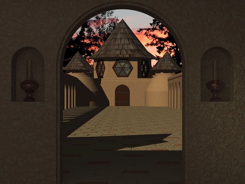

Date: 24 Jan 2007 08:57:15
Message: <45b765bb@news.povray.org>
A much improved version if I do say so .....
In order to get a better view it took a combination of moving the camera
back and pushing the outside building out WAY farther in the "Z" axis. It
took a bit to get the camera angle so the image didn't have a pinchusioned
look to it. The close up view of the wall and the oil lamps has an area
light the size of and almost right up against the ceiling. I like this tile
color scheme MUCH better than the previous version ....
Thanks everyone who offered comments on previous version .... I was
suffering from POV version of writters block!
Download 'Courtyard.jpg' (298 KB)
Preview of image 'Courtyard.jpg'

From: Mike Sobers
Date: 25 Jan 2007 23:50:01
Message: <web.45b9873aa665bdeebb1c02580@news.povray.org>
Great job!  The lamps and texture on the foreground wall are terrific.  Only
two small comments. The texture on the far wall (looks like it's the same
texture as the foreground) is too uniform at that distance.  It almost looks
like new stucco, so maybe some larger patterned texture would help.  Also,
the roof on the tower is very smooth when outlined against the sky (image
mapped cone?)  If you had a few tree branches coming out from behind just a
teensy bit it would break up the line to make it less noticeable.
I think a close up of the lamp in its alcove the way it's currently lit
would look awesome!
Mike
Date: 26 Jan 2007 05:21:59
Message: <45b9d647@news.povray.org>
"Mike Sobers" <sob### [at] mindspringcom> wrote in message
news:web.45b9873aa665bdeebb1c02580@news.povray.org...
> Only
> looks
Thanks .... I like the lamps and inside texture as well. I'm not sure what
to do about the outside texture looking so small at that distance. It
shouldn't be too difficult to rescale the outside texture and retain the
inside like it is. If memory serves me I believe I didn't texture the shapes
I used to do the cutouts.
> Also, the roof on the tower is very smooth when outlined against the sky
> (image
> a
yes the shake roof is image_map on a HEX shaped cone. I tried to make it
look less smooth but using the same image_map as a normal_map with large
bump_size but wasn't able to pull it off ..... maybe a slight rotation in
the y-axis might help.
BTW the sky is also image_map .... it's a photograph I took this last fall
in my backyard.
> would look awesome!
I was thinking of doing a separate render of just that .....
Jim
From: s day
Date: 26 Jan 2007 05:55:01
Message: <web.45b9dd53a665bdee211a62630@news.povray.org>
This does look much better than the original, If you are still planning
further improvments I think you should use an area light to soften the
shadows a bit, I like the sky/trees but it is not realistic as the Sun
appears to be setting in the distance but the light is comming from the
left side. However, it would be a shame to lose either the shadows of the
arches or the great looking sky so I would not change this it is just an
observation.
Also it is worth adding a layer of dirt over your wall texture to slightly
darken the texture near the floor again this is if you are aiming for
realism which is not always the purpose.
Sean
From: Cousin Ricky
Date: 26 Jan 2007 10:35:01
Message: <web.45ba1b93a665bdee85de7b680@news.povray.org>
I agree.  The red bricks were the main thing, but the courtyard also seems
less claustrophobic now.
Just some comments:
 - As with any scene with prominent shadowed areas, i think this scene would

 - I like those copper "bishops."  What happened to them?
 - The sky suggests a sunrise or a sunset, but the sunlight color and the
   shadow lengths suggest otherwise.
 - I also agree with Mike that the tower silhouette is too smooth.
 - The outdoor area light was a good idea, although i think the effect in
   the original was too exaggerated.
   To be realistic, the diameter of the area light should be 2/215 the
   distance to the Sun.  For example:
      #declare Sun_loc = <-2000, 3000, -5000>;
      #declare Sun_d = vlength (Sun_loc) * 2/215;
      light_source
      {  Sun_loc, ...
         area_light Sun_d * x, Sun_d * z, 5, 5 circular orient
   The effect is subtle, though, so some artistic licence may be called for.
Date: 26 Jan 2007 12:00:00
Message: <45ba3390@news.povray.org>
"Cousin Ricky" <ric### [at] yahoocom> wrote in message
news:web.45ba1b93a665bdee85de7b680@news.povray.org...
they just seemed out of place ....
i've been looking for another photo to use as image map, as i've not been
able to come up with skies that I've been happy with. In this case I figured
heck hollywood uses the "mat painting" technique .... why not in POV ....
right? anyway I agree the backdrop is wrong my current setup.
the main light color is a tweeked Goldenrod from colors.inc I'm going for
the "gloaming" look, and the light inside the alcove takes into account that
some of the outside light makes it through the hex windows up in the tower.
>      light_source
>      {  Sun_loc, ...
lighting is the trickiest part so I'm going to play around with your example
.... thanks
From: Kenneth
Date: 29 Jan 2007 01:35:00
Message: <web.45bd94c4a665bdeee64a7b9e0@news.povray.org>
To get that "in the gloaming" look--a beautiful idea-- I would suggest, as
others have, an area light for the courtyard, to soften the shadows.  But
to make it somewhat of a pastel blue.  On a clear and crisp late afternoon,
the light coming from the overhead sky at sunset transitions from light blue
to a darker blue/purple. Or use TWO area lights, one blue, the other
pinkish/orange (to simulate some overhead clouds reflecting the setting
sun.)
Very nice work.
KW
