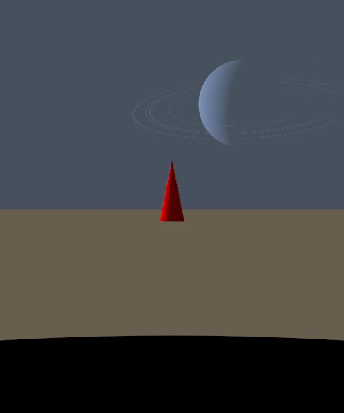

Been experimenting with something else again, inspired this time by a scene
in the novel Nova, by Samuel Delany.
This megapov image is nothing special, but it highlights a couple of things.
First of all, there is - again - the problem of scale. The real planetary
measurements have been used for this image. However, because of the z-buffer
limit, I had to scale down the kilometer values by a factor 3.
Second, If I want to build something on Triton, I want them to be
metre-scaled. So the camera position for instance is scaled down by a factor
6. Which generates the known problem of ultra-fine resolution, already
discussed here during the Ringworld experiments by Bill Pragnell, myself
(and some others?) last year. I rendered this scene also in version 3.7 and,
interestingly, the surface of Triton disappeared!!! Rendered in the adapted
3.6.0 version (see the Ringworld experiments) was not better than this
image.
So, what do we see here?
- Neptune is visible as it would be from the surface of Triton. Its axial
tilt in relation to the ecliptic is provided.
- The rings of Neptune are there. However, their width has been grossly
exagerated. In reality they are probably not or hardly visible.
- The small dot to the right of the planet is the moon Proteus. It looks
like this is probably the only moon really visible from Triton, the others
being too small or to far away to appear in the sky.
- The red cone is a placeholder, traced upon the surface of Triton. It casts
no shadow, probably because of the resolution limit.
Conclusion: If I want to create a scene, I shall probably fake reality by
scaling a sphere to the apparent size of Neptune, within a business-as-usual
POV-Ray scene. But at least, I shall know that the apparent size is
correct!!
Comments are of course more than welcome!!
Download 'NeptuneFromTriton.jpg' (10 KB)
Preview of image 'NeptuneFromTriton.jpg'

PS I forgot to say that the black band at the base of the image is an
artifact from the scale resolution.

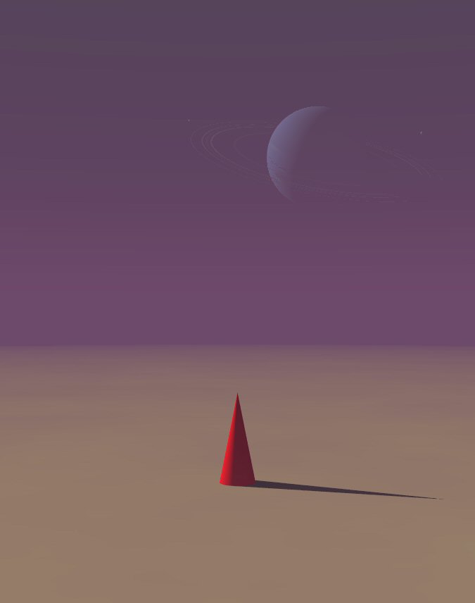

Subject: Neptune seen from Triton - wip 2
Date: 15 Dec 2006 10:45:23
Message: <4582c313$1@news.povray.org>
Thus, by wrenching natural laws apart, the second wip is arrived at.
At Neptune, I mainly tweaked the rings towards a more RL aspect, although
too wide of course, and I scaled two moons (Proteus and Larissa) five times
their real size to make them better visible. Added some fog on  a - as yet -
featureless Triton and colored the atmosphere to something more appealing
although less breathable. Now, the conic placeholder casts a shadow and
there is no artifact in the foreground.

From: Trevor G Quayle
Subject: Re: Neptune seen from Triton - wip 2
Date: 15 Dec 2006 11:15:01
Message: <web.4582c991c65210e0c150d4c10@news.povray.org>
> Building time has arrived!! First of all, the modelling of Hell<exp>3, one
> of the fiery cracks in the surface, according to the space opera.
> (However, I have also other running projects under way....)
> Thomas
What are you using for the texture of Neptune?  If you want image maps, I
found some cylindricals here:
http://www.mmedia.is/bjj/data/neptune/index.html
-tgq
Date: 16 Dec 2006 03:59:14
Message: <4583b562$1@news.povray.org>
"Trevor G Quayle" <Tin### [at] hotmailcom> schreef in bericht
news:web.4582c991c65210e0c150d4c10@news.povray.org...
I used a cylindrical image_map of Neptune. Basically it is the same as yours
(thank you for the link) only a bit more sustained blue. Downloaded from:
http://planetpixelemporium.com/neptune.html
From: EagleSun
Date: 19 Dec 2006 10:15:00
Message: <web.45880104c65210e087ea6da70@news.povray.org>
You may need to do this in 2 steps... 1: render Neptune at km scale, then
render Triton at m scale, and use a graphics editor to put the 2 together.
Date: 20 Dec 2006 02:47:45
Message: <4588eaa1@news.povray.org>
"EagleSun" <nomail@nomail> schreef in bericht
news:web.45880104c65210e087ea6da70@news.povray.org...
That is a possibility indeed. For the time being I prefer my method: my
current scene Neptune was first rendered at a scaled down km scale. Scaled
down because of the z-buffer essentially, but keeping the apparent
proportions identical (as seen from Triton). Finally, the scene on Triton is
going to be built following more or less a m scale. The end result will be
undistinguishable from RL :-)
