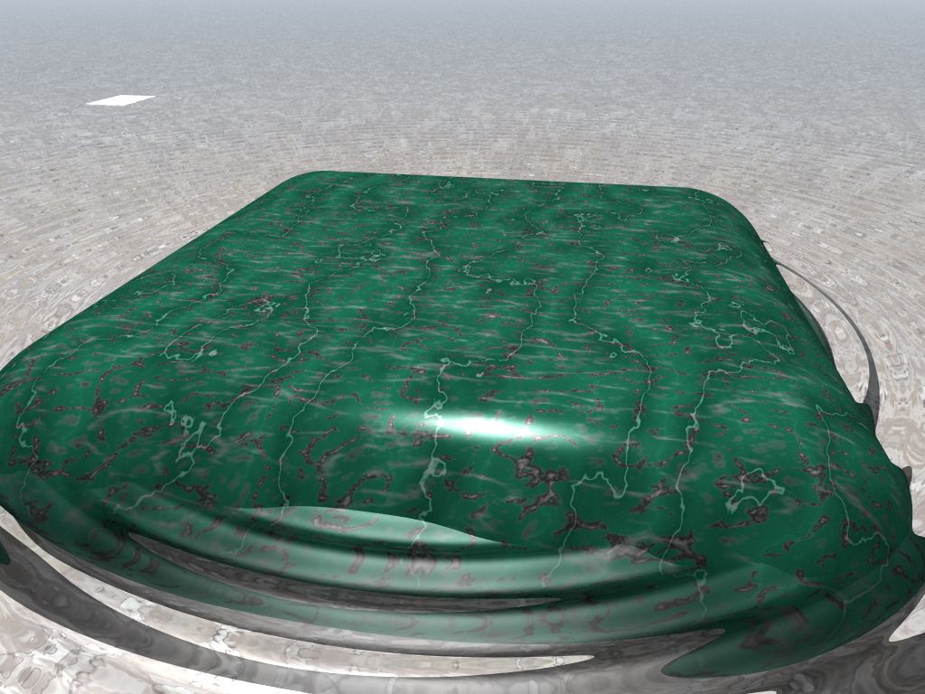

Well, let's somewhat better... (Although there's still no glassware.) It
seems just putting something *under* the water made all the difference.
(It's Stone8 from stones.inc. Unfortunately, it appears to have a
nonzero ambient setting. *sigh* So I will have to use some other texture
for the final render...)
Download 'glassware03-final.jpg' (121 KB)
Preview of image 'glassware03-final.jpg'
You're getting there.
The color of water is determined by what's underneath it because water by
itself is colorless. Have a look at a swimmingpool :)
I have removed ALL ambient settings from all predefined textures. that way I
can control everything in the main file without having to worry about
textures being too bright.
Ger

"Orchid XP v3" <voi### [at] devnull> a écrit dans le message de news:
452d4f41@news.povray.org...
That's better indeed :)
For the  Stone8, why don't you copy and paste it in your pov scen so you can
change the finish settings?
And what is this strange square on the left?
Marc

Because, being a predefined texture, the parts that make it up are
actually declared in 12 seperate places and then gradually merged
together... heh.
By the way, forgot to mention... 9 hours + 50 minutes render time.
(Can't wait to do the radiosity version!)
If anybody can figure out what the hell that actually is, LET ME KNOW! >_<
I theorise it's something to do with the edge of my isosurface. The
water around the stone block is an isosurface, but the infinite stretch
of water in the background is a flat plane. That square is roughly on
the seam between the two...
Weirdly, I changed the ground texture and the square vanished. Go figure!
452d5c31$1@news.povray.org...
> together... heh.
Oh sorry I forgot that, I didn't use predefined textures for a long time,
and now I remember that is one of the reasons :)
For the moment your scene does not need radiosity does it?
 Arthur Dent's towel?
Strange
Strange again
Marc
looks nice.
in my eyes water is too clean. maybe you try to add wrinkles on surface.
second suggestion: when I let fallen an cube into water I do not see one
concentric circle, I see four running away from every side of my cube.

"Orchid XP v3" <voi### [at] devnull> wrote in message
news:452d4f41@news.povray.org...
texture {
 T_Stone8
 finish {ambient 0.005}
I do that every time I use one of the stone textures, or they end up glowing
too much.
Swimming pools are tricky to judge.  Every one i've ever seen is *painted*
baby boy blue.
Water is colorless at the shallow depth that Orchid is rendering.  However,
water absorbs light differentially by wavelength.  Red is the first to go,
and green fades as you go deeper.  If your body of water is deep enough, it
will show blue all by itself.  (Otherwise, the oceans would be the color of
basalt and diatomaceous earth.)

It's a bit brute force but you can always do:
global_settings { ambient_light 0 }
Looking much better BTW. I suggest make the ripples smaller but nice work on
the materials :)
Tek
Before using that, make sure you don't want to see the sun.  If you do, the
global ambient_light of 0 will make the sun (and reflections of it)
disappear.
Are you using media?  Try "absorption" color and put a little blue.  Also
try "extinction".
Let _magnitude represent the strength of absorption as a single floating-pt
number, such as 0.05 or 2.5, etc.
absorption rgb <0.1 0.2 0.7>*_magnitude
extinction 1
    And wouldn't that be natural in real life? What you've got to determine
is the depth of your water.
     Is it a shallow lake, or a deep sea? Shallower, clearer. Deeper,
darker.
     Also, if that's 9 hours 'work' time, then you need to reduce that.
That's wasted chat-up lines...  ;)

"Orchid XP v3" <voi### [at] devnull> schreef in bericht
news:452d5c31$1@news.povray.org...
> together... heh.
You could , like Alain did for metals.inc, change all the stones.inc ambient
statements and save it as a stones2.inc (or whatever).
Solves the problem.
> disappear.
If you must... :-)
   looks_like
   {  sphere
      {  0, R

From: Orchid XP v3
Subject: Re: A more successful render (~120KB)
Date: 12 Oct 2006 13:34:16
Message: <452e7c98$1@news.povray.org>
> looks nice.
Thanks.
Possibly... OTOH, I'm going for a "clean" look. We'll see.
> texture {
>  T_Stone8
> too much.
I tried that, but it didn't seem to affect the image in any way... (But
then, I tried to set it to 0.)
> baby boy blue.
I've heard this one before... Does water actually absorb light, or is
this due to scattering like with the sky?
It does once you turn off the ambient setting on the sea floor. :-S
(Actually, the radiosity version I'm working on is really quite nice.
But... slow.)
> Strange
Uh, yes.
> Strange again
And also yes...
I can only think it's some kind of internal reflection issue, or maybe
something about coincident surfaces...

From: Trevor G Quayle
Date: 12 Oct 2006 14:00:01
Message: <web.452e820fe7485ee6c150d4c10@news.povray.org>
> > baby boy blue.
http://www.seafriends.org.nz/phgraph/water.htm#colour
All you need to know about water and light.  I used this for the basis of my
underwater scene at the CGTalk lighting challenge "Under the Boardwalk".
I found it much more effective to leave the water perfectly clear (rgbt 1)
and use absorption and scattering media (no attenuation either).  Basically
you absorb the inverse of the water colour.  The colour of the scattering
(if you want scattering) should be based on the scattering particle colours
(i.e. dirt, algae, etc.).  In my example below you will need to play with
the numbers in the fade distance function (FD) according to the scale of
your scene.
-tgq

#declare WCol=rgb <0.51373, 0.70588, 0.70588>; //water colour
#declare MWater=
  material{
    texture{
      pigment{rgbt 1}
      finish{conserve_energy  diffuse 0.0  ambient 0  reflection{0 1 fresnel
on metallic 0}}
      normal{P1}
    #local FD=-(1000/(6*25.4))/ln(0.58);
    interior{
      ior 1.33
      media{
        absorption rgb 1-WCol //coastal
        density{rgb 1/FD}
      media{
        method 3
        //intervals 12
        //samples 60,100
        jitter 0.5
        scattering{4,rgb <0.74118, 0.71765, 0.41961>}
        density{
          bozo
            color_map {
              [0.0 rgb 1/100]
              [1.0 rgb 1/200]
            scale 1/2
//END
-tgq
