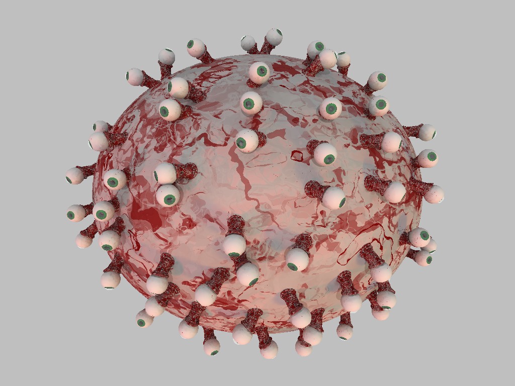

I must admit I've been playing with monsters lately, and it's been lots
of fun! Please note the scaled spheres under the eye balls and how they
are not rotated correctly to lay on the surface of the large sphere. I
haven't been able to figure out how to do this properly yet. Any
pointers or suggestions would be greatly appreciated!
Download 'eyesphere.jpg' (218 KB)
Preview of image 'eyesphere.jpg'
From: Artemia Salina
Subject: Re: Playing with Monsters
Date: 2 Jul 2006 00:06:32
Message: <44a74648$1@news.povray.org>
I should've mentioned that I placed the small spheres and eye balls on
the large shpere using the trace function. As I say I'm having a hard
time calculating the correct rotation angles to have the small spheres
lay flat on the large sphere (if they were cylinders they would radiate
outward from <0,0,0>)
Date: 2 Jul 2006 17:19:22
Message: <pan.2006.07.02.21.19.21.472772@sheayright.com>
On Sun, 02 Jul 2006 16:50:23 -0400, Norbert Kern wrote:
> Artemia Salina <y2k### [at] sheayrightcom> wrote:
>> I tried Norbert's suggestion last night (see his article in this thread)
>> and it didn't work. I played with swapping the sign for the x and z axes
>> but still no luck.
> It should work, believe me!
> Here a bit more code, which shows what I mean -
> #declare Norm = <0,0,0>;
> #declare loc = trace (M1, start, <0,0,0>, Norm);
Oh, I think I see what's going on. Instead of <0,0,0> for the direction
vector I'm using <0,0,-1>! I don't know how or why I did that. I'll retry
with your suggestion, Norbert.
Thanks again for the assistance!
Date: 2 Jul 2006 18:03:58
Message: <pan.2006.07.02.22.03.54.579706@sheayright.com>
On Sun, 02 Jul 2006 17:32:01 -0400, Norbert Kern wrote:
> My fault, <0,0,0> doesn't work!
> I don't know, how you come to your start coordinates for trace (start), but
> if the base sphere is centered at <0,0,0>, the direction has to be -start.
> Norbert Kern
Here's a the code that I'm using (with most texturing removed for clarity). The
RRand() just provides some irregularity to the final positioning of the eyes
and makes the eyeballs look in different directions (rotating them in their
sockets).
So Start would be
<-90, -90 (plus some randomness), 0>
And it would end the scanning at
<90 (plus some randomness), 90 (plus some randomness), 0>
#declare BSB = sphere{0, 11 scale <1, 0.85, 1>};
#declare CntX = -90;
#declare CntY = -90;
#declare ZZ = <0,0,-1>;
#declare N1 = seed(12345);
#while(CntY < 90)
        #while(CntX < 90)
                #declare POSB = trace(BSB, <CntX, CntY + RRand(-0.95, 0.95, N1), 0>,
ZZ, Norm);
                #if (!VZero(Norm))
                merge{
                        object {Eye(Green*0.5, .70)
                                // Make eyes look in different directions
                                rotate <POSB.y*RRand(4, 20, N1), -POSB.x*RRand(4, 20,
N1), 0>
                                pigment{rgbt 1}
                        sphere{<0,0,0.55>, 0.75
                                texture{pigment{rgb <1, .9, .9>}}
                                // Flatten the spheres a bit
                                scale <1.3, 1.3, 0.95>
                                // This rotation was what I was using and it was
close:
                                // rotate <POSB.y*8, -POSB.x*8, 0>
                                rotate <degrees (atan2 (Norm.z,Norm.y)),0,-degrees
(atan2(Norm.x,Norm.y))>
                        translate POSB
                #end
                #declare CntX = CntX + 3 + RRand(-0.55, 0.55, N1);
        #end
        #declare CntY = CntY + 2;
#end

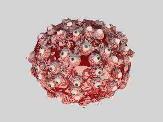

#while(CntY < 90)
        #while(CntX < 90)
N1), 0>, ZZ, Norm);
                #if (vlength (Norm)!= 0)
                merge {
                        object {eye}
                        sphere{<0,0,0.55-0.55>, 0.75
                        rotate <RRand(-20, 20, N1), RRand(-20, 20, N1), 0>
                        Reorient_Trans (y,Norm)
                        translate POSB
                #end
        #end
#end
object {BSB pigment {color rgb <1,0,0>} finish {ambient 0}}
//________________________________________________________________
Download 'rotation_issue.jpg' (65 KB)
Preview of image 'rotation_issue.jpg'
Date: 4 Jul 2006 13:11:08
Message: <44aaa12c@news.povray.org>
Norbert Kern wrote:
> Hi,
> I came up with this solution. Hope it helps.
> Don't know, why my rotation tip failed - but Warp's hint works always albeit
> being less flexible.
This method worked just fine, Norbert!
Thanks again for your help!
Download 'eyesphere.jpg' (158 KB)

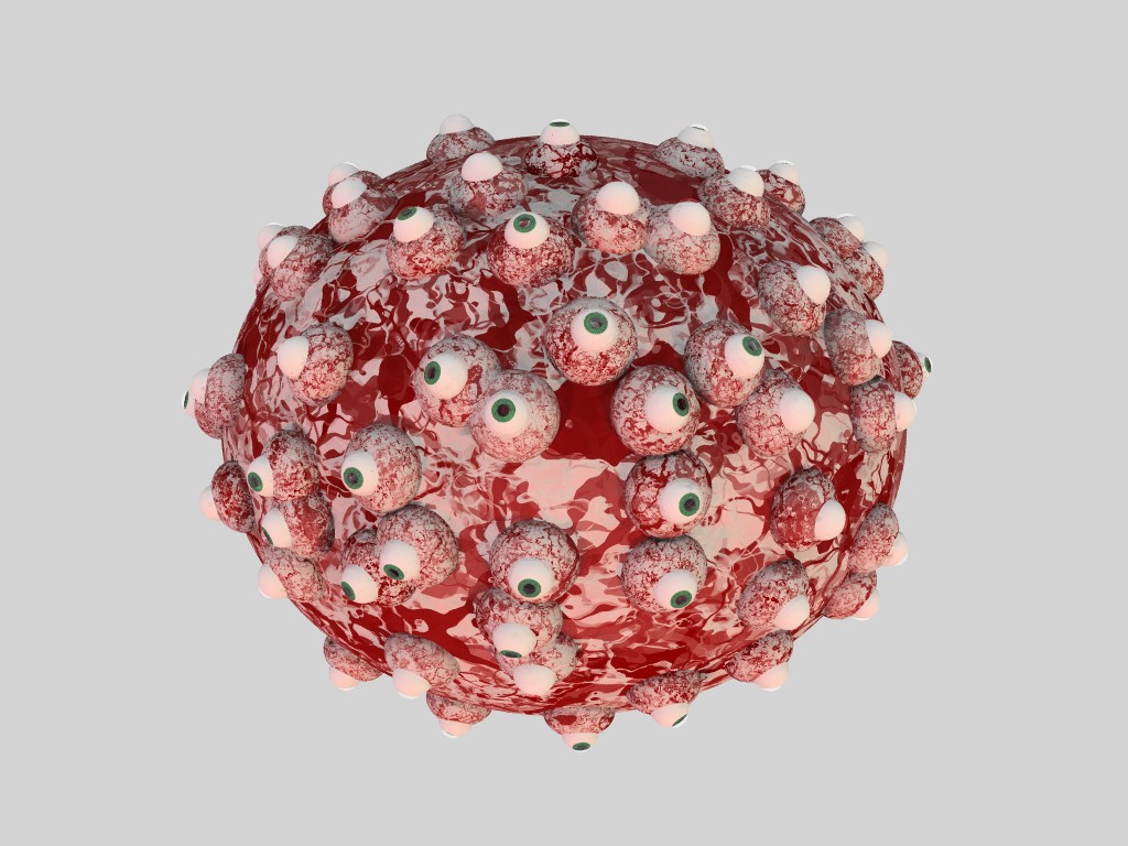

Date: 10 Jul 2006 12:40:35
Message: <44b28303@news.povray.org>
Paolo Gibellini wrote:
> Hallo, Artemia!
> The texture of the monster is very interesting: how did you realized it?
It's just a color map using a turbulated mandel pattern. I have it set
up as a macro using a color ("Red" from colors.inc) passed as a
parameter, and rbgt 1 to make it layerable. Depending on how it is
adjusted you can get some interesting textures. The image below shows a
convincing raw meat texture (I've forgotten the parameters to get that
texture) but it was several layers using Red and White.
#macro BloodShot(N, T, C, S)
texture{
         pigment {
                 mandel (5000  * RRand(1, 5, N)) / S
                 turbulence RRand(0.2, 10.9, N)
                 rotate <0, 0, RRand(0, 360, N)>
                 translate T
                 color_map {
                         [0.010  rgbt 1]
                         [0.010 C ]
                         [0.210 C ]
                         [0.210 rgbt 1]
                         [0.900 rgbt 1]
                         [0.900  C ]
                         [0.900  C ]
                         [0.990 rgbt 1]
#end
> Could be interesting with some normal, in order to obtain a vascular system
> relief effect.
I'm thinking of adding actual veins to the monster's head and body. This
thing is far from being done :-)
Download 'meatloaf.jpg' (156 KB)
Preview of image 'meatloaf.jpg'
