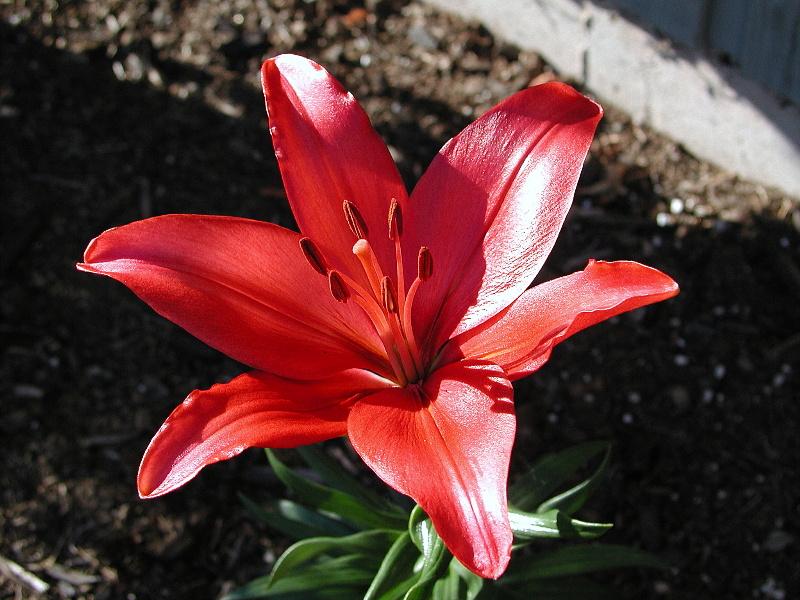

From: Jim Holsenback
Subject: Re: Flower study WIP 01
Date: 15 Apr 2006 07:15:02
Message: <4440d5b6@news.povray.org>
Here's a photo of a Day Lily growing (last year) in my front yard ....
Download 'Day Lily Red.JPG' (228 KB)
Preview of image 'Day Lily Red.JPG'
Date: 15 Apr 2006 15:48:58
Message: <44414e2a@news.povray.org>
"Alain" <ele### [at] netscapenet> wrote in message
news:44410cf7$1@news.povray.org...
> Very nice photo. In french, we call those "lis" or "lys". Mostly white but
> also found in many other colours.
Thanks .... I posted it as a comparison  .... I think Rune has done a
fantastic job! I'd be interested in seeing the finished work.
Jim
From: Rune
Date: 15 Apr 2006 17:06:25
Message: <44416051$1@news.povray.org>
That's a great reference image. Thanks!
In case you have the image in higher resolution, I'd appreciate it if you
could send it to me. But even as it is, it's of better quality then the
images of red lilies I could find with Google.
Rune
http://runevision.com

"Rune" <new### [at] runevisioncom> wrote in message
news:44416051$1@news.povray.org...
I sent two images (red one posted) and an orange one .... I went to your
website and used an email address I found
Jim
