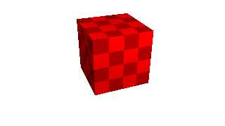

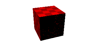

There seems to be a bug in the f_rounded_box function
when used with a zero radius. The documentation reads
for this case: "Zero gives square corners".
When used in an isosurface this appears to right only if
the bounding box exactly fits the now not more *rounded* box.
But if the bounding box is slightly increase there appears
a broken surface.
The first image shows an isosurface with exactly fitting bounding
box (means contained_by{ box{...} }) whereas the second one
shows the same isosurface with slightly increased bounding box.
The scene file is in p.b.scene-files.
Is this a known problem/bug?
I'm using POV-Ray 3.6.1
linux gcc (GCC) 3.3.5 (Debian 1:3.3.5-13).
Sebastian
Download 'frb_nobug.png' (5 KB) Download 'frb_bug.png' (4 KB)
Preview of image 'frb_nobug.png'
Preview of image 'frb_bug.png'

I noticed that the slow down only seems to be happening with the
processing of shadows. If you add the no_shadow keyword, or move both
lights round to the front, then the isosurface renders quickly, but it
still has speckles.

The docs are wrong, f_rounded_box() should only be used with radius > 0.
  This is not a bug but simply a limitation (although it would of course
make sense to add an efficient handling of the case radius=0).

To me it seems this offset is specifically for handling the degenerate
case.  Choosing 1e-3 simply gets you beyond your accuracy limit.

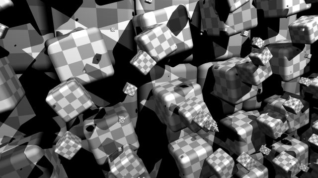

Here's the image of the test scene I used for comparing
the speed of different incarnations of f_rounded_box.
Actually I desired a more ordered scene but a typo ended
in this fractal beauty...
Sebastian

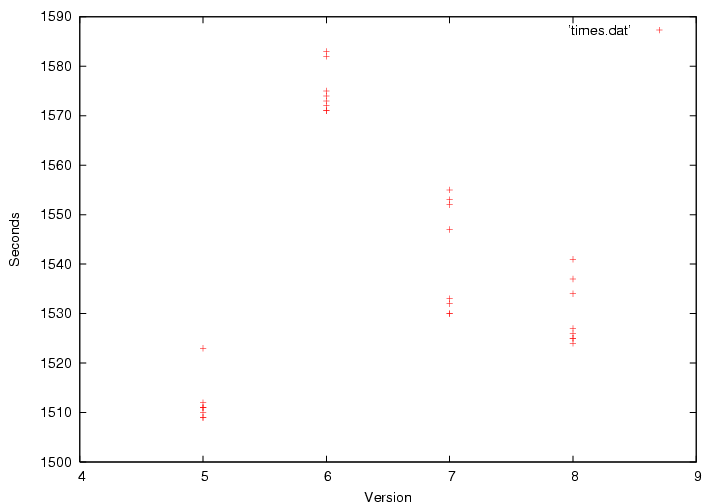

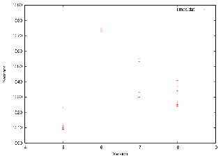

From: Sebastian H
Subject: Re: Problem with f_rounded_box function
Date: 15 Mar 2006 04:48:08
Message: <4417e2d8@news.povray.org>
Here are the render times for the different versions
of f_rounded_box which are to find in p.programming.
Download 'times.png' (11 KB)
Preview of image 'times.png'
