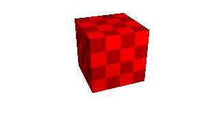

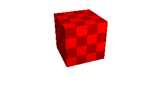

Hello
There seems to be a bug in the f_rounded_box function
when used with a zero radius. The documentation reads
for this case: "Zero gives square corners".
When used in an isosurface this appears to right only if
the bounding box exactly fits the now not more *rounded* box.
But if the bounding box is slightly increase there appears
a broken surface.
The first image shows an isosurface with exactly fitting bounding
box (means contained_by{ box{...} }) whereas the second one
shows the same isosurface with slightly increased bounding box.
The scene file is in p.b.scene-files.
Is this a known problem/bug?
I'm using POV-Ray 3.6.1
linux gcc (GCC) 3.3.5 (Debian 1:3.3.5-13).
Sebastian
Download 'frb_nobug.png' (5 KB) Download 'frb_bug.png' (4 KB)
Preview of image 'frb_nobug.png'
Preview of image 'frb_bug.png'

I dug a bit in the source code and found that a
change in fnintern.cpp fixes the problem.
In the f_rounded_box function there is an offset
of 1e-6 subtracted from the actual result.
return (... - 1e-6);
With an increased offset magnitude of 1e-3
the problem disappears and the isosurface looks correct.
Why this offset is there is beyond me but removing it
slows down the isosurface rendering a lot.
Sebastian

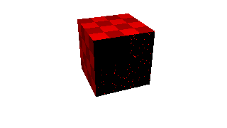

I noticed that the slow down only seems to be happening with the
processing of shadows. If you add the no_shadow keyword, or move both
lights round to the front, then the isosurface renders quickly, but it
still has speckles.
Mike Williams
> still has speckles.
I tried a scene with many isosurface with different parameters for
f_rounded_box and found that removing the offset reduces the overall
render time for the scene by about 2%. Though "a lot" slowdown is
overestimated it is noticeable.
I have a wip scene which uses f_rounded_box a lot and unfortunately
no shadow is not an option. But thank you for the hint anyway.
Sebastian

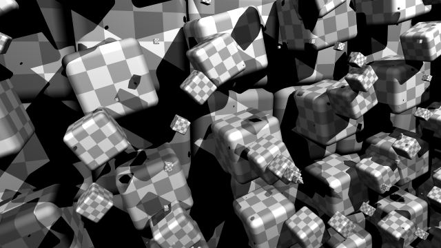

Here's the image of the test scene I used for comparing
the speed of different incarnations of f_rounded_box.
Actually I desired a more ordered scene but a typo ended
in this fractal beauty...
Sebastian

From: Sebastian H
Subject: Re: Problem with f_rounded_box function
Date: 15 Mar 2006 04:48:08
Message: <4417e2d8@news.povray.org>
Here are the render times for the different versions
of f_rounded_box which are to find in p.programming.
Download 'times.png' (11 KB)
Preview of image 'times.png'
