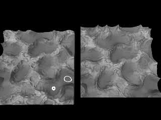

OK. Time for one of my stupid questions.
From one function, I want to render an isosurface as well as a height_field,
following Mike Williams' tutorial. After some trial and error, I obtain the
image posted here. The problem is that the height_field (to the right) is
not centered at exactly the same location as the isosurface (to the left).
And I am unable to find out why, or what I should do about it. I am sure the
answer is ridiculously simple and if a gentle soul could help me in my
darkness, I would be most grateful :-)
I shall post the scene file in p.b.s-f under the same name.
Thanks (many!)
Download 'Iso-HF_test.jpg' (38 KB)
Preview of image 'Iso-HF_test.jpg'

The problematic code is :
isosurface {
   function {y - P(x, 0, 1-z)}
which you can replace with
isosurface {
   function {y - P(x, 0, -z)}
which works fine :-) Amazing what a nasty char can do...
The explanation is that you just want to reverse the z-axis to be
coherent with the height field. By writing  P(x, 0, 1-z) not only do you
reverse the z axis, but you translate it as well...
Hope this helps
Vincent

Incidentally, your image makes a cool stereoscopic effect if you view it
with your eyes crossed, lining the images up.
 - Slime

oh-oh! A little error in Mike's tutorial, eh? :-)
I shall try this out! Thanks a lot!
