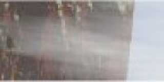

From: POVMAN
Subject: Re: Alien Cliff...again [~150kB]
Date: 3 Feb 2006 08:01:40
Message: <43e35434$1@news.povray.org>
Great Image, I'm soooooooo jealous.
Some thoughts from "Mr Rent-An-Opinion"
The "particles" of the waterfall seem too big near the bottom.  I think the
water need to be more spray-like or more solid.  The water looks like it has
broken up into "lumps".
The Waterfall could do with a mist around its lower half.
The "lens flare" is a little overpowering.
The cloud above the lens flare seems to have small ridges, see the attached
image.
I see that Tim thinks you might add some more colour depth.  I think the
opposite.  The colour level is perfect, to my eyes.
POV Tips and Hints at ...
http://povman.blogspot.com/
Download 'ridges.jpg' (3 KB)
Preview of image 'ridges.jpg'

> to some very exciting images.Considering that I seem to be wed to one
> continuous project, I value the variety of work coming from most members
of
> this community. Quality is steadily improving and it is exciting to see
new
> users.
> I am reminded of reading The Dragon Riders of Pern when I was younger. I
> very much like the layers in this image and the way the color of the cliff
> face is picked up by the plants on the plane in the foreground.
> Excellent work Thomas!
Thanks indeed!
Although I had not Pern in mind when I started this image, I must admit that
it is moving somewhat in that direction. Yes, the cliff and plant colors are
intentionally similar.
Date: 3 Feb 2006 08:50:52
Message: <43e35fbc$1@news.povray.org>
"POVMAN" <s### [at] acom> schreef in bericht news:43e35434$1@news.povray.org...
Thanks!!! No need to be jealous :-) it's just tedious, hard work ;-)
the
has
The waterfall is still an issue. Much better than when I started
implementing, but still... Need much more work. Possibly, spray.inc which I
used for it will not do in the end.
I wonder what I am going to do with it... I am not really satisfied myself.
attached
> image.
Yes, this is a matter of taste. Personally, I am fairly content with the
present colour depth. But I might experiment some more...
Date: 3 Feb 2006 08:52:30
Message: <43e3601e@news.povray.org>
"Ger" <No.### [at] ThankYou> schreef in bericht
news:43e358ac@news.povray.org...
> Thomas de Groot wrote:
> > A new version of the Alien Cliff.
> > Added have been: cloud, waterfall, "birds".
> > This time, a larger version. Slow rendering (about 36 hours in total)
> > especially for the lower half of the image.
> > I am curious about any comments of course!
> > Thomas
> Looks very good... You really got the "huge-ness" factor in there now.
> Just one nitpick, I think the lensflare is too big, too there.
Thanks a lot!! That lensflare is definitely causing trouble at this stage
:-)  Will have to be corrected!!
From: Stefan Viljoen
Date: 3 Feb 2006 13:19:11
Message: <43e39e9f@news.povray.org>
Thomas de Groot spake:
> Thomas
Excellent! Looks like some painting by Jon Lomberg from the book Cosmos by
Carl Sagan... very conceivably an alien landscape.
Stefan Viljoen
Polar Design Solutions
From: Jim Charter
Date: 3 Feb 2006 13:30:15
Message: <43e3a137$1@news.povray.org>
> Thomas
Yes, I think you are taking it in the right direction.  I think adding
more elements improves this picture.  Moving the balloon closer adds a
lot.  Allows us to mentally "enter" the scene.  The waterfall is a great
element but needs work yet I feel.  I question its placement.  Too close
to the center of the composition and it cuts the cliff edge right next
to where the moon cuts the cliff edge.  And I question its realness.  It
really needs to suggest falling water in order to emphasize the sense of
height of the cliff. I think there needs to be a sense of the water
breaking up and vapourizing as it falls.  Where ever you put it, it is
going to be an attention getting element in the scene and as such will
need to be spot on.  I think the hazy clouds might be too much.  Maybe
make them more of a hint?
From: Jim Charter
Date: 3 Feb 2006 13:36:20
Message: <43e3a2a4$1@news.povray.org>
> The yellow lit area comes from the background height_field. It is in fact
> one of the used texture colors. Was not deliberate and is, IMO, too visible.
I love that part!
From: Orchid XP v2
Date: 3 Feb 2006 14:42:04
Message: <43e3b20c@news.povray.org>
> The washed-out look comes mainly from the ground fog. I am not too
> displeased with that as it is intentional for the landscape. The cliff for
> instance is much sharper / neater than the landscape under some kind of
> tropical blanket. But everything can certainly be tweaked more indeed!
How on earth do you "tweak" an image that takes 36 *hours* to render? o__O
Sheesh... you have way more patients than me!
(Not, of course, that I consider this a BAD thing... You seem to have
produced a pretty cool image as a result.)
From: Orchid XP v2
Date: 3 Feb 2006 14:46:03
Message: <43e3b2fb$1@news.povray.org>
Eeeps! o__O
I'd offer you render power... but it's kind of impractical. Soz. :-/
I think the mist is maybe a little OTT.
Perhaps make it more patchy, or make it hug the surface more closely or
something... I'm not sure. You'd have to play with it...
I really do like those plants though.
From: stm31415
Date: 3 Feb 2006 18:50:01
Message: <web.43e3eb0b220a2816b3eb90420@news.povray.org>
> Thomas
Very pretty.
My main problem with the waterfall is not hte way it looks (though it would
be nicer if you worked on that) but is it's geological effect on the
surroundings. It seems to have had no effect whatsoever on the cliff.
Either put a dent in the cliff (hard?) or move and scale the waterfall so
as to place it in an extant dent.
-s
5TF!
From: s day
Message: <web.43e3eb6f220a28162a868be00@news.povray.org>
> Thomas
This is looking really good and is better than the earlier post, I like the
balloon it helps to give scale to the rest of the image, also I agree with
the many comments about the bottom of the waterfall. At first I wasn't so
keen on the colours but the more I look at it the more I like the 'washed
out' look, it makes it look less rendered and more like a painting/drawing.
At 36 hours I wouldn't fancy turning on radiosity..
Great work.
Sean
Date: 4 Feb 2006 02:18:08
Message: <43e4552f@news.povray.org>
Orchid XP v2 spake:
>> for instance is much sharper / neater than the landscape under some kind
>> of tropical blanket. But everything can certainly be tweaked more indeed!
Hey! I've got a trace of something I didn't design (I just modified it)
which has been running about 600+ hours so far...
Stefan Viljoen
Date: 4 Feb 2006 03:23:01
Message: <43e46465@news.povray.org>
"Jim Charter" <jrc### [at] msncom> schreef in bericht
news:43e3a2a4$1@news.povray.org...
fact
visible.
> I love that part!
Well... I am not sure. However, it may be considered the equivalent of  "le
petit pan de mur jaune" (the little piece of yellow wall) that Marcel Proust
writes about when describing the View of Delft by Vermeer.
Yes. Now that I think about it, I shall leave it as a statement!
Thanks Jim, for starting up my brains again!
Date: 4 Feb 2006 03:29:42
Message: <43e465f6@news.povray.org>
news:43e3a137$1@news.povray.org...
Right on the spot, Jim!
I have not been too happy with the waterfall's location. I mainly did choose
it because it was a lower part of the cliff. However, it does not work well
with the moon here. And, indeed, it is too centrally placed. More work
needed here.
The clouds: I put them in to judge their effect. Still not what I would
like, though.
Date: 4 Feb 2006 03:32:35
Message: <43e466a3@news.povray.org>
"Orchid XP v2" <voi### [at] devnull> schreef in bericht
news:43e3b2fb$1@news.povray.org...
> Eeeps! o__O
Thanks! Don't worry, I'll manage :-)
Depends on the intention. I probably shall experiment a little bit more with
that.
Yep! The red ones have already been changed again though.
Date: 4 Feb 2006 03:35:22
Message: <43e4674a@news.povray.org>
"Stefan Viljoen polard.com>" <spamnot@<removethis> schreef in bericht
news:43e39e9f@news.povray.org...
Thanks Stefan! Yes, the impression is of a painting, and I don't want to
destroy that, although I shall work a little bit more on it. It reminds me
somehow of the backgrounds of some (Italian) Renaissance paintings.
something you see through a window, behind the main subject of the painting.
Date: 4 Feb 2006 03:37:16
Message: <43e467bc@news.povray.org>
"stm31415" <sam### [at] cscom> schreef in bericht
news:web.43e3eb0b220a2816b3eb90420@news.povray.org...
> Very pretty.
would
Well, it *is* in a lower part of the cliff, but I agree that it looks
somewhat artificial there. Oh well, there is still a lot to do on it!
Date: 4 Feb 2006 03:41:59
Message: <43e468d7@news.povray.org>
news:43e4552f@news.povray.org...
> Orchid XP v2 spake:
o__O

I would like to "tweak" it to a more rapid render indeed!!! You have to find
a balance: less objects and faster render but less interesting image, or
more objects and slower render but more interesting image.
I am not sure about this, but I assume that it is the calculation of the
lightfall and shadows of the object elements that takes all the time?
> Thomas
very impressive,
I like the overall look of this image, especially the colors ....
The waterfall fits quite good as eye-candy in the background. The dropplets
should be getting smaller in the lower part. Also a misty cloud at the bottom
would help to imply the enormous height of the fall.
As you have a small lake in the forground you could also add a shallow river
coming from the fall to feed this lake. Could bring some reflective highlights
to midplane of the image.
... dave

The waterfall still needs work. I have a media ready to make the mist at the
base. However, I know that that is going to increase my render time, so I
have postponed that till now.
river
highlights
I shall have to think about this. It depends on what I am going to do with
the isosurface...

> And 36 hours, sheesh, at was resolution are you rendering? :-) Is it just
> because of the isosurface, or is there lot of media in there? If it's
> isosurface...
I found the culprit! It is the texture used for the landscape. I embedded a
slope texture inside another slope texture. Now, this works fine, but is
very slow, and not really essential in this scene. I corrected it and lo!
I'm sure if you search around you can find data on these NGs somewhere,
but basically the thing that typically takes most of the time in
raytracing is figuring out which object(s) a ray actually intersects.
(They recon ray intersection tests typically make up 80% of the
calculation - obviously depending on what you're drawing.)
This is probably *especially* true with isosurfaces. Gotta do a whole
adaptive sampling process for each ray intersection there. (Plus extra
calculations to find the surface normal.)
Once you have the ray intersection coordinates and the surface normal,
actually figuring out the lighting is a tiny little calculation. (Except
that if you want shadows, gotta shoot *more* rays... And if you have
area lights, gotta shoot *loads* more rays...)
This is why POV-Ray [currently] has bounding boxes, vista buffers, light
buffers, etc. It's all the try to reduce the number of ray intersection
tests...
[I understand the new beta might be using kD trees or something... not
finalised yet.]

You know what? I did some testing indeed..... render time dropped
vertiginously!! I am seriously thinking not to implement that item... :-(

It's interesting that there's a whole range of scene planning / modelling
skills that have no impact at all on the final image but can make the
rendering time feasible as opposed to prohibitive. It's always worth trying
for speed. That's why I'm building my knots out of meshes - I tried it as a
sphere_sweep originally and it took hours - at the moment 35,000 meshes
only take 35 minutes (that's with area lights and at 1024x768).
That said, patience is a virtue when the chips are down. Like Stefan, I
often leave renders running for 100s of hours, usually on my office PC
overnight or at weekends.
Keep up your productive patience!

Thanks Bill. Yes, I agree with you.In the present case, I have lost again
quite a lot of render speed by using a more complex plant (mesh2 of course).
And now I have included also a media mist at the base of the (moved
elsewhere) waterfall.
Patience I have (in Yoda speak)... I think the end result will be very
interesting.

Yes, going well, and the next version is pending (veeeeery slow because of a
media simulating the vapor at the base of the waterfall!!)
Good idea about the Pteranodons! I used the standard textures that came with
them, but I am going to change that. Thanks for mentioning that feature.
Maybe a leopard texture would be nice....
