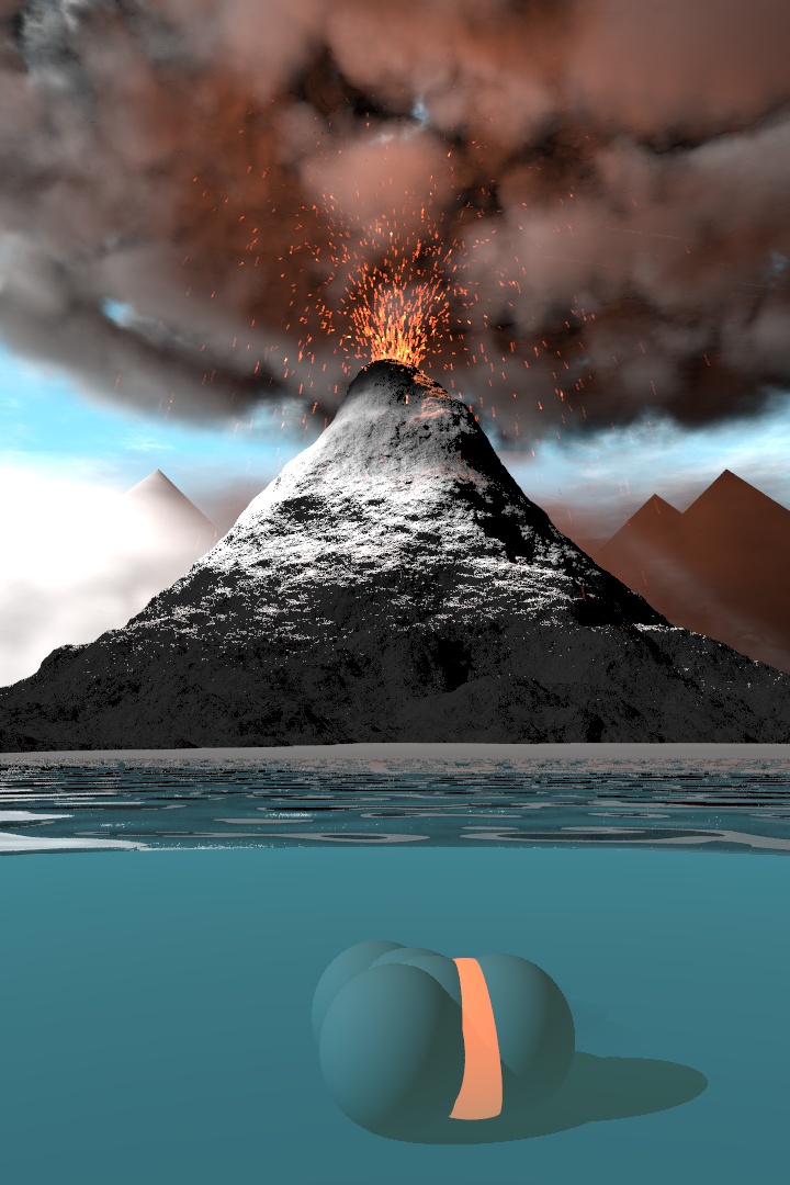

Following my earlier post I've decided to go with the volcano image. This is
the latest version, but I'm suffering a case of povver's block! I can see
the volcano looks bad, but I don't know why. Any suggestions?

It might be because I expect the volcano to loom over me. Even though
I am sure the view is correct. It might be a case of Real Life not
living up to Hollywood Movies.
A bit unsettling but I like it.

To me, the volcano looks too black - it's hard to make out any details
of the surface. My feeling is it should be a bit brighter (or perhaps
just lit better), even if it's made out of lava.
The lava flying out of the top is nice, but my inner view expects the
individual drops to be greater, perhaps even more drop-shaped along
their flying axis.
Looks like it's going to be a great image, though!
Florian
I think that *is* hollywood. Volcanos (and mountains in general) are too
big to loom. By the time they're looming, you're standing on them and
they're under you.
Now, volcanos I think don't tend to be quite so vertical, nor quite so
symetric.  There would probably also be outbreaks of lava on the slopes
as well. It does, after all, melt through rock.
The smoke seems very symetrical also. If there were no wind, I'd think
it would be going mostly up, or up then back down in an umbrella-like
shape. Maybe having the smoke going one way and the lava coming down on
the other side would give a nice balance.
I also doubt you'd find snow on the slopes of an active volcano, as it's
not unusual for the ground to be like 3000 degrees six inches down. I
was caught in a rain storm once in Hawaii that came down so hard you
couldn't breathe if you weren't looking at the ground. My feet stayed
dry, because the rain all evaporated somewhere around my knees. This was
at tourist distances from the lava, too, not like I was in there taking
samples. But of course getting rid of the snow would ruin the artistry
of the image, so that's more a nit than anything.
The ground is both too black and too bare. Lava is very shiney, as the
surfaces were all liquid a short time ago and cooled under gravity. It's
mostly brittle and crunchy, like blown glass. Plus it's full of
delicious plant nutrients, so even days after an eruption, you get grass
there, saplings, etc.
The water near the shore looks kind of grey, but I don't know if that's
correct or not. Unless that's supposed to be a beach or something.
I'm looking forward to how you manage the glow of the lava. :-)
The "something look's wrong" feeling is maybe due to the fact, that normaly the
tip of the volcano is blown off if you have such a vivid erruption, leaving a
crater huger then the lava fountain. Also a lava river rinsing from a break at
the top would make it more Hollywood like.
... dave

I'm sure our ideas on what a volcano should look like will differ with what
kind of mountains are nearby.  For me, here are the two I think of first
when I think 'volcano'since they're the neighborhood mountains (climbed
Helens, skied Hood.) They probably won't be much help for lava realism
though.  I agree with Darren about the symetry & verticality.  Hood is
fairly conical but still a lot flatter and irregular than how your mountain
is now.  St Helens apparently was once noted for how symetrical it was
(prior to what it's most famous for - it's 1980 dissappearance of it's
top). :
http://en.wikipedia.org/wiki/Mount_St._Helens
http://en.wikipedia.org/wiki/Mt._Hood
Also, something about the lava (which I associate with places like Hawaii)
rather than ash/steam, and the light color of the water makes me think
'tropical' which is incongrous with the snow. If the snow is due to
elevation I would expect foothills or something to show that the body of
water is a mountain lake or something.   On the other hand,  in response to
Darren, Mt St Helens is an example of an active volcano that does have
snow.
Hmm, anything else... How far away is it?  Maybe some haze?

I agree with that last idea. I think the volcano lacks a feel of depth
somehow, and a haze could really help. You could play a bit with the
lighting as well, to make the overall shape more perceptible.
There is also something that disturbs me with the texture, but I can't
exactly spot it now... Maybe it's just to sharp ?
Otherwise the cloud looks really impressive already... Last time I
attempted a thing like that I failed miserably ;-) I think you're on the
right path with this one !
Maybe some more snow near the top. Make the lava ejection narower, between 1/4 and 1/2
the diameter
of the top and uncenterer. As it must be a volcano awakening, there can be snow up to
the rim and
inside of the crater, there should be a lot of steam. One or two steam column rising
from somewhere
on the slopes can add much interest.
The background mountains are WAY to conical.
I would expect the water to be mostly dark gray, it reflect mostly the dark ash cloud
and should not
be as blue as it is now. It's colour should comes from what over it and from some
fade_color.
Adding caustics can improve the aquatic effect. I don't think that using photons here
is worth the
effort nor the increased render time.
If you are short on time, I propose that you drop the under water part, or only have
it visible
trough the surface, disturbed by the waves: remove the cutaway in the water.
Catholicism: If shit happens, you deserve it.

I'm not sure but maybe something like this (Photoshop cheating)
Download 'volcano2.jpg' (88 KB)

Seeing Mt St. Helens and Mt. Hood every day it's not cloudy and raining
around here, I have a few suggestions, but they may not actually apply.
1) Around here the rock is light gray, and the trees are that dark Fir green
color, but with distance they both turn a medium blue-gray color.  If you
want black basalt for your cone, it may not turn quite as blue, but I
suspect you lose all sense of distance because of that.  The snow should be
a real light blue also.
2) Way too perfect and cone shaped.  The ones around here are rather
deformed, St. Helens looks almost like a ball buried 3/4 down in the ground
from most view points on the south side, but with lots of vert. stripes
where rain has made gullies so there is a rock/snow pattern across it.
Hood still has a peak, but it has a bunch of bumps, canyons, bulges, etc.
from just about any vantage point.  Maybe try pointing Google Earth at some
of the volcanoes you are interested in being similar to.
3) The undersea part still has a ways to go, I think.  At first, I thought
it was a broken open crashed spaceship or something.  Not lumpy enough for
a vent, the water seems to color it too much, but not hide it enough.
Maybe less green for artistry, or more obscure for realism.
Despite all that, It looks pretty good to me, and I'm looking forward to
seeing the final image.
> > Tek
> > http://evilsuperbrain.com
> [Bunch of stuff...]
One more thing I thought of just after the post button was hit...
That ash cloud doesn't seem right.  As someone else said it's too
symetrical, but I think worse is that it looks like it just hanging above
not coming up from...  It might just be a really large dark rain cloud the
way it is...
There I've done it again, that is the point I want to make, but much too
harsh in it's presentation.  It's not as bad as I make it out, and doesn't
need a whole lot to be really great.  Keep at it.
BTW, I like the lava better in your second image, but I think it needs some
of the cloud mixed in with it.
Jon

"Darren New" <dne### [at] sanrrcom> wrote in message
news:43d66ec3$1@news.povray.org...
> symetric.  There would probably also be outbreaks of lava on the slopes as
Good points, I'm working on all that right now :)
> The smoke seems very symetrical also. If there were no wind, I'd think it
> would be going mostly up, or up then back down in an umbrella-like shape.
> Maybe having the smoke going one way and the lava coming down on the other
Agreed, it's also way too translucent for volcanic smoke, I stopped working
on it because it looks really pretty, but it's definitely going to need to
change a lot... hopefully I can make it look pretty -and- right!
Well according to any number of discovery channel documentaries it's pretty
common. Volcano erupts, suddenly melts lots of snow, huge flooding in
surrounding areas. The specific eruption that inspired this image was Mt.
St. Helens, though the initial eruption was mostly just a huge explosion of
snow and rock, and lava might not have started spouting out of it until all
the snow was gone.
This isn't meant to be a stable eruption, so I'm going to need to work on
some more dramatic effects I think.
> mostly brittle and crunchy, like blown glass. Plus it's full of delicious
> plant nutrients, so even days after an eruption, you get grass there,
> saplings, etc.
In hawaii this is true, and that's the only volcano I've been to. but my
understanding is that volcanos that have lain dormant for a while actually
end up covered mostly in very fertile dark soil and more mountain-like rock,
and less smooth glassy rock... maybe... you know it's really beginning to
sound like I need to do some research for this image! how tedious!
That's sand, and it's a placeholder I forgot I'd left in there. Oops! Thanks
for pointing it out.
Hmm... I thought I'd get away without radiosity in this image, but I think
if I have much lava I'll need it...
Tek
Good point. I was basing the water colour on some documentary footage I saw,
but of course that was filmed in hawaii. The lava I'm not so sure about,
surely there's no reason you can't get lava in cold climates?
I think your comments on shape and how far away it is have hit the nail on
the head, I've not really thought about the scale of the scene. I have some
fog on the mountains behind the volcano, and was going to have some steam
coming off the water in the foreground, but I think in any case I need
something giving a depth cue on the volcano itself. Incidentally, at the
moment I think the water is the ocean, and we're in a fairly cold climate,
but I might change it to a lake if the image starts going that way.
Thanks for the links, that'll save me the trouble of looking for some good
reference photos!
Tek

From: Tek
Subject: Re: volcano WIP
Date: 25 Jan 2006 01:59:04
Message: <43d721b8$1@news.povray.org>
Steam columns! Brilliant idea! Thank you.
BTW the background moutains -are- cones :) I'll stick a heightfield in there
later when I'm happy with the foreground.
Thanks for all those comments, there's some good ideas in there. And
regarding the underwater bit, I really don't want to lose the cutaway, it's
what makes this image unusual, but you're right about caustics and render
times. We shall see...
Tek

>> is the latest version, but I'm suffering a case of povver's block! I can
>> see the volcano looks bad, but I don't know why. Any suggestions?
> 1/4 and 1/2 the diameter of the top and uncenterer. As it must be a
> volcano awakening, there can be snow up to the rim and inside of the
> from somewhere on the slopes can add much interest.
> dark ash cloud and should not be as blue as it is now. It's colour should
> comes from what over it and from some fade_color.
> photons here is worth the effort nor the increased render time.
> only have it visible trough the surface, disturbed by the waves: remove
> Alain

Sweet! Yeah I'm going to add a river of lava in a while, though I think I'll
write a particle system in pov so it actually flows down the mountain. Nice
eruption effect, I'm going to have to add something like that :)
Tek

"Jon Buller" <jon### [at] bullersnet> wrote in message
news:web.43d6c8f889a10e00be920ef30@news.povray.org...
> way it is...
Yup, well as you can see in the really early WIP I had this lovely complex
shape, then it looked terrible when I filled it with media so I wussed out
and now it's just a squashed sphere! I'm going to add more form too it.
Seriously don't worry about it, in my opinion that wasn't too harsh, just
good constructive criticism.
> some
I think you're referring to the photoshoped image someone else posted... :)
Tek

> quite a few of those linked above have snow and appear active.
When tha lava is very fluid, like in Awaii, the volcano get broad: the lava can flows
fast and far
away before hardening.
When the lava is thick, the volcano gets steeper: it flows slowly and can't get far
before hardening.
That make Tek's volcano a thick lava variety. Those tend to send prety big lava blobs
on the air,
when they shoot lava in the air... They also are more prone to have explosive
eruptions.
> the snow was gone.
In 1985, the Colombian volcano Nevado del Ruiz washed the town of Armero off
the map with a catastrophic snowmelt.  A massive snowmelt is forecast to be
the method Mt. Rainier will use to waste Seatle-Tacoma.
I don't recall any lava in the Mt. St. Helens eruptions; only ash, steam,
and pyroclastics.  I think the magma just blew itself into ash after the
north flank collapsed and releaved the pressure.
> > saplings, etc.
As Alain pointed out, the Hawai'ian volcanoes are fundamentally different
from the Cascades volcanoes such as Mt. St. Helens and Mt. Hood.  Low
silica (fluid) lavas cool to dark basalts; high silica (viscous) lavas cool
to lighter-colored rocks.
But not only are the form and color of the mountains different, the
eruptions are majorly different, due to the consistencies of the lavas.
Fluid lavas tend to erupt into copious, but well-behaved lava flows.  They
look like the best Hollywood-style killer infernos, with large, turbulent
pools of glowing red molten rock, giant pink gas-propelled fountains, and
rivers of lava hurtling towards the sea, everything you'd expect from
Dante's _Inferno_.  Quite a sight!  Alas, these eruptions are paper tigers;
they are so nonlethal that in Hawai'i they give tours while the volcano is
active!
Contrast that with Mt. St. Helens.  There are two tourist roads leading to
the site, and neither of them so much as approaches the base of the
mountain.  When a high-silica volcano such as Mt. St. Helens stirs, they
talk how many dozens of miles away they'll need to evacuate on 48 hours
notice.  Then the eruption itself is ugly.  Mud, flash flooding,
pyroclastic flows, hot ash all over the place, a lot of gritty smoke (the
cauliflower-like Plinian column), and nighttime at noon for hundreds of
miles around.  Color?  A drab rgb <0.1, 0.1, 0.1> or so.  The picturesque
lava may not even show up!  The visuals aren't something to pull in the
movie goers, but in real life, these are the real killer eruptions.
The blast damage is pretty cool, though.
With the smoke column you have, i'd think it would almost be mandatory.
Perhaps only at night though.  I've never seen an eruption up close,
although i've seen the volcano in Montserrat (Soufriere Hills) from a
distance, plus a lot of footage.  (Not sure i'd like to witness an ash flow
up close, in any case.) Soufriere Hills is a composite volcano, with ashy,
explosive-type eruptions.  From a distance, all i could see was varying
shades of gray: light gray, dark gray, cool gray, warm gray, all gray. :-P
However, in night time footage, the ash glows red hot (the nuée ardente),
pretty much as Pliny described it.  In daytime footage, i could see some
red glows on the underside the lateral ash flows; perhaps sunlight
overwhelms the glow, the same way that a daytime sky overwhelms the stars.
One thing is that you have a drop that's still hot in the water already,
but all followers are far away, over the halfway of the volcano itself
on the height. The lava river Rene suggested seems great, but still that
 one single glowing piece in the water somehow disturbs me.
Also the water seems to be clear (while seeing the gloving drop so
clearly), but the.. umm, bottom(?) doesn't go with that - it seems like
a blue plane, not the bottom of a ocean nor lake.
Maybe the mountains in the background are too pyramid-shaped, too, they
seem to be exported from Egypt :p.
