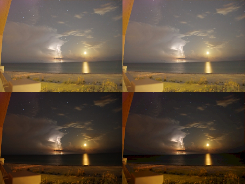

(see thread "using assumed_gamma of 1.0... a discussion", located here:
http://news.povray.org/povray.general/thread/%3Cweb.439a1b692d1f46002a1c213f0%40news.povray.org%3E/)
Anyways. My experience is this: I have a nice image_map, I follow the docs
and supply assumed_gamma of 1.0 and have Display_Gamma properly set to 2.2,
and what happens? The image_maps turn out brighter than their source. Why?
Due to the internal gamma correction of POV-Ray.
Personally, I'd like an image-map to look like it's source when its lit with
100% white light (e.g. by applying finish{ambient 1 diffuse 0}), but the
gamma-correction prevents that. The image shows this. The upper-left corner
is the pure image-map in POV-Ray. The lower-left shows the original source.
What's on the right side you ask? Well, the upper right is the image_map
"uncorrected", but passed through my gamma-correction macro using a gamma of
1.0 (to show that it doesn't "harm" the image to pass through the macro).
The lower right is the uncorrected PNG version of the image. PNG comes with
internal gamma values, and POV-Ray makes proper use of them. The problem
lies within the usual floating point (in-)accuracy. If you take a closer
look at the ocean's horizon, you'll notice color-banding and
color-clipping-like effects. That's why I'd rather not use PNGs, at least
not if they're as dark as this source.

From: Tim Nikias
Subject: Re: Gamma tests
Date: 10 Dec 2005 14:24:06
Message: <439b2b56$1@news.povray.org>
PS: I should have mentioned that the all but the upper left image have been
passed through the gamma-correction macro. I checked with an image-program
to see if the lower left (so-called "source") is actually as bright as the
source, and it is, and thus I named it "source", even though it's already
been through the macro. Just to clarify.

From: Kenneth
Date: 13 Dec 2005 03:25:01
Message: <web.439e83c351e1e6e83bb86110@news.povray.org>
"Tim Nikias" <JUSTTHELOWERCASE:timISNOTnikias(at)gmx.netWARE> wrote:
......BUT, in figuring out my own solution, I hadn't  considered the problems
you mentioned...
Are these artifacts in your original .png image, or in the POV render of it?
I'll have to scrutinize my own .png's, to see if I detect
this.
BTW, your original photo is beautiful!
Ken

From: Kenneth
Date: 13 Dec 2005 15:10:00
Message: <web.439f29c451e1e6ea36bd2010@news.povray.org>
> It's just the POV render, you can see on the other parts of the image that
> the color-banding isn't in the photo itself.
Sorry; having trouble seeing that, at the resolution of your posted image.
Post a larger version, perhaps?
BTW, I went snooping back through older posts and found one with similar
arguments for having to reprocesss image_map images to alter the gamma to
1.0...
http://news.povray.org/povray.general/thread/%3Cvp9bd1p330mntk3k9dhlfch4csv2215j12%404ax.com%3E/?ttop=221530&toff=200&m
top=219340
Ken

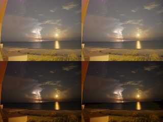

From: Tim Nikias
Date: 13 Dec 2005 21:53:52
Message: <439f8940@news.povray.org>
Here are two images, the one without banding was made with a BMP, the other
with PNG. You might want to zoom in on the shoreline with a paint program.
Tim
aka "Tim Nikias v2.0"
Download 'gamma_test_png.jpg' (112 KB) Download 'gamma_test_bmp.jpg' (103 KB)
Preview of image 'gamma_test_png.jpg'
Preview of image 'gamma_test_bmp.jpg'
From: Kenneth
Date: 19 Dec 2005 03:15:01
Message: <web.43a66ac651e1e6ed6fdca530@news.povray.org>
Thanks. This is weird: I thought I would be looking for some kind of subtle
effect--but the banding your talking about really jumped out , once I
brought your image up in Photoshop and brightened it. Talk about not seeing
the forest for the trees! :-) If what I'm seeing is what you're talking
about, it looks like the (millions-of-colors?) render has somehow been
down-sampled to 256 colors or less. The effect looks just like a
digital-camera .jpeg image that I "reduced" to a .gif, to see what would
happen. Is it possible that your POV .png render is in a "reduced" color
pallette? Very odd. BTW, I couldn't duplicate your image's strange
appearance by changing my .jpeg to a .png, not even by invoking all the
"special" .png settings available in Photoshop. It still looked correct.
Ken
From: Tim Nikias
Date: 19 Dec 2005 06:34:12
Message: <43a69ab4$1@news.povray.org>
> pallette? Very odd.
Nope, it's 24bit, just like the BMP.
What do you mean with "special" settings? With your post in mind, I went and
checked my PNG, but somehow, I've got no paint-application (using Paint Shop
Pro 7 and XnView) to find the included gamma in my PNG. Nontheless, the
image gets gamma-corrected and I end up with banding. Though I can't find
the actual source for this problem (only guessing that its probably
calculating precision), it's reason enough not to use PNG, at least for the
moment.
